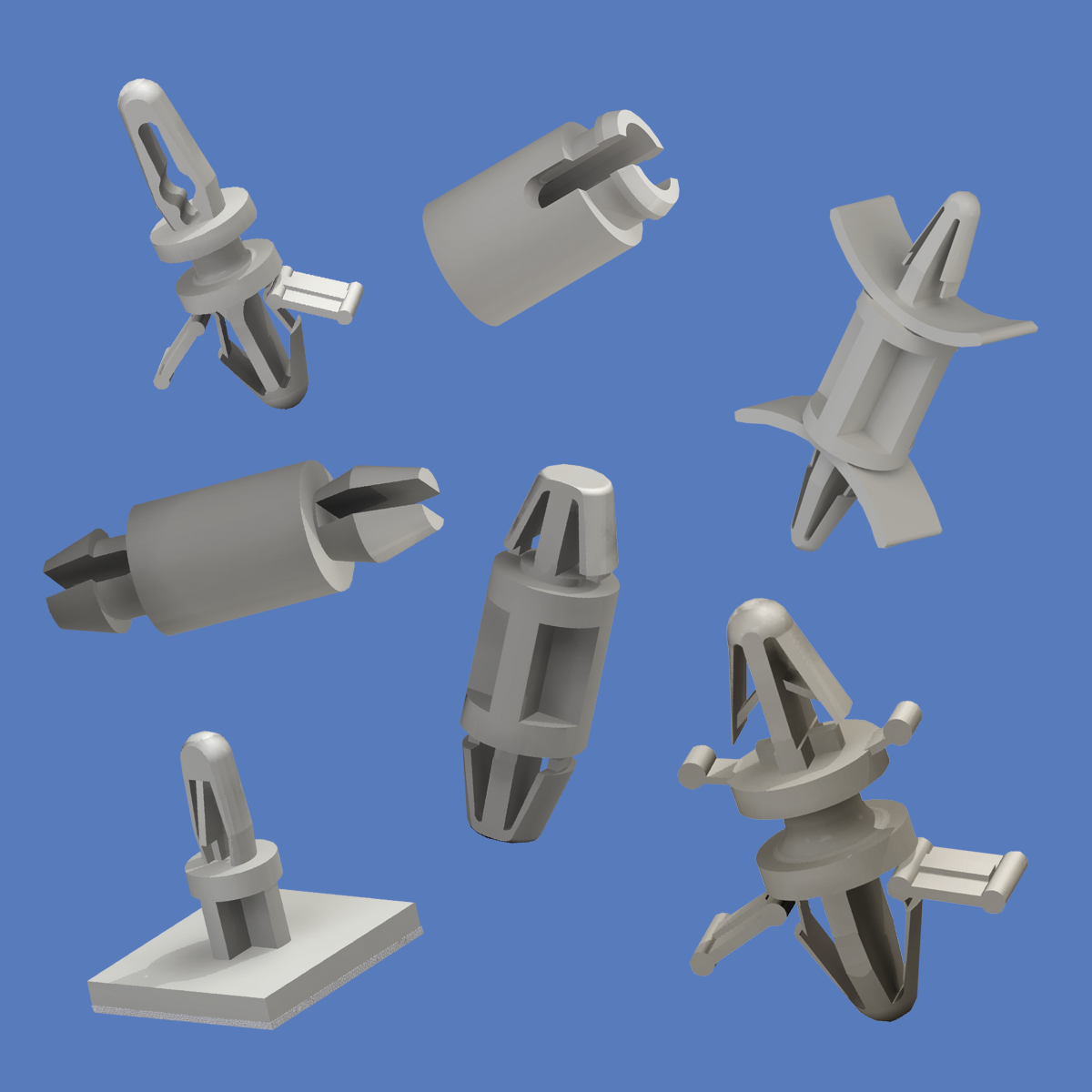

Keystone makes PCB standoffs you may find useful.
http://www.keyelco.com/category.cfm/Spacers-Standoffs/Supports-Spacers-Nylon-PCB/p/495/id/507
I've used these with good results.
threaded nylon circuit board mounting hardware
SlimLine reverese chassis PCB support

Hi
The problem with plastic standoffs is that they won't electrically connect the PCBs to the aluminium chassis.  Making a good electrical connection through metal standoffs will help reduce EMC emissions.
