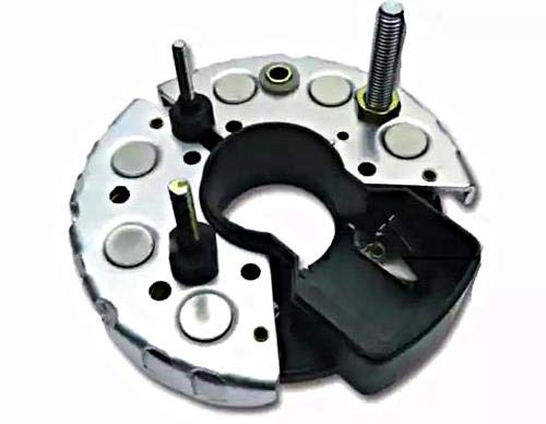

Offline Circlotron
  • Posts: 3362
Re: Do modern car/boat alternators use PFC circuits?
« Reply #36 on: November 18, 2019, 10:47:02 pm »
Just pulled a alternator from a 97 ford apart. Still just three rectifiers.
Are you looking at the three small diodes that feed the rotor with excitation current? There should also be six big diodes on two separate heatsinks.
Something like this:
