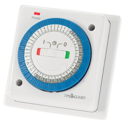

The kind where you have a circular dial that has 96 (4 per hour) pull up or push down switches that slowly rotate past a microswitch every 24 hours.
This old style user interface design is much easier to use than the modern push button interfaces with an LCD display where you have to press multiple buttons to see what programs have been set.
The disadvantage is that they lose sync with real time if they lose power and the clock mechanism wears out after a few years.
Connecting 96 electrical switches to a micro would be an expensive time consuming process. 0.1" jumpers get lost and dip switches are too fiddly for normal sized fingers.
Ideas anyone?

pushbutton dial encoder + good minimal UI on a Memory LCD or poststamp VFD.
UI flow: rotate encoder to highlight current time, instant on/off (default selection), or schedule. Schedule is a pie chart with 24 hours, and is programmed by aiming encoder at x hour, then pressing to select on or off. spinning encoder deploys on (or off) setting to adjacent hours to x. Holding encoder down for .75 seconds exits programming and displays on/off schedule.

That's exactly what I was going to suggest, encoder and a circle of LEDs, you beat me to it. You could charlieplex the LEDs if you want to get fancy and probably get by with a modest microcontroller. DS3231 RTC for timekeeping with a lithium coin cell to hold the time over a power loss.

Actually DIP switches aren't much more fiddly than the operating levers on a mechanical timer.  Use a ring of rocker or side lever actuator 4 way ones.   The problem then becomes displaying and setting the current time effectively.  For that, one could use a tiny 96 step/turn stepper motor, driving a pointer disk with a Grey code absolute encoder pattern on the underside.  Normally the MCU rotates it one step every 15 minutes, but the user can manually turn it to a new time and the MCU uses the encoder to read back its position to know which switch to check.   However its certainly going to be *FAR* more expensive than a plastic mechanical timeswitch! :(

I think I like the idea of a disk directly driven by a 96 step stepper motor driven with a row of little radial sliders round the edge of it and a fixed reflective optosensor at the 12o-clock position to detect if the current slider is in or out.  The U.I  would be *exactly* equivalent to the mechanical timer, and all the electronics has to do is pulse the stepper once every 15 mins and drive the relay from the optosensor output, but its still eliminated nearly all the parts that wear out on the fully mechanical original.
