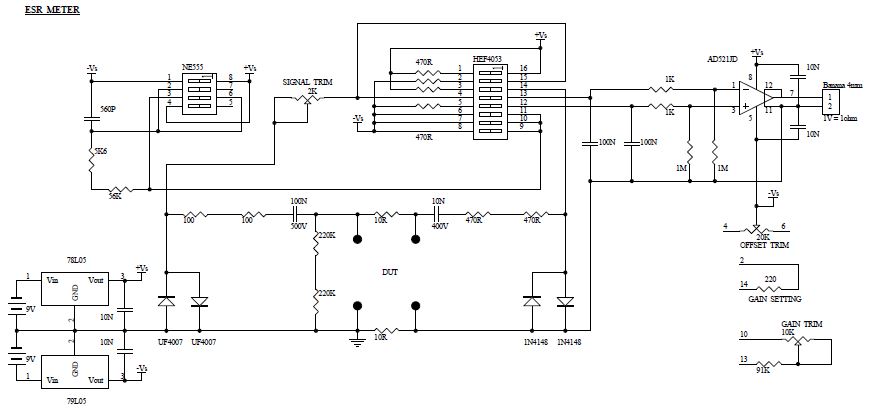

Re: ESR Meter Adapter Design and Construction
« Reply #235 on: March 29, 2020, 06:40:31 pm »
I just found I had a small stash of HEF4053B, so am going to set up a diy adaptor too.  The HEF4053 allows a higher supply voltage from 2x 9V batteries to get say +/- 6V supply, but I may initially just aim for 10kHz and then check if 100kHz performs ok.
I also have a spare AD521 and 524 so will see how a vintage IA goes for trimmable offset and gain (and perhaps use its x10, x100 and x1000 programmed gains and an output level trimpot for different ESR ranges).
« Last Edit: March 29, 2020, 06:45:41 pm by trobbins »
Offline Jay_Diddy_BTopic starter
  • Posts: 2907
« Reply #236 on: March 29, 2020, 07:39:57 pm »
Check this message regarding the selection of the 4053 mux.
https://www.eevblog.com/forum/projects/esr-meter-adapter-design-and-construction/msg341346/#msg341346
Regards,
Jay_Diddy_B

« Reply #238 on: March 30, 2020, 12:53:06 am »
Tim,
If you mean the part of the 4053 that is on the left side of the circuit, it is there to match the delays with the switch on the right side of the circuit.
Regards,
Jay_Diddy_B

Offline trobbins
  • Posts: 908
« Reply #240 on: March 30, 2020, 03:59:47 am »
Soz, I was referring to all the circuitry to the left of the gain stage.  As you have identified, analog switch operation within the same IC package should have close switch time matching, and so aligned synchronous detection.
I just found I also had 2 samples of TS5A22362, which appears to be pretty similar to the 74HC4053, and with only two spdt switches - so likely well suited to this application.
Nearly two decades ago we used a similar scheme to extract the real part of battery impedance by injecting a sine current in to large lead-acids, and used an AD630 for the demod to extract a valid signal out of a lot of noise.  The AD630 isn't a cheap IC, and unfortunately I don't have any lying around.
Tim

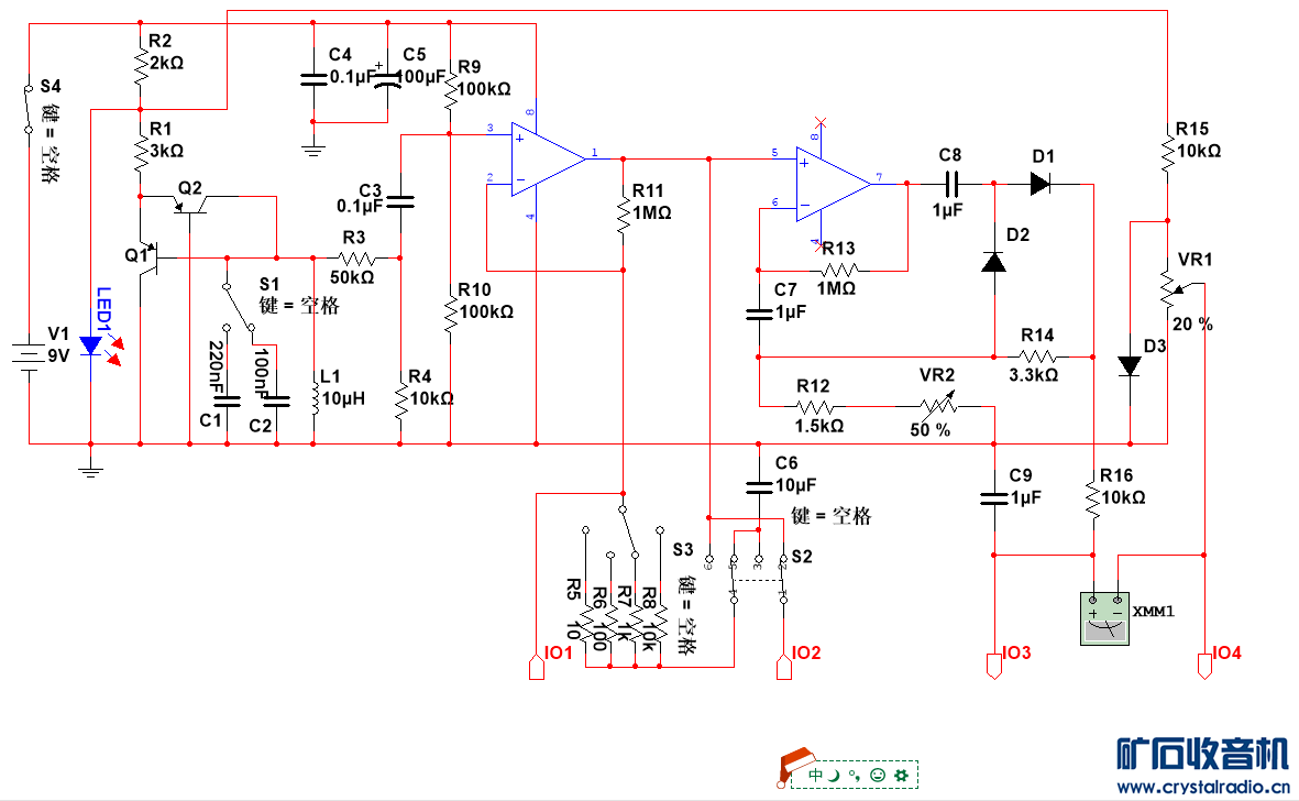

« Reply #245 on: April 01, 2020, 08:27:21 am »
the ESR Meter Adapter Design which come from China,and only use one IC.
it can display the value of resistor,the ESR of cap,and the value of inductance.the  IC  is TDA1308,NE5532 or TL082.TDA1308 can work at 3~5V,NE5532 can work at 5~9V.
http://www.crystalradio.cn/forum.php?mod=viewthread&tid=683954
http://www.crystalradio.cn/forum.php?mod=viewthread&tid=683954&extra=&page=1
« Last Edit: April 01, 2020, 09:09:46 am by X.G. »
  • Posts: 2907
« Reply #246 on: April 03, 2020, 02:14:05 am »
Hi X.G. and the group,
This is an interesting circuit that has been shared by X.G.
I am particularly interested in the oscillator portion of the circuit built around Q1 and Q2. There are some comments in crystalradio forum (Thanks to Google Translate) that talk about this oscillator. The crystalradio forum talks about using different values of resistors in the oscillator.
For the circuit to work the oscillator has to generated a fixed amplitude sinewave at around 100kHz.

I experimented  the style circuit of OSC in my analogue ESR meter  in July 2016.
http://www.crystalradio.cn/forum.php?mod=viewthread&tid=1623736&extra=
my notebook show the simple test  before 3 years:
1.my final selects  are  R1=51 ohms, L1=40uH(6 turns),in the circuit work at 1.0V~1.5V.
2.when R1=22 ohms, the sine shape change,trending  to be a square(THD is higher).
3.when R1=68 ohms,the sine shape is better(THD is lower),the amplitude  reduced ,and the amplitude  reduced much than R1=51 with  lower Vcc.
4.when L1=160uH(12 turns),the wave of OSC  is likely  square.
5.I think that the open-loop gain of OSC=AC resistance of inductor/R1,so I tried to add a resistor less than 100 ohms ,paralleling with L1, for lowering the the open-loop gain,and  the OSC wave shape became better,just like highering R1.
« Last Edit: April 03, 2020, 09:26:00 am by X.G. »

Just starting to gather parts and prepare circuitry sections now for a variant of Jay_Diddy_B's ESR meter.
I have plenty of HEF4053BT, so am going to see how this fairs up to 100kHz, given a higher supply rail of 10V to improve switching speed and on-resistance.
I also have a few vintage instrumentation opamps on pcbs, so will re-purpose an AD521 and hopefully achieve 1V/ohm scaling with zero offset, and maybe allow a 10:1 gain switch for higher ESR levels.
Aiming to see if the spare 4053 switch can operate in parallel for the voltage signal switch, to minimise the switch resistance a bit more (and hopefully not experience any switching glitches).
As this will be more of a bench speciality module, I don't mind using two 9V batteries and each 5V reg will compensate for its own battery and not need any loading for mid-point management.
I have a batch of 47milliohm 1% SMD, and 1 ohm 1% leaded, to make up a set of calibration resistors (which is timely, as my next activity it to restore a Pontavi Th2 milliohmeter).
