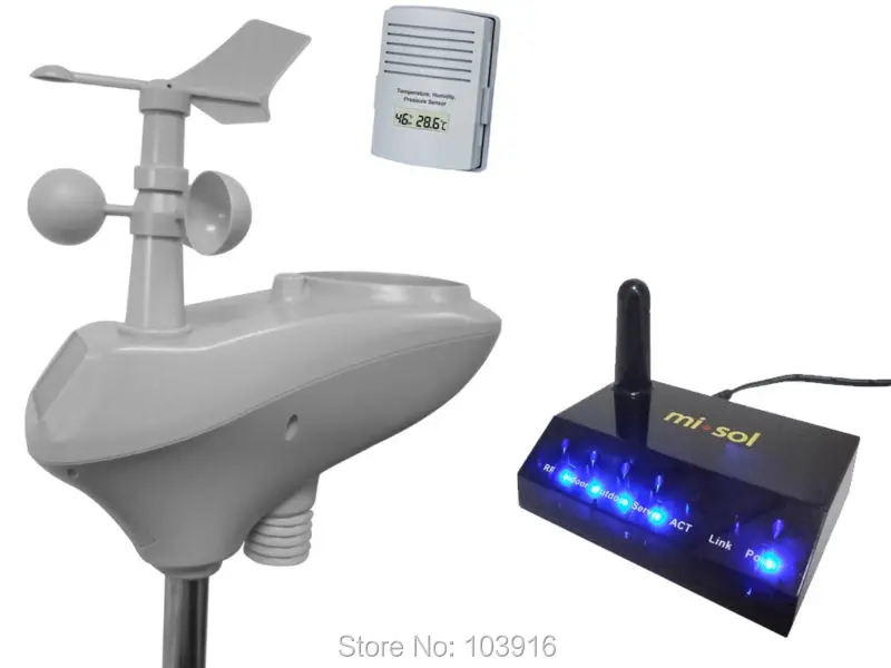

Offline ebclr
  • Posts: 2331
KISS.... :popcorn:
Offline ebclr
  • Posts: 2331
If you really insist on that z80 obsolet thing
This may help
https://sourceforge.net/projects/z80-pascal/
And for the more educational ideal
https://opencores.org/project,a-z80
« Last Edit: April 02, 2017, 02:15:19 pm by ebclr »
Offline BendbaTopic starter
  • Posts: 216
Hi ebclr,
Thank you very much for the information. Those ESP modules are certainly awesome, I actually do have a couple of similar modules to play with. Though, calling a Z80 project nonsense is a wee bit offensive.
That weather station from aliexpress would certainly be cheaper and up faster but would take away all the fun for me.
The Z80 on an FPGA sounds like a really good project, I'll definitely read more about that one.
I know I'm stubborn but I like retro techs I want to learn more about and master it before concentrating on newer techs.
Stop dreaming your life, start leaving your dreams.
