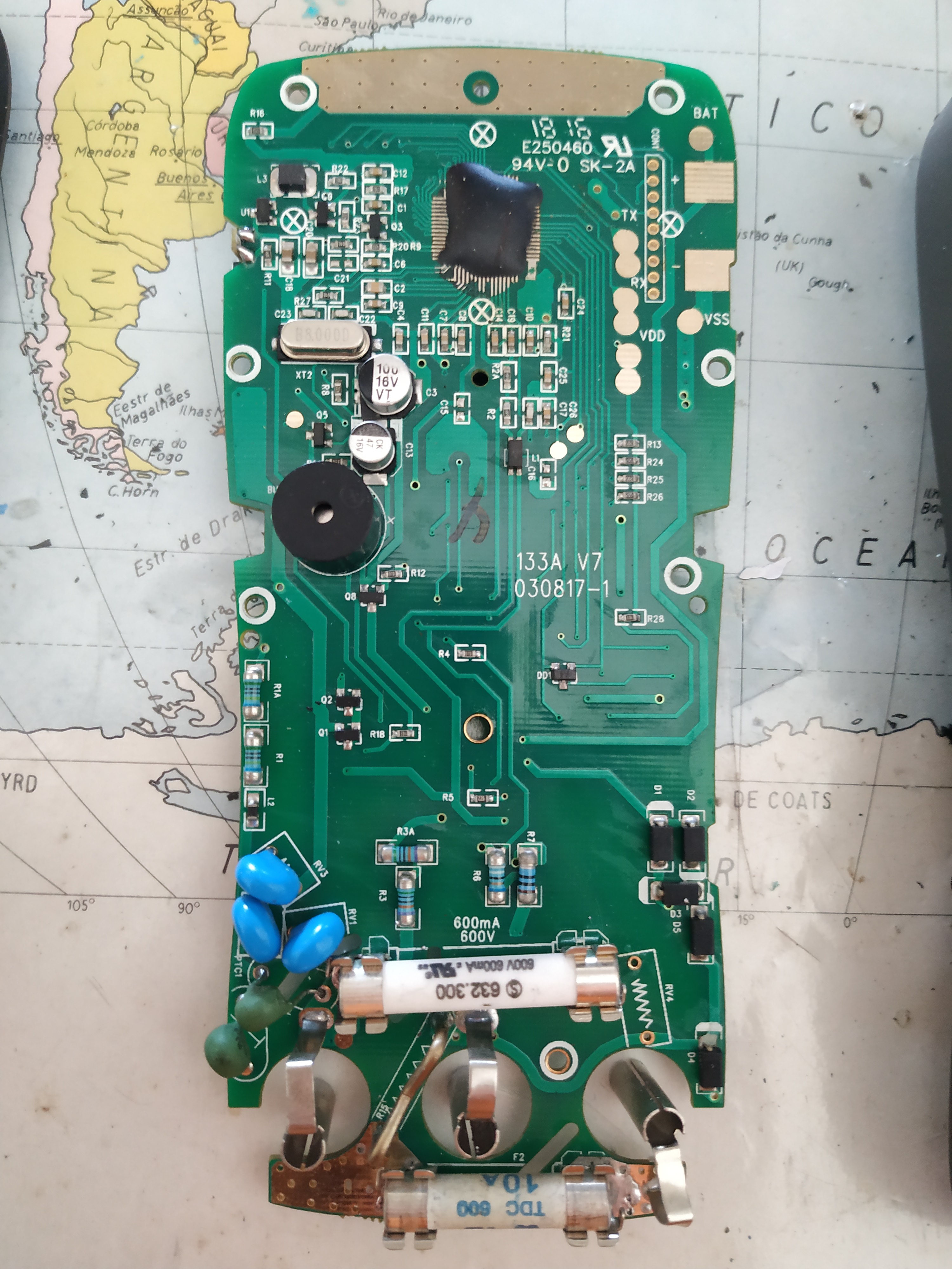

After seeing some multimeter teardown videos from Dave Jones, I was worried about what he shown from the cheap Uni-T multimeters, especially about thei input  protection. So... since I use one (Uni-t UT133A), I opened mine to see whats inside, and must confess I was happy to see what I've saw. check the pictures!
Ceramic fuses, PTC and varistors...
Very nice layout..

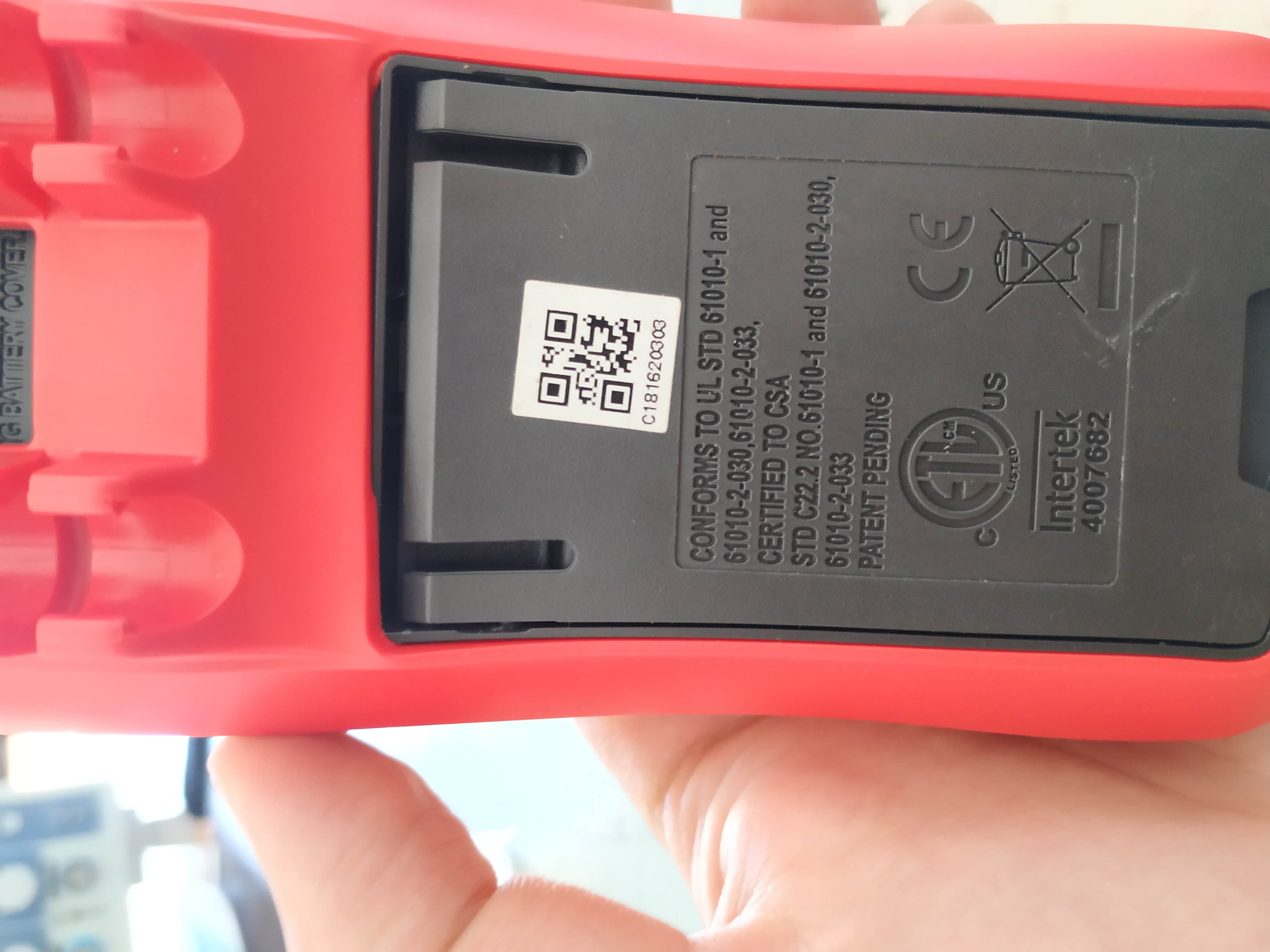

UL certified!
So.. all was good!  :-+

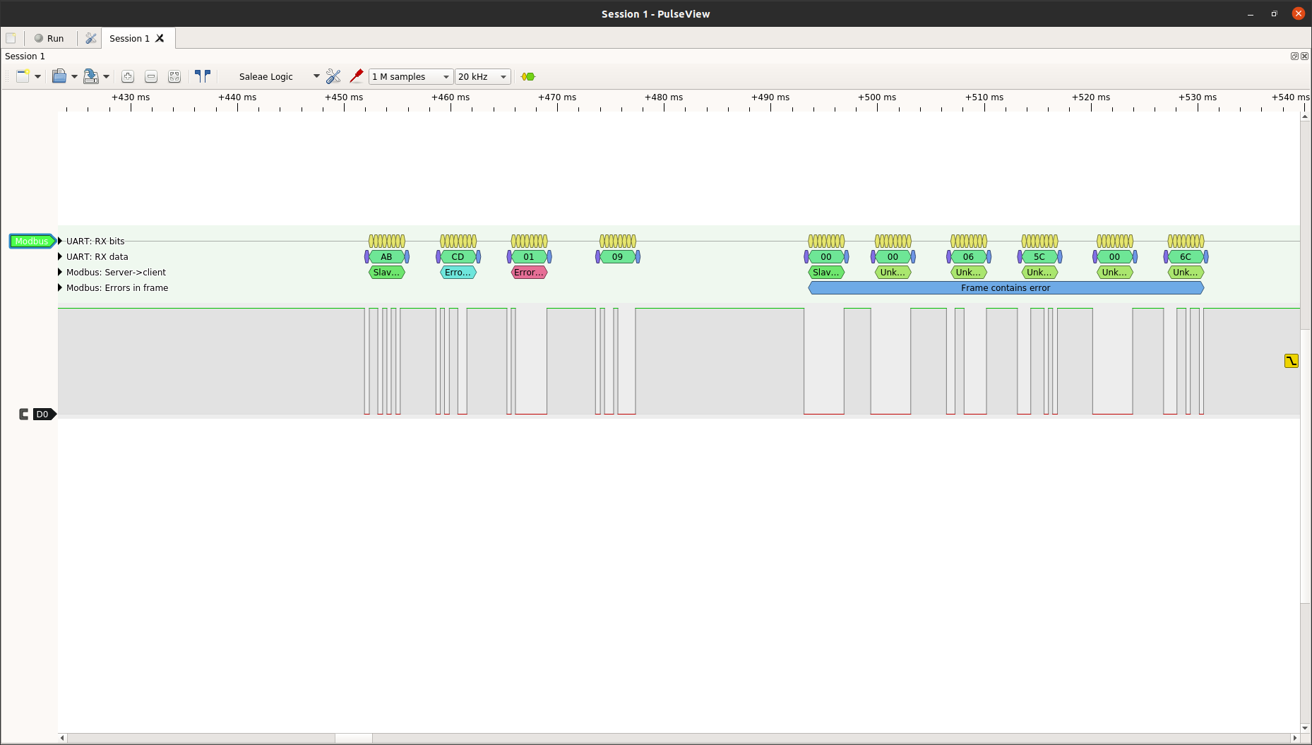

Next, I decided to see if the blob controller was outputting anything on the Tx Rx pads...
and connected the oscilloscope to it and.. it was output something! Nice!  :-+
Finally connected connected Tx to my logic analyzer and started to try figure it out.
After a few minutes, and google search to see any uni-t multimeter serial protocols, figured it was rs232, LSB first 8N1, 2400 Baud.. Then created a .ods file in libreoffice calc and wrote some of the outputs..
So all it is needed to use the multimeter as a datalogger is to test the Tx line, plug it into a micro and create a GUI.
Which could be easily done with a stm32f103, and create a GUI with QtPy...
Will it be worth it?  :-//
Tell me what you think!
I leave attached the .ods file with what i've done so far.

Offline uer166
  • Posts: 1026
It is not UL certified, it "conforms to a UL standard", but UL have never seen this meter.
Offline 2N3055
  • Posts: 7466
  • Country: hr
ETL listing is equivalent to UL listing, and Intertek is reputable company.
