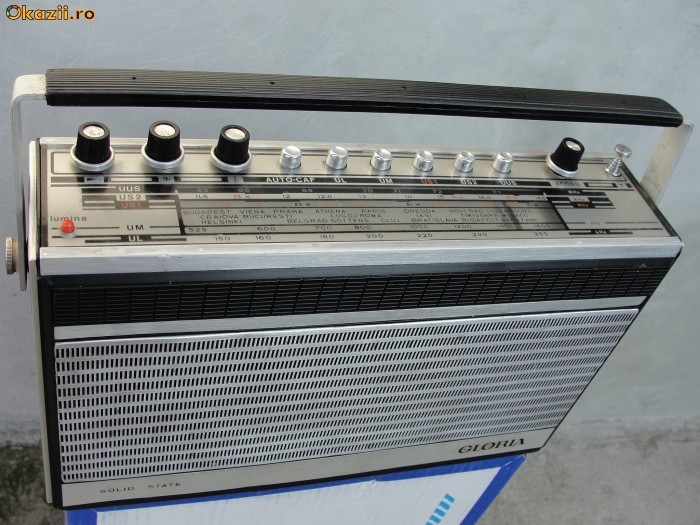

« Reply #14 on: December 22, 2024, 03:11:53 pm »
Romania has the lowest frequency radio station for music too, roughly double the frequency.
    Radio Antena Satelor
I tried to find it on some world SDR and its pretty hit or miss in European ones. I wondered if its possible to pick it up overseas. I think the problem with tuning is pretty similar to this DCF signal. 200 KW transmitter.
Also, messing with a clock at work that picks up a LW broadcast by using your phone is a interesting idea.
Wonder if you can improve the front end of that cheap module by connecting it to the front end of a modified old radio parts capable of LW reception.
Getting a atomic clock out of one of those might be the best use anyone has found for it.
« Last Edit: December 22, 2024, 03:25:19 pm by coppercone2 »

« Reply #15 on: December 22, 2024, 03:44:35 pm »
Didn't know about such record, but there is indeed an AM radio broadcasting band in Europe (longwave, roughly between 150kHz-300kHz https://en.wikipedia.org/wiki/Longwave ), the lowest band for broadcasting here.  Probably nobody still make receivers for that band nowadays, but old analog AM radios used to have that band.  See for example the numbers painted on the scale of this Romanian receiver "Gloria" (probably from the 70's or so), https://images.okr.ro/auctions.v3/2000_2000/2011/11/30/e/f/674878966433803049741704-3341152-2000_2000.jpg first number is 150kHz, last is 255kHz.

Re: How can I receive the DCF77 time signal?
« Reply #16 on: December 22, 2024, 03:48:01 pm »
it might not be hard to modify it to a lower frequency, its not too far off. I think the ferrites or whatever should be compatible
I think if it can do 150 it can do 70
a simple tecsun can pick up longwave, they are common
I think it will offer better selectivity then that  cheap board
« Last Edit: December 22, 2024, 03:49:38 pm by coppercone2 »
« Reply #17 on: December 22, 2024, 04:02:18 pm »
That could be an option, too.  I remember seeing something like that on a ham website, not sure if it was for DCF77 or for VLF https://en.wikipedia.org/wiki/Very_low_frequency (which is even lower than DCF77, VLF goes down to audio frequency, but with radiowaves  ;D).

And the unique attraction now to LW is the fact that you can use simulated inductors or possibly capacitance multiplier circuits that lets you go to new places for "RF design" without a semiconductor MMIC lab
That is, a active inductor, or possibly something like making a giant capacitor from a small stable one, with amplifiers. (I often wondered if something like a small stable C0G ceramic can be 'multiplied' to some useful value, but putting work on the inductor is the rational choice.)
https://www.aavso.org/improved-gyrator-tuned-vlf-receiver
However, I suspect that just getting a regular ferrite tank circuit working will be more then rewarding
and that it works for a sound card, unfortunately the DCF77 is too high frequency for this  :'(
I am still rofling at the idea of some communist radio spitting out a german atomic clock signal
