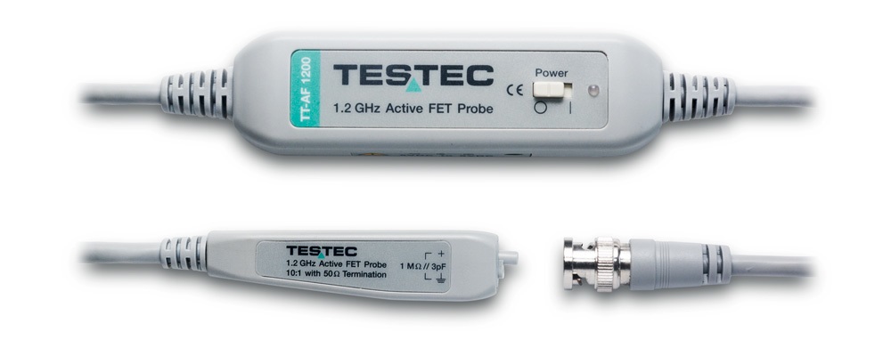

Do you need differential measurements? If not Testec may have something for you...
The following users thanked this post: k8943

Ashamed to say not sure what the frequency of the Rx response is going to be from an NFC card. The requirement for an active probe was given on p45 of following app note https://www.nxp.com/docs/en/application-note/AN11706.pdf where they are talking about optimising the passives in the schematic on page 22 - but all the scope shots are too small to read the time scale!
Seems the Testec TT-AF-1200 - can be had for about 700 money units.
The Tek P6243 + 1103 power supply for about 300.

To further on that notion: if you are anywhere near the Limburg area, you could pick up my Testec probe for a few days.
