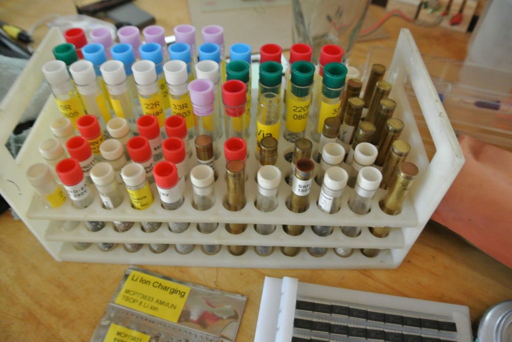

Here are some pics of how I use SMD parts.
Test tube rack of passives:
http://i18.photobucket.com/albums/b103/klee27x/DSC_3067_zpsjv3vu137.jpg

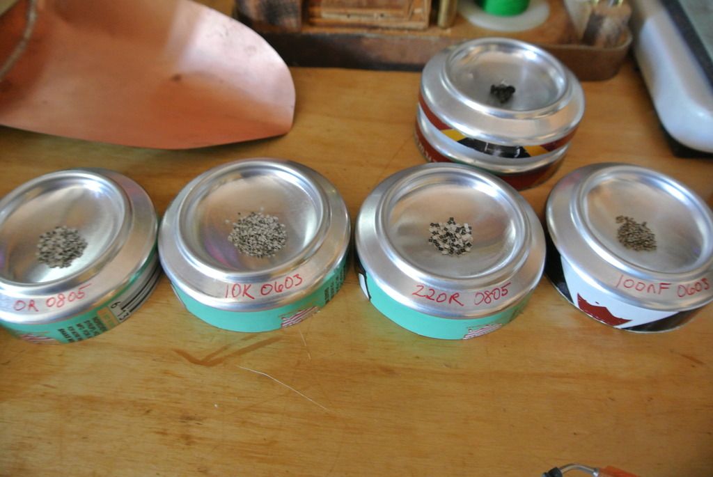

This is how I might arrange passive parts while populating a board. In the top left, you can see what I call my "dry funnel" which I use to put components back into the test tubes when I'm done with them, among other things. I've had one of these funnels for as long as I've been using SMD parts. The dish is easy to examine for hair or lint or other contamination before returning parts to the source. The aluminum is easy to label with a permanent marker, and it wipes off with alcohol. Even 0402 are cake to get back into the tube with only a bit of tapping.
http://i18.photobucket.com/albums/b103/klee27x/DSC_3065_zpsuypftgpw.jpg

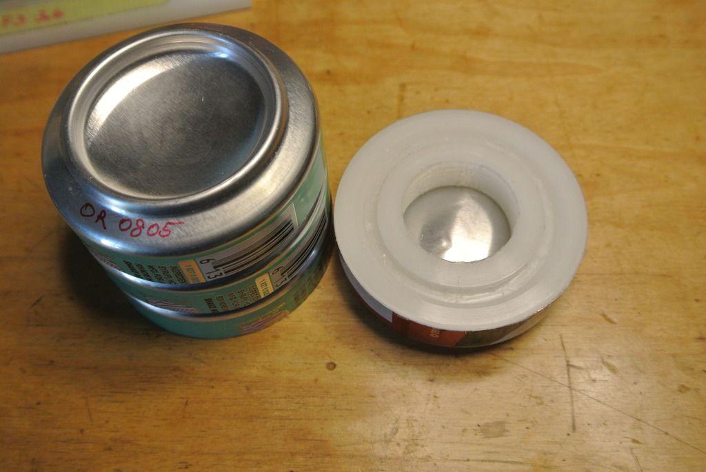

... Or I can stack the pucks and set them aside to continue the project, later. The HDPE base adds weight, stability, and it glides over a bench top. The machined groove allows them to positively stack. The hole allows a place to tap the bottom of the dish with a fingernail for tiny components that might want to cling:
http://i18.photobucket.com/albums/b103/klee27x/DSC_3068_zpse1ohgsie.jpg
The pucks are sort of like the "muffin tin" idea to hold components, except sized for tiny SMD parts. And very importantly, you can pour out the contents of a single dish, lol.

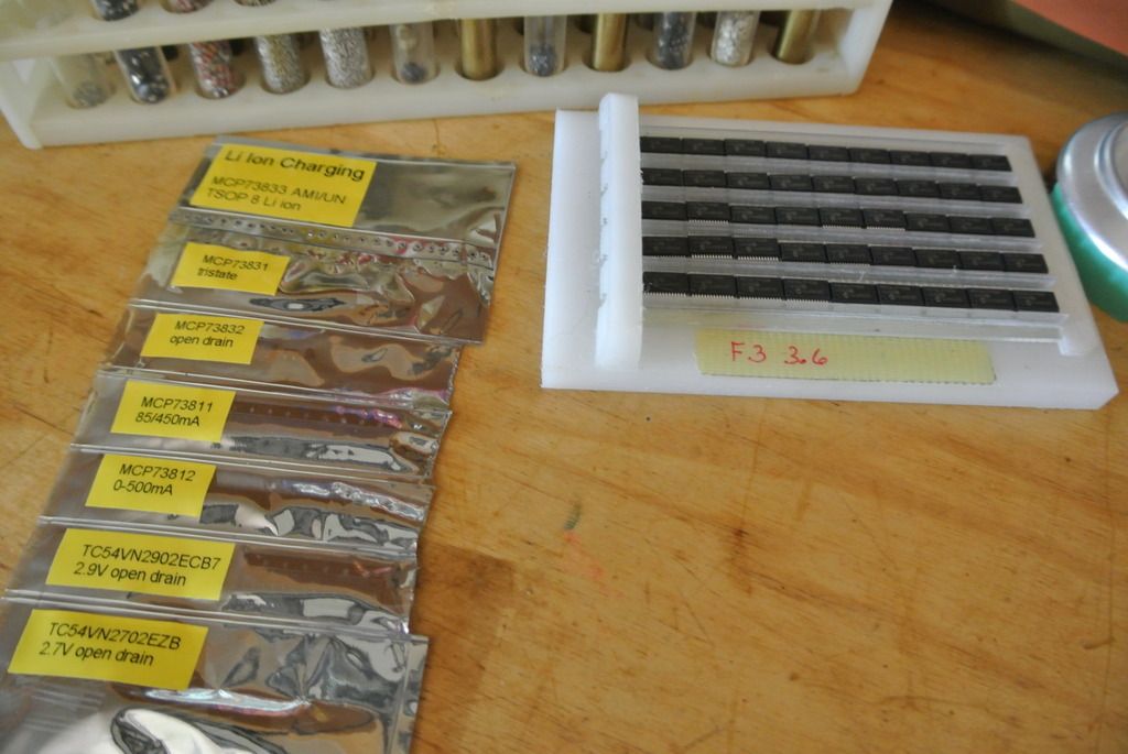

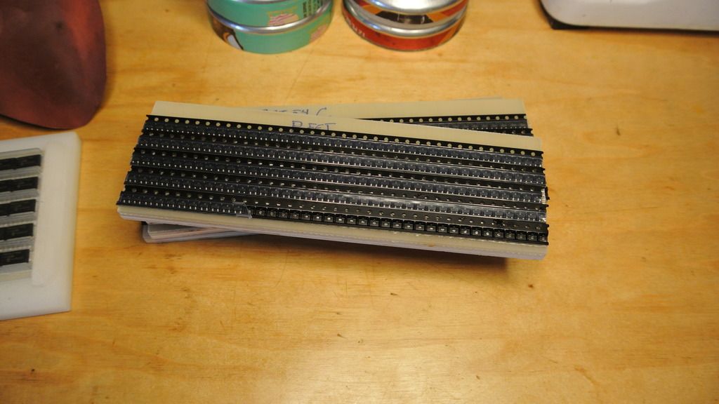

For small directional components:
http://i18.photobucket.com/albums/b103/klee27x/DSC_3071_zpsorzdqhtb.jpg
For specific parts I am only prototyping with on a blue moon, I don't mind digging them out, one at a time. I might heat seal them for very compact storage. I will cut open the end, take out the components, then close up the end with my soldering iron. (I also have my IC tray loaded; which I'm actually using right now; the rest is just staged for the photo, lol):
http://i18.photobucket.com/albums/b103/klee27x/DSC_3066_zpsmhahqxmq.jpg
I like your "pucks", neat idea - especially that they're stackable. I use one of those paint mixing trays for watercolours:

BTW, an easier way to make the pucks is to just fill the bottom of a coke can with paraffin (or perhaps casting resin?). And then place another (greased) can over it while it sets, to make it stack. Then trim and file the edges of the can. I made some like that and it works fine. But I liked them so much, I went the extra mile with the HDPE.
