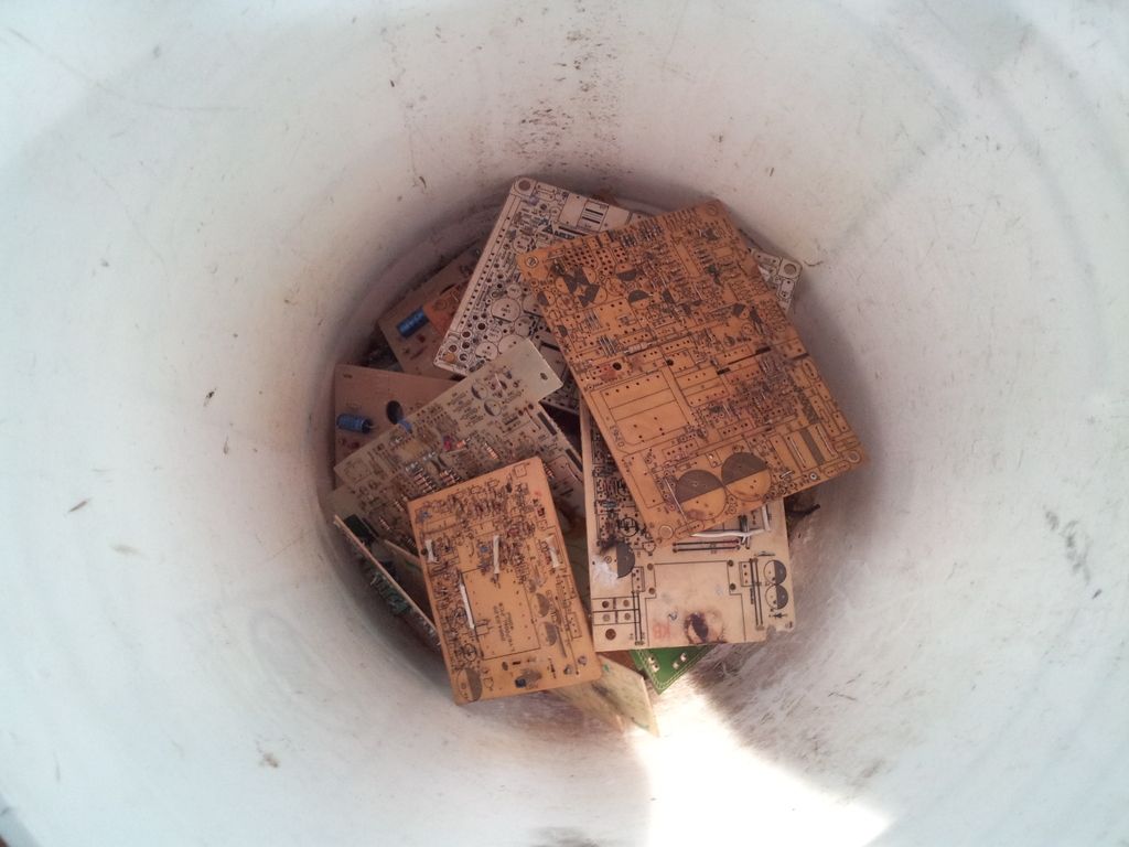

Anyone ever gave it a try?
I did. It's terrific!  ;D

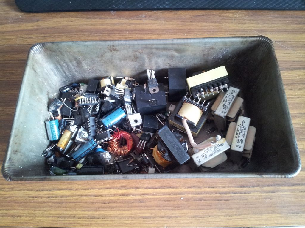

As I don't have an actual solder bath heater, I filled a steel cup I removed from an old loudspeaker with scrap solder that I accumulated since the beginning (then topped off with a roll of plumber tin), and put the whole thing on a standard hot plate, with a metal plate inbetween.
I went through a certain learning curve (dealing with the radiated heat, order of components removal, dipping times and cooling periods inbetween, etc.), but now I can strip a computer power supply of most of its components under 30 minutes! I do pull a few resistors and diodes if the leads on the solder side are straight, making them easy and fast to grab with tweezers one after the other, but I don't waste too much time on E12 resistors and 1N4148s LOL.
Here's what I've got in roughly 5 hours of work:

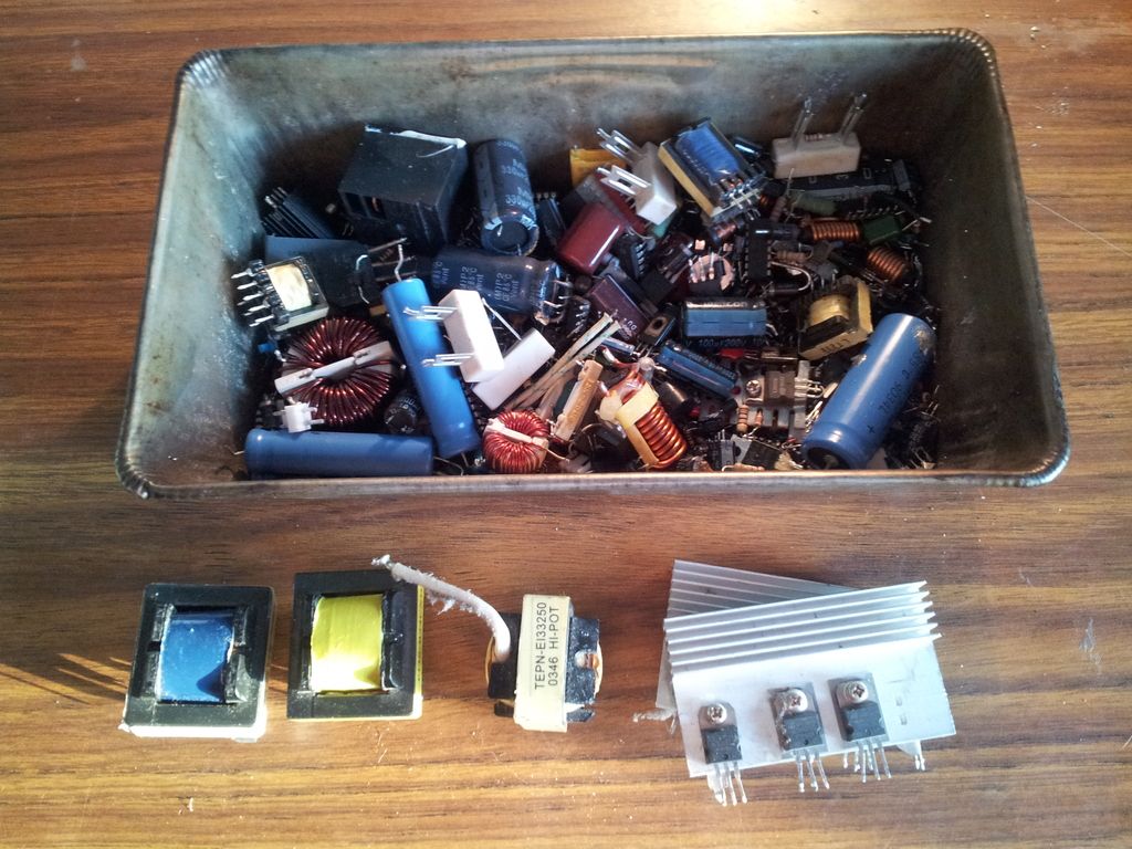

It may not look like much, but keep in mind that the metal pan in both pictures is filled with very small parts tightly piled together!  ;D
The resulting stripped boards:
And that's just the beginning. I have well over a hundred pounds of circuit boards to process. That's an enormous potential supply of very cheap parts. Of course I wouldn't use them for HiRel projects. In such case I'd order new parts. But for the rest, I'm almost worse than Uncle Scrooge, so these are all parts I don't have to buy!

Sure, give it a try too! It's pretty much the only way to go for a large volume of (through-hole) components. Hot air would be my second option, especially for SMD parts. Many of my circuit boards have some, so I'll need an hot air station to remove those parts before taking the boards to the solder bath.
As for the amount of tin, I'll save you some time (and tries): make sure you've got enough of it! I'd melt at least a pound to be sure. Otherwise the thermal mass is too low and the tin drops too much in temperature when the board is dipped in it. The tin will stick to the board instead of melting all the solder joints at once.
