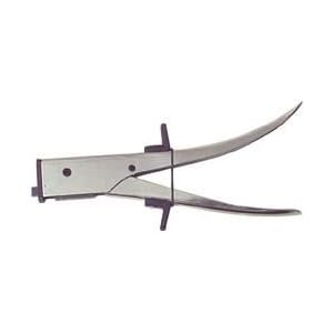

I find a versatile tool for modifying sheet metal or plastic enclosures is a nibbler; its not the fastest but it will always work and get the job done.  What nice about it is you can custom make a hole in most any container.  You can make a pilot hole with a hand drill and take it from there.  If you have many uses for a dremel type tool, that would be better.

Nibbler?

Nibbler?
Yea, a nibbler....
It makes small cuts, or nibbles, in sheet metal or other materials. Its handy, but it can be slow
Ive tried them, but i prefer the rotary tool method myself. You can find an extraordinary amount of accessories for a good rotary tool. For cutting plastics i have a miniature saw blade that makes a very quick a clean cut into plastic, for harder materials i use small diamond discs that make a very clean cut, and there is always the general purpose fiberglass reinforces cut-off wheels

Yep, I second the Nibbler, at least that's what they are called in Australia. Had one for maybe 25 years.
The easiest and quickest way to cut irregular holes in a case IMO.
Not ideal if the edges will be visible in a front panel, as it's hard to get them perfect.
Dave.
Same here, but for 35 years  ;D  It has never failed me while a Dremel has, usually because the cutting tool needed replacement and I didn't buy a new one when I needed it.
Also, per the title, for modifying holes, a nibbler is just right. A power tool tends to cut a bit too fast and much too, whereas with a nibbler you can go slow and sure.
For edge issues, I cut holes slightly smaller than needed, then file the edges.  Should have also added a file as a good companion tool with the nibbler.
