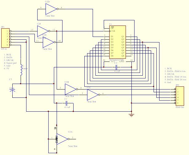

Very similar to I2S is EIAJ ( a Japanese audio transmission format). here is the basic diff. between the two:
I'm trying to create the simplest (fewest parts count) ckt for I2S to EIAJ conversion.
To convert between two formats involves some glue-logic manipulation. But this can get a bit messy.
I know that the following ckt works as I have built/tested it:
The following "simple" I2S to EIAJ converter supposedly also works but I can't seem to do so (It may be flawed as the designer never tested it):
And finally, the following I2S to EIAJ, using 3x74HC174  flip-flops and a single 74HC125 buffer (optional), is supposed to work, but I can't seem to do get it to do so ...
For the ckt above (and neglecting the optional 74HC125 buffer chip on the far right), all that is supposedly needed are those three 74HC174 F-Fs.

PROBLEM:
On the 'scope, I'm seeing the DATA (signal) reduce in amplitude by about 1/2 as it goes from Q to D (from one logic section within the chip to the next). Not sure why this is happening. By the time the signal makes its out of the FIRST chip, it's almost dead.
I must be doing something wrong because this ckt is supposed to work -- it is sold as a kit PCB (shown). Unfortunately, a schematic is not avail.

Offline 13hm13Topic starter
  • Posts: 305
Re: I2S to EIAJ glue-logic digital-audio converter -- help needed!
« Reply #8 on: January 07, 2014, 11:41:00 am »
Solved the main problem: bloody solder bridge (connecting pins 11 + 12). That's what one gets for using cheap Veroboard!

If you look at the Universal Shifter (shown in OP)...
... you'll may note that two of the three lines that go to the D/A (aka DAC) don't go thu the shifter at all (i.e, BCK and WS); so, only DATA is "shifted". This shifter is based on six 74HC164 shift-register ICs, and two more 74-series logic chips. I'm not sure why there are so many needed, but (as noted in OP) this whole messy topology work!
The Black Crow (also shown in OP) is claimed to work for same shift application, but somehow using only three 74HC174 F-F's (the incorporated 74HC125, on far right-hand side, is only a buffer, and not really needed).
Black Crow shown here again:
This works but with very distorted audio ... and I can't quite figure out why.
Aargg!!!
Again, BCK and WS are not shifted ... only DATA line goes thru converter.
