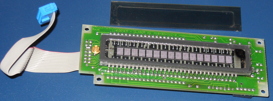

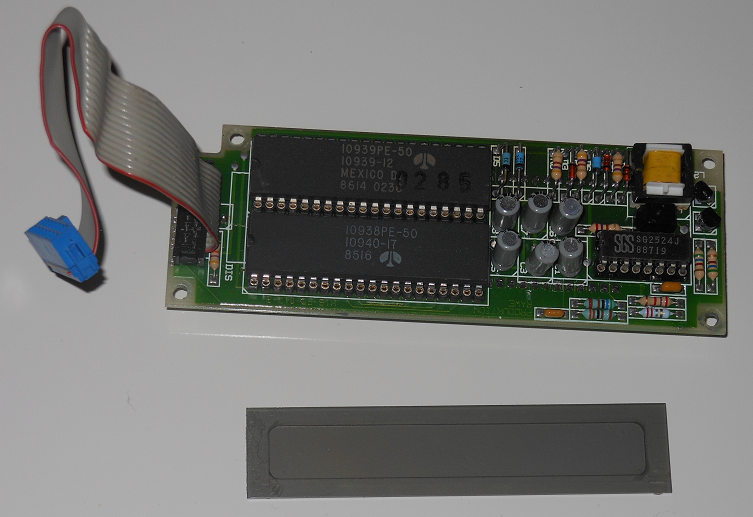

Note some VFDs need AC filament voltage... I am not sure what happens if they are fed DC but it could be bad.
This display appears to be used as part of a display module, i have only seen 2 pictures of it online (here http://www.utasker.com/Shop/VFD2.png and here http://www.utasker.com/Shop/VFD1.png ) but it appears the module runs off DC and no obvious conversions unless there doing somthing funky with the transformer
to be safe i have the unit hooked up to my power supplys displaying a few dots and ill leave it running for a day or two but in my experience using DC in VFTs filaments do not cause damage, they simply cannot be driven as high
