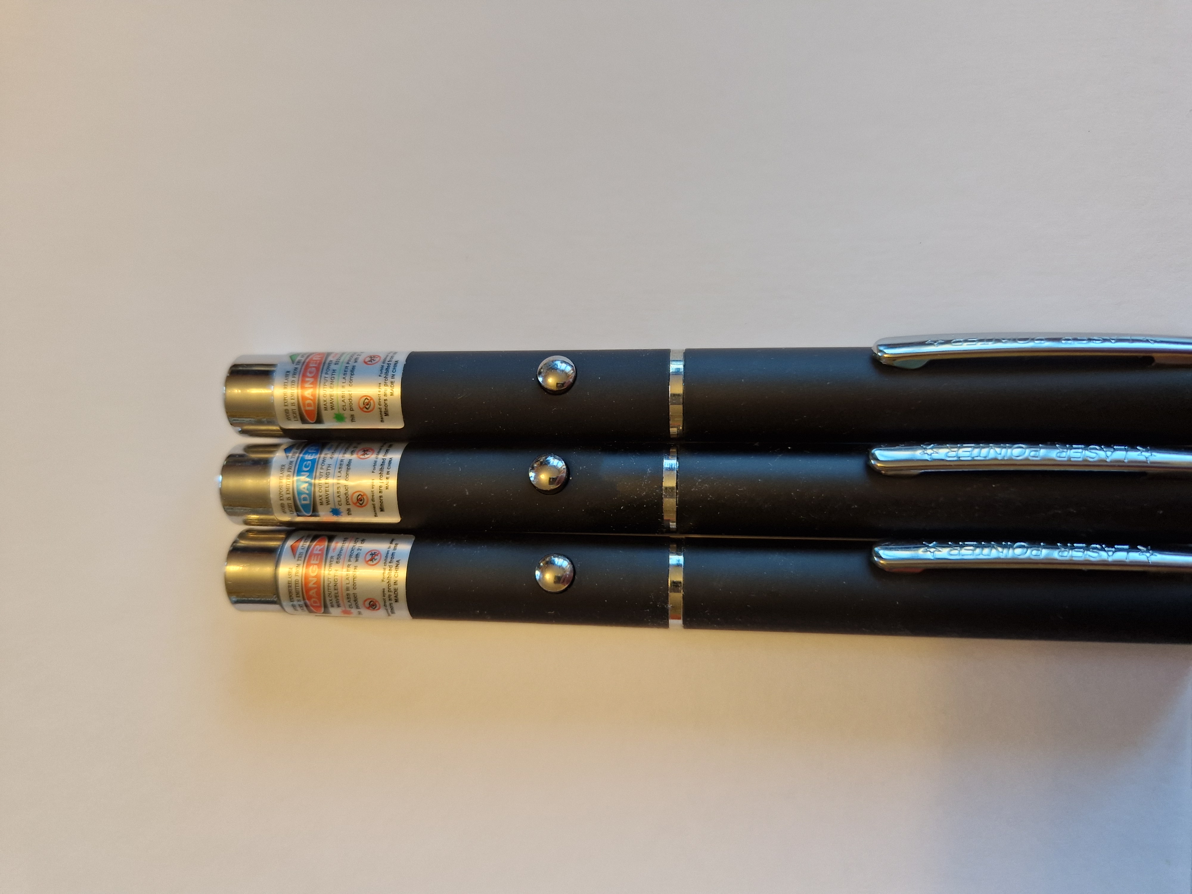

A while back, I decided to look at whether laser pointers available on eBay were really as dangerous as people say.
My first purchases were laser safety glasses. As I bought them from Amazon (hardly any more reliable than eBay), I tested them with a wide spectrum light source and a photospectrometer to confirm that they did actually block the advertised wavelengths. I also purchased a basic laser power meter.
These are the three laser pointers which I ordered from eBay. They were very cheap. Each colour (red, green, violet) has a sticker advertising the maximum power output as < 5mW.
However, as my power meter soon confirmed, these three laser pointers are far from safe.
The red one measured 9mW - close to 5mW but still strong enough to cause trouble.
The green one measured 27mW - ouch!
The violet one (which looks to our eyes like the most dim of the three) measured 44mW!!
Where I live, the maximum power allowed for any laser pointer is just 1mW and these are actually illegal to even own.
I've looked at the various laser engravers, etc that can be sourced from China and in every case, I decided that my eyesight was worth considerably more than the benefit I might obtain from these devices. Even if the OP manages to make something which would provide any benefit for electronics assembly over and above that provided by a more conventional heat source, I won't be buying one!
