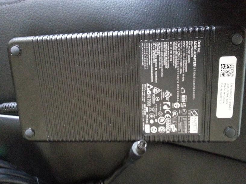

As you likely well know notebooks tend to use custom power plugs or a range designed to handle different loads. There are of course margins to exploit in these connectors so long as higher quality are used and this lead me to create a modded 330W dell brick for my MSI, it has a very similar output voltage (19.5V vs 19V) and is capable of supplying almost twice the stock 180W brick :)
Our vic... *cough* I mean brick of choice today is the big daddy at the bottom of the pile.
Manufactured by delta for use with the M18X this bad boy packs 330W at 19.5V.
Flipping it over you will see 4 removable feet covering the screws.

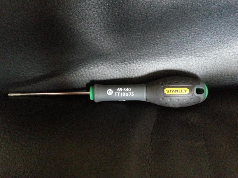

It uses torx anti tamper screws so you need one of these:
T10 security torx screwdriver (hollow 6 point star).

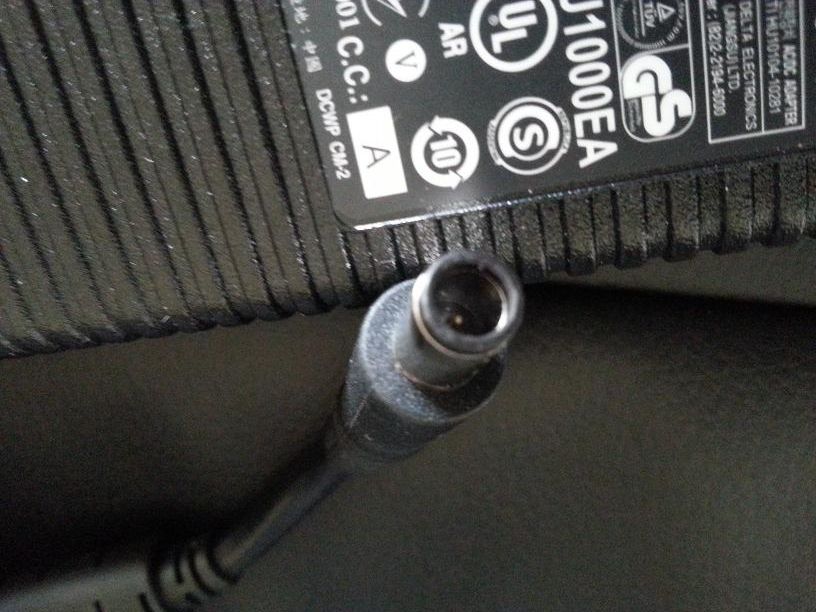

Let's plug it in and test the voltage shall we? NO WAIT A SECOND ACTUALLY.
DO NOT SHORT THE CENTRE PIN WITH THE INSIDE OF THE BARREL
It will kill the brick. So measure it but be careful!

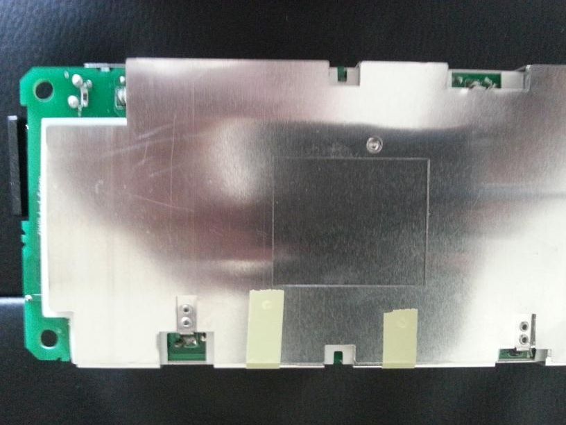

Now let's take that cover off after removing the 4 screws:
You have two choices, unsolder the 4 tabs holding the shield in place, gently pry off the glue holding it all on or....
cheat:

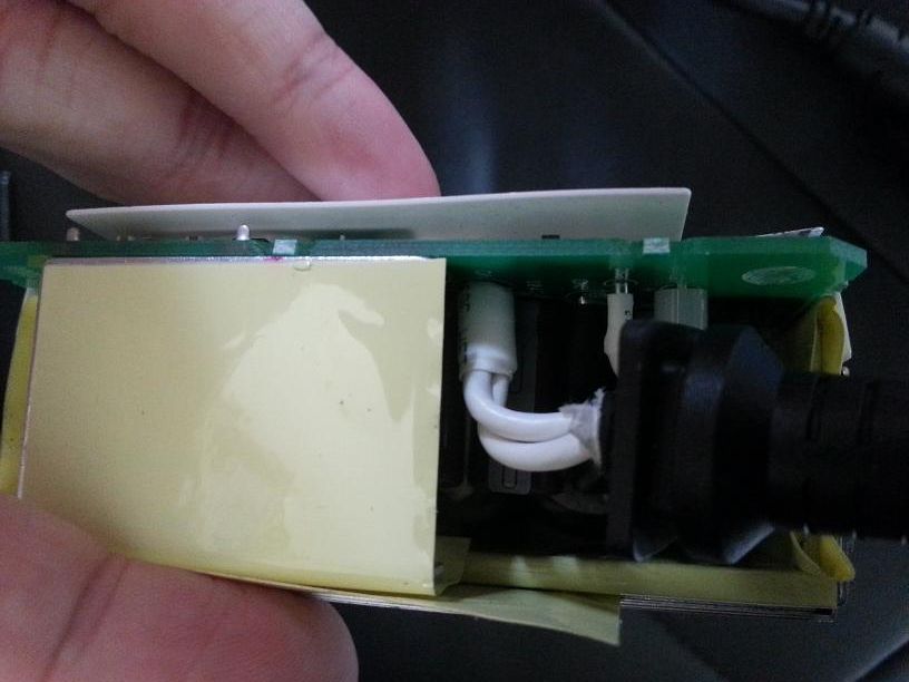

Nice chunky leads for obvious reasons:

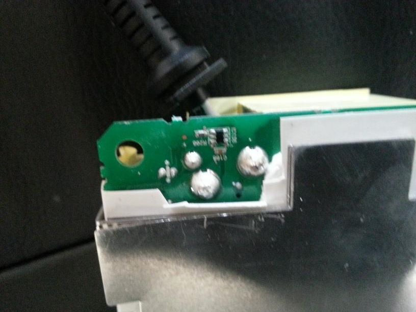

So you are going to have to unsolder each of the 3 connectors, ground (outside of the barrel) is next to the small data pin connector. Solder in your harvested cable from another brick into the holes.
Pop the case back on and measure the no load voltage (should be around 19.5V)

If you do this to use with a Dell, remember to transplant the 1-wire bus ID chip as well (easily found - it connects between the 3rd wire and 0V on the lead). On mine it was a TO92 style device. On my Inspiron the BIOS  throttled the CPU speed and prevented battery charging until I re-fitted the ID chip.

The ID chip tells the laptop how much current it is allowed to pull. You also don't want the laptop trying to pull 130W off of a cord that wasn't designed for it.
The technology must not be too proprietary because I've not found a third party cord that listed it was Dell compatible that didn't work with a Dell when the appropriate power rating was matched.
