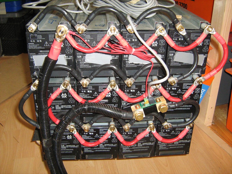

I am miles away from taking my workshop completely off grid, but you have to start somewhere and take small steps with some things.
A few weeks ago I did a teardown of my newly acquired inverter / charger. Since then I got to work on preparing the battery to make it go.

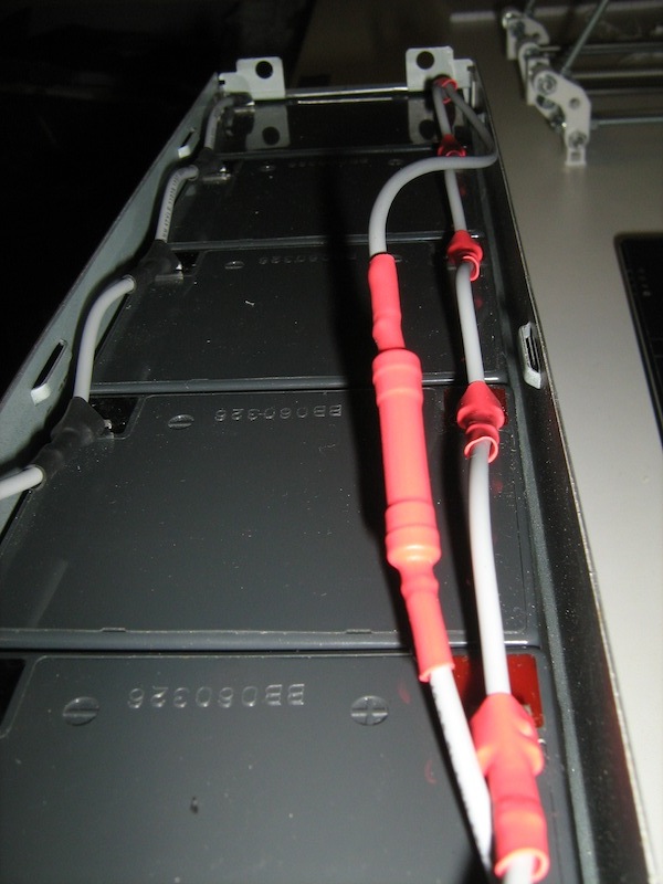

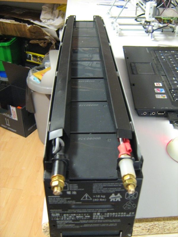

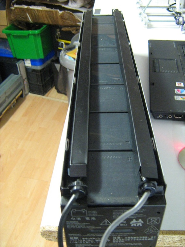

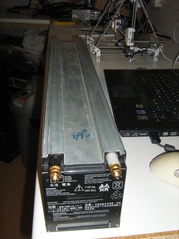

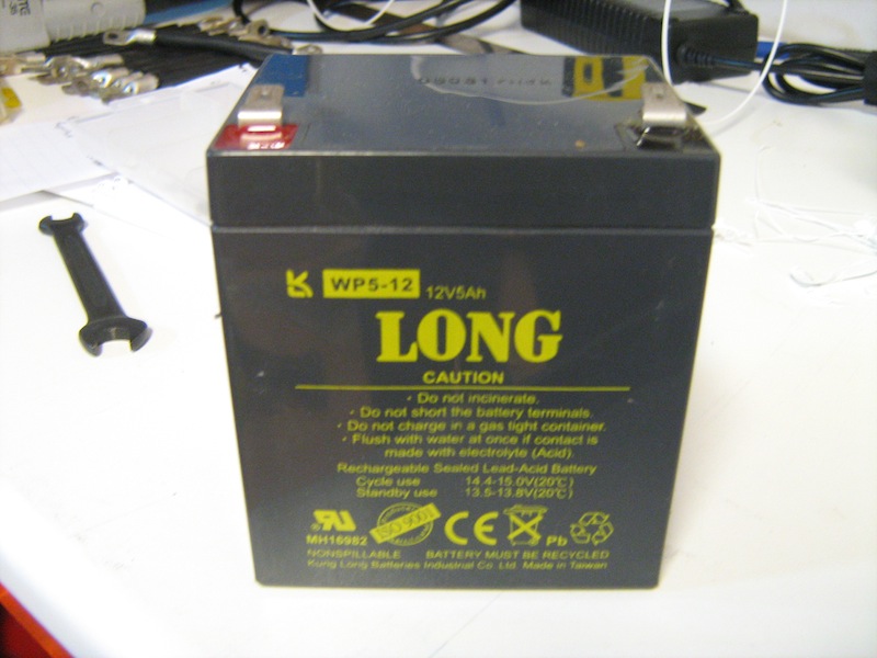

Several years ago I discovered an old APC 7.5KVA UPS in the dustbin. It was too unwieldy to transport besides it smelled of burning MOSFET, but it's batteries were modular and easier to transport. I have kept the batteries maintained, waiting for the opportunity to find a good inverter cheap, that's when I found the Victron out of an old ambulance.
The APC had four battery trays in it each tray comprised of eight 12V batteries wired in series for 96V. Two of these trays were then wired in series for 192V system voltage for the inverter. My guess is that at 7.5KVA, a 192V system voltage reduces the current to a more manageable 60A. The APC that I found had another battery pack alongside it which contained another eight trays in a similar configuration.
So, I have a total of twelve 96V battery trays.

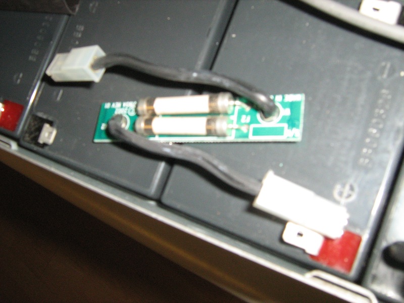

Here is one of the trays showing the original wiring.
APC went for two 30A fuses in parallel to protect each tray. I made use of one these fuses per tray in my configuration.

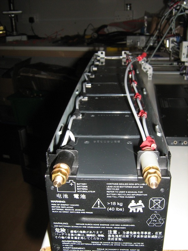

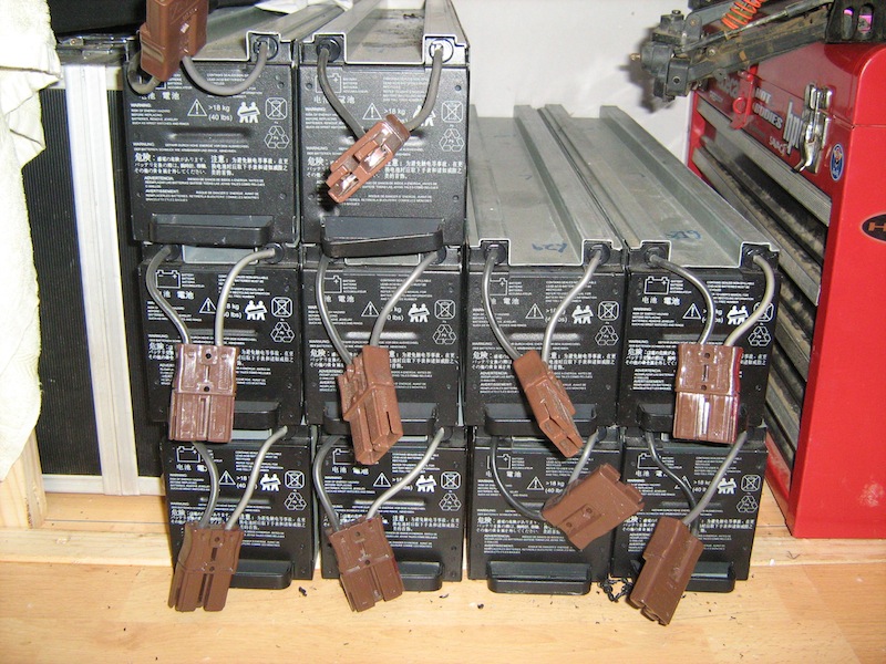

Most of the batteries in the trays still read above 12.5V despite having a top off charge about two years ago. I'm just not so sure of the brand of batteries used. I guess if APC were happy, then they can't be that bad.

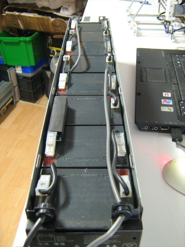

So now, I need 12V for my system, so I needed to wire all the batteries in each tray in parallel, fuse it and put some terminals on the end of the tray.

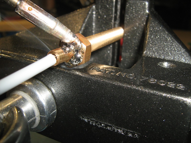

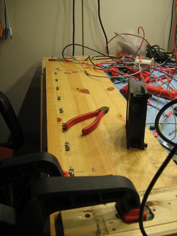

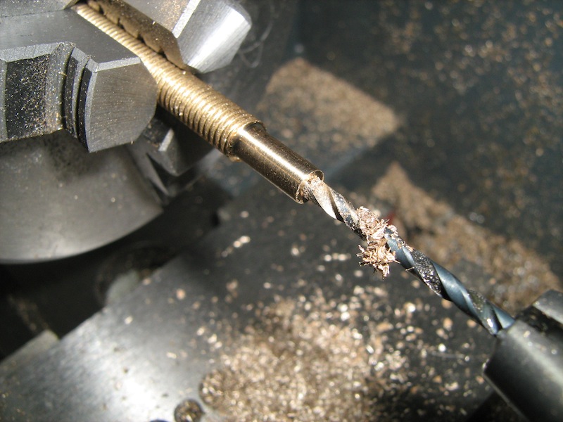

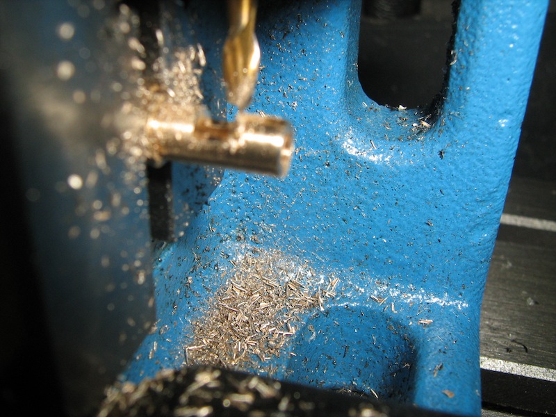

I made some terminals out of threaded brass rod.

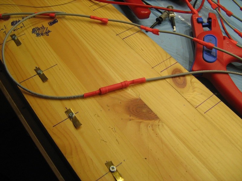

I made a jig to assemble the new wiring inside the tray.
...and made up the wiring with a fuse included.
My little JBC iron didn't seem to bothered about soldering an M6 brass nut onto a length of threaded rod, it just sort of got on with it.

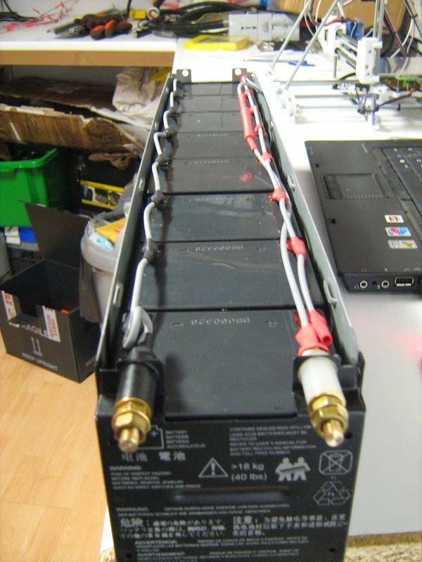

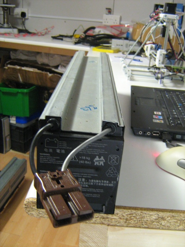

Next, the 12V batteries were re-orientated as required and wired up.
Then the tray is closed up again.
Wash, rinse, repeat twelve times. I must tell you, I don't cope too well with repetitive tasks, but luckily I was well behind on my Amphour episodes, so that helped the time tick away somewhat.

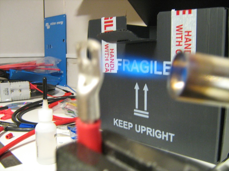

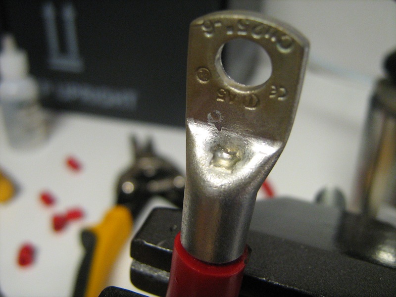

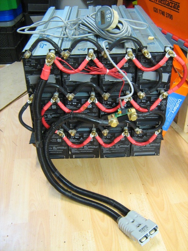

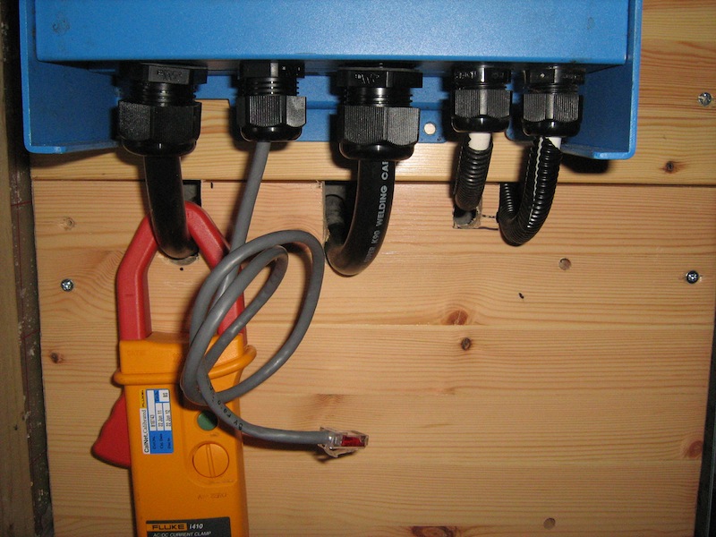

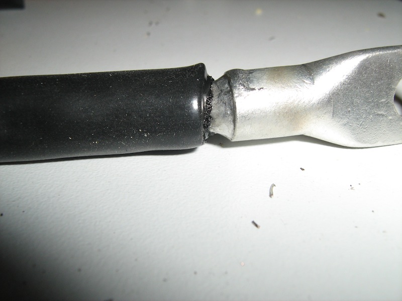

Now I needed to make up the leads to connect all the trays together. I went for 25mm² cable for this task as it's what I had to hand.
I cut short lengths and soldered terminals onto the ends. The JBC was not quite up to this task though, so I had to use a torch.
I just heated and fed the solder in through the hole in the top until solder came out the bottom
Then, bolt all the wiring in including the shunt for the Victron battery monitor.
It's ready. The whole lot weighs in at about 220KG, so although you can't see, it's on wheels for manoeuvrability.
That's it for now. Hopefully by next weekend, I'll have the inverter installed and running.

You should be aware, that many batteries in parallel are not going to share very nicely. Usually you don't want to parallel more than 4 times. If one battery becomes shorted, without each battery having a fuse, you will dump all the available current into that battery and have quite violent fire. Even if they are fused, the lowest internal resistance battery can still get quite of current dumped into it causing to outgas and fail. Please be careful.

you connected your batteries wrong. Connections should be on opposite ends of the bus bar for + and -. Drain your pack at 20A, then measure voltages on each battery you will see what I mean.

Actually, look gain. He did connect opposite ends
Yes, I did make connections from opposite ends of the bus bar. I did this both in the trays and the larger connections outside.
Yes, I realise that this is not ideal, however, all 96 batteries measured 12.45V within 10mV of each other.
They are not even the correct batteries to use for this application. Over the next year, I'll be able to save up for some proper deep discharge batteries better suited to this application.
What I need to do next it put a good load on the battery arrangement and then measure the current out of each tray at least to ensure that the current is equal out of each one. Although it's not fully charged, I could still do a load test. It's currently charging at 600mA, so it should be fully charged within the next couple of weeks. If anything is out of order, the pack will not be used and I'll have to wait for Santa. :)

Unfortunately, this plan did not work
The batteries are too tired. I charged them at five amps for several days until they floated. I then requested about 100A out of them and the voltage plummeted rapidly and steadily. Approximately 37 seconds then the inverter shut down at 11.5V. Fail.
Oh well, I still think it was worth trying to get some use out of the batteries that I had to hand.
Now I'll have to do some hardcore saving and get some decent batteries.

12.5V is too low for these type of batteries, you should measure 13.1-13.8V no load , they are 5AH batteries which means max sustained current is about 2A for about 1.5 hours.  If you put a 5A load on one it will only last about 30 minutes even though it should last 60 because of the type of cell.  They only way you get 5AH out of these batteries is to draw no more than 1A per hour for 5 hours. So out of each rack of batteries to get the full stored power you would need to only use 9A  on each one or 108A.
See if you can get the datasheet for the batteries and there should be a discharge curve .
I personally like the panasonic batteries for use in UPS, the other brands haven't lasted long.

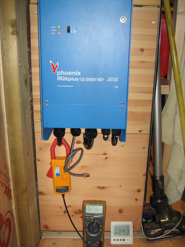

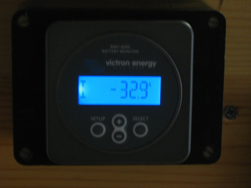

The performance is still not acceptable. It ran a 30A load for about two hours. I reckon it'd have died (12V) after another hour. It should be four hours to 25% DoD.

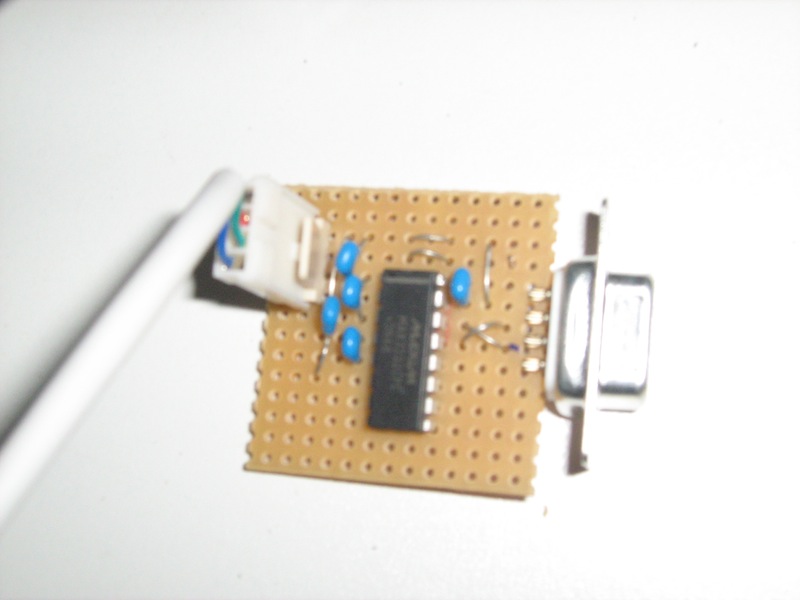

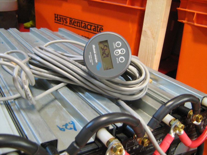

So, this evening I finished connecting up my BMV600 battery monitor.
I have also wired up the battery monitor to a computer. This was rather challenging.
First I had to find a computer with "Windows" on it, apparently made by some company that call themselves "Microsoft". OK, I have one knocking about, but it also needed a serial port on it, another unfortunate rarity these days.
Once this was done, one is supposed to shell out £100 for a cable that connects the BMV600 to the serial port. I guess Victron's idea is that this is pocket change to people who own a yacht and they'll just buy one, but not I.
After a bit of scouring through Victron's own publicly available documents I found out the pinouts of the BMV600, the protocol and the signal levels.
So, I knocked up my own cable using a MAX3232. The BMV600 powers the cable via it's own 3.3V line.
....and it works well with their software which allows you to log to a CSV if you wish. Leaving a computer (with "Windows" on it) switched on the whole time is silly, so I'll have to figure out how to port this data to my Thingspeak channel.

Right, so I've got everything installed and running now.
I had to wait for a time delay (S) RCD switch to come around a sensible price. They are quite expensive understandably. I eventually found a good 100mA time delay RCD for a price I was willing to pay. This switch is needed to replace the original 100A incomer and is wired upstream of the inverter. 100mA protection is acceptable for non-contact circuits.
The time delay aspect is to provide discrimination for the downstream RCBO's. This is not just for convenience it's absolutely essential for my application. It prevents you from waking up and finding yourself with two or more arses, which apparently, is never an ideal situation.
So, imagine that the inverter is not running and it has switched the incoming mains through to the loads. If there were to be a fault current to earth (via a human for example) and there was a 30mA fast acting RCD ahead of the inverter that responded first, the mains to the inverter would fail and the inverter would then switch on thus fault current would continue to flow through the person. There would be an extended delay whilst the earth relay in the inverter closes (the relay that connects neutral to earth to facilitate the operation of downstream RCD's) and then the downstream RCBO on the circuit to which the person is connected to would finally have a chance to disconnect. By this time the person (luck being on their side) would be feeling like they'd been hit by a train, a steam one to be more precise.
Now it's all be wired up correctly and the disconnect times need to be measured.
The 100mA time delay switch operates in 250mS at 100mA fault current up to 80mS at 500mA fault current. Good.
I then tested all the downstream RCBO's beyond the inverter with the inverter off (grid passthrough). They all disconnected within 20mS regardless of the fault current between 30mA and 500mA. The upstream time delay RCD never responded at all in this test. Good.
I then repeated the test on the downstream RCBO's this time with the inverter running (grid disconnected) and again, around 20mS disconnect times. Good, the gods are pleased.  8)
This installation of the inverter is now complete and I can run some experiments using my existing batteries until I get hold of some good ones.
