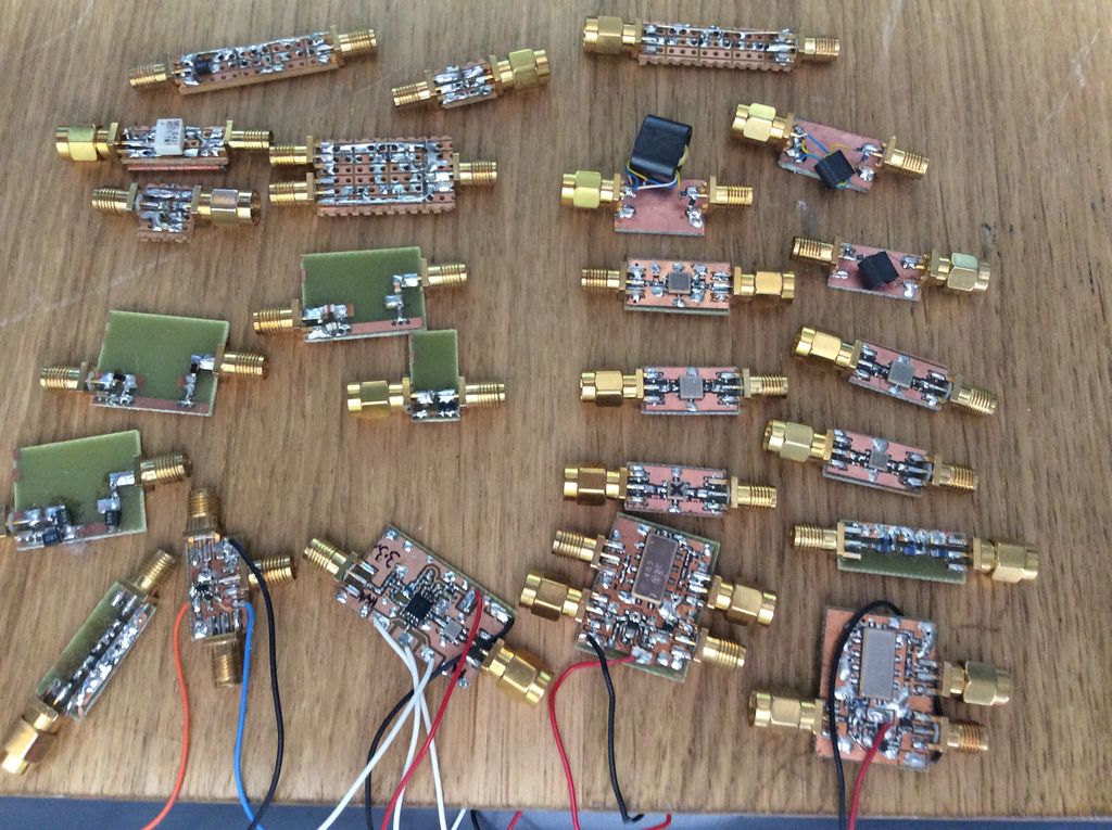

I have pretty much standardised on SMA for making networks because you can pick up the connectors so cheaply and fabricate the network on a bit of FR4, or, if it's HF or below, on small bits of stripboard.
I buy the connectors from a guy I found on ebay a few years ago, but I do use them for production so I buy in the thousands, they come in at about $0.25 each that way. While they're not going to win any prizes at 18GHz, they are fine at 2.5GHz and below, at least according to my old 8753A at any rate.
While I realise this doesn't answer your sleeve question directly, hopefully this is food for thought.

Online joeqsmith
  • Posts: 11897
Re: 50 ohm attenuator "sleeve" for home made inline attenuator?
« Reply #17 on: April 29, 2015, 03:35:38 am »
Sorry I misread the OP earlier.
Nice collection.  I've built a lot of quick assemblies like this as well without any problems in the 1GHz'ish range.
