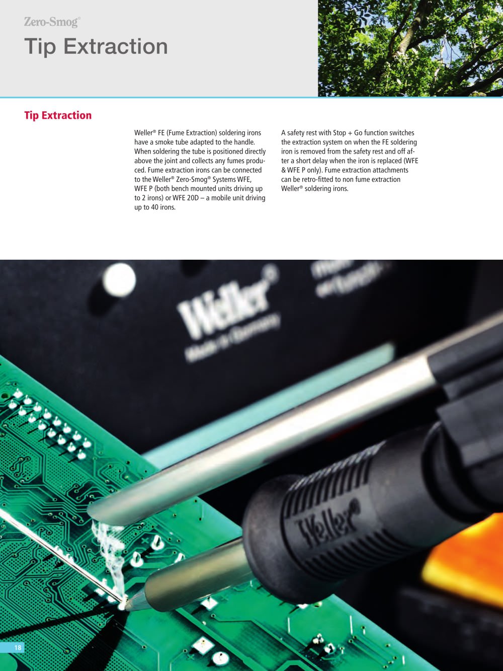

« Reply #10 on: December 07, 2013, 01:50:35 pm »
its a wp 80 iron i dont think its get in the way but their official attachments cost 30+ euros here for a metal tube and a hose
http://img.directindustry.com/pdf/repository_di/112639/fume-extraction-solutions-352637_18b.jpg
