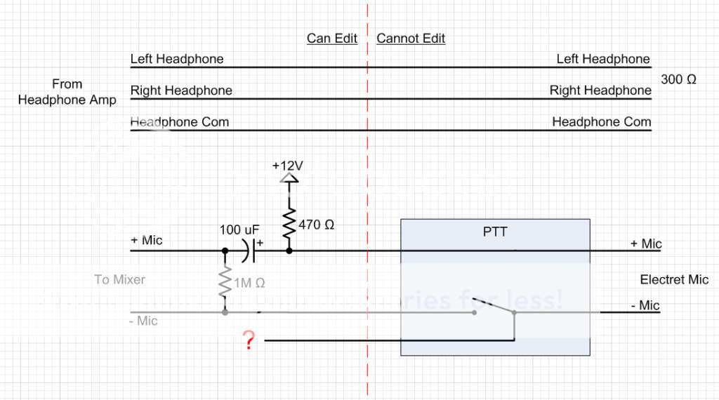

I am building a 8-person intercom type communication system with headsets that have electret microphones. I have been successful at pre-amplifying the microphone and have been getting really clean audio out, or at least clean enough for this application. The issue I am having is when I add the push-to-talk in series with my circuit.
When I hit the PTT, the people listening in are heading a pop sound from the FET inside the electret mic turning on, or something like that. I have tried connecting the wire on the bottom (with the question mark next to it) to the shell of the XLR, through a resistor to earth, to a capacitor and resistor to + Mic, to a capacitor to Headphone common.
I have also hooked the system up so the +Mic is on the PTT line and power is supplied over the question mark line. I thought this would keep the mic always powered and eliminate the popping, but no such luck.
A side issue I am having is coupling between mic lines and headphone lines over the some 50ft of cable I have running from the headsets to the audio equipment. I've tried putting a capacitor in between the -Mic and Headphone Com lines to decouple them, but to no effect.
So, essentially I am looking for recommendations on which microphone line I should be cutting and what I should connected to the question marked line in order to keep the audio from popping when I hit the PTT.

You have the wiring backwards.
The line you have indicated with the question mark is actually the ground from the microphone.
The line you are trying to use for microphone ground is actually the PTT signal.
You need to mute the microphone audio signal except when that PTT line is grounded.
It would have been nice if the PTT switch were NC (normally closed).
Then you could have simply used the switch to short out the mic audio with no extra parts.
But since it is NO (normally open) you will likely need an extra circuit to do the muting.
Could be as simple as a relay or a single BJT transistor.
470 ohms seems unusually low for that application. Are you sure of that value?
You did not mention what kind of cable you are using.
Since the mic signal is low level and unbalanced, it is unsuitable for running long distances without being separately shielded from the headphone lines.
If this is only for communication use, you could treat the headphone L/R as a differential pair (ignoring the common ground) and that might buy you better isolation from the unbalanced mic signal.
« Last Edit: January 20, 2015, 06:33:35 pm by Richard Crowley »

« Reply #2 on: January 21, 2015, 07:40:04 pm »
Richard,
Thanks for responding. Your suggestions did the trick. I added a small switching circuit with a PNP transistor and a small relay to handle muting.
The resistor value was from the microphone's data sheet as part of a test circuit used to find the frequency response of the device or something like that. In the new circuit I replaced it with a higher value resistor I had sitting around and it didn't seem to change the operation of the microphone. What would be typical for this application?
Also, the coupling I was getting over the cable has gone away completely with the new circuit.

..............n the new circuit I replaced it with a higher value resistor I had sitting around and it didn't seem to change the operation of the microphone. What would be typical for this application?
2200 ohm from 5V. At higher voltage those mics tend to be noisier due to higher drain-gate leakage. But I doubt it matters much in this application.
