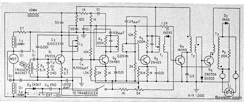

What I started with on the lake that day  was this:
http://www.seekic.com/uploadfile/ic-circuit/2009723225737217.gif , which is a spining disk with a neon as indicator.
That was 35 years ago, consumer sonars have improved greatly.
LM1812 is very obsolete, but had my attention as a kid. The data sheet is worth looking at.
