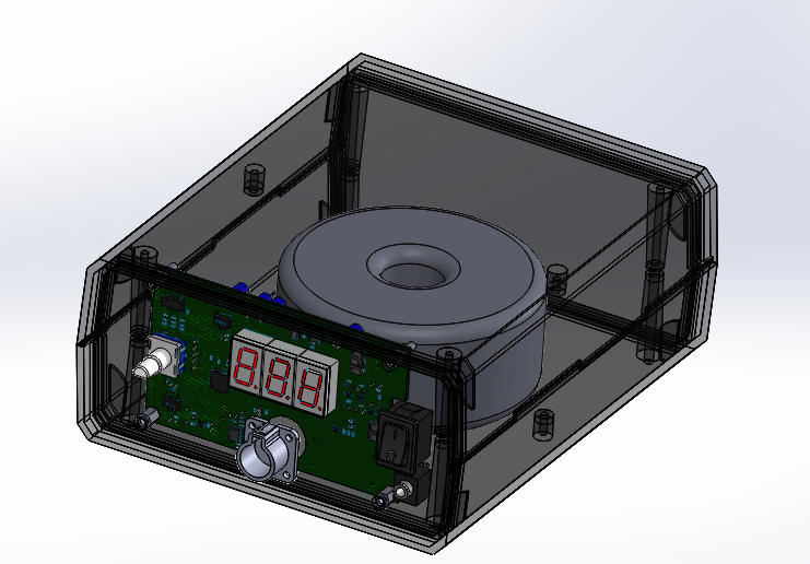

« Reply #29 on: July 20, 2014, 12:36:09 pm »
Some update :).
I have selected an enclosure and made a PCB for it.
I'm hoping to order the PCB some time soon.
