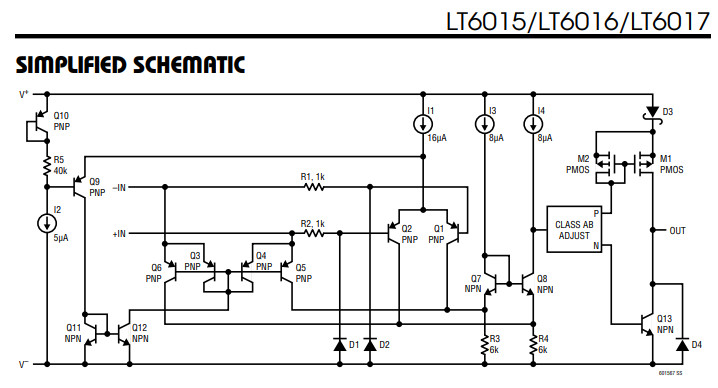

I looked up the LT6016 and cannot see how it can work as an op-amp above the +ve rail
I can see it can withstand high voltages if you do something in e.g. the I1 current source.
AFAICT, solutions for Vcm above the +ve rail have to involve resistors e.g. the LTC2862; no schematic published but it can easily achieve it with a resistive divider on the input(s).

The LT6016 works above the V+ rail because as the PNP long tailed pair  cuts off, its tail current source transfers via Q9 and is reflected by the current mirror Q11,Q12  to bias the dual current mirrors Q4,Q5 and Q3,Q6.  The input voltages on their emitters differentially steer the reflected bias current between the two mirror  collector outputs, which re-joins thje signal path from the long tailed pair collectors.  As Vin drops below V+ by a bit under a volt, Q9 cuts off, disabling the differential mirrors and the long tailed pair takes over again.
The main limitation is the reverse Vbe breakdown voltage of the long tailed pair.  Its obviously custom engineered to have a much higher reverse breakdown voltage than any normal discrete transistor.

OK; thank you. Very clever!
I too could not see how they did the Vbe issue which is normally about -5V max. I did a dig around and could not find much info that Vbe (rev) can be achieved above about 10-15V. But a trivial way is a diode in series with the base...
