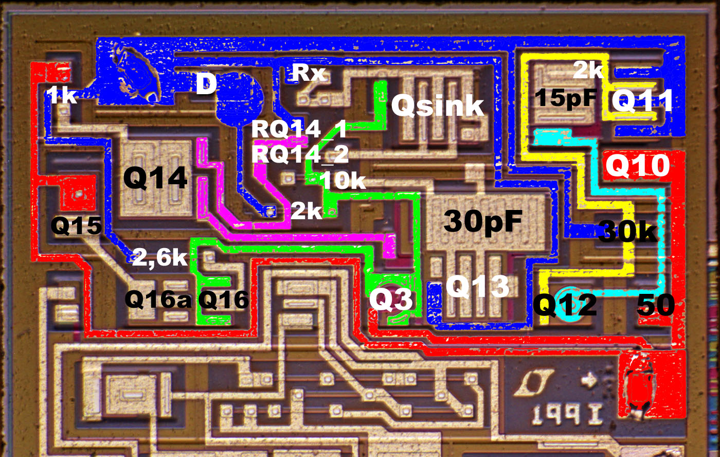

Hi all,
I have took a closer look on a LM399 shunt reference.
Actually it´s a HP-part...
You can find the whole story here:
https://www.richis-lab.de/REF02.htm
(german)
A nice die with big structures!  8)
Reverse engineering is not a big deal:
And here is the buried zener:
I found a circuit that´s not in the datasheet:
It seems they had to do some fancy compensation.  :-/O
And here the heater-circuit:
I wrote a lot about the circuit but it´s too late to translate all that words to english. Please use the google translator and ask me whatever you want.  :popcorn:

Bei der Z-Diode D1 handelt es sich anscheinend um die gleiche Subsurface-Diode wie im Shuntregler.
Yes, the Dobkin's paper confirms that.
2 burried zeners there.
PS: I can send you a MAC199 (TESLA's highest grade LM399 clone) for de-capping if interested.
PPS: TESLA's schematics show the missing transistor and resistors, there is even one additional transistor more :)
« Last Edit: January 17, 2020, 11:58:50 pm by imo »

« Reply #5 on: January 18, 2020, 06:43:22 am »
A MAC199 would be very interesting! I´ll write you a PN.
And thanks for the hint to the schematic of the MAC199 and now I see the Double-Transistor. Will correct that on my homepage!  :-+

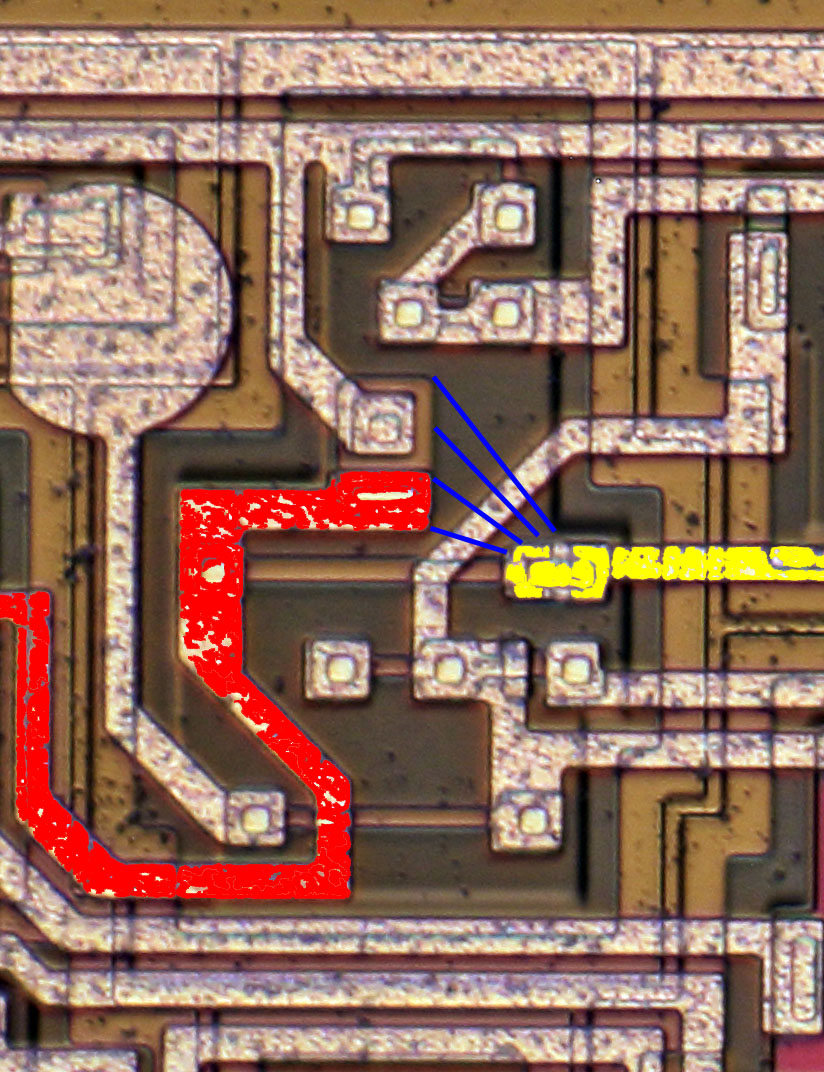

« Reply #7 on: January 18, 2020, 12:10:50 pm »
I´m not sure whether that´s really a transistor:
The bigger thing above the resistor-lines.
In my view that is still a resistor.
Well I´m not sure but I see nothing that indicates a transistor.
Otherwise it would interact with the other resistors placed in the same well.
I´ll try to take a better shot of the area…  :-/O
No, I don´t think that´s a Transistor...
Offline Wimberleytech
  • Posts: 1134
Re: LM399 - die analysis
« Reply #11 on: January 18, 2020, 09:05:28 pm »
Looks like a resistor to me

« Reply #14 on: February 07, 2020, 08:33:39 pm »
Do you remember me saying that in the LM399 there is a additional circuit similar that shown in the datasheet of the MAC199?
I claimed one of the two additional transistors isn´t actually there. I was pretty sure that it´s a resistor:
Well some days later: It could be a transistor!
Probably the brown "resistors" are p-doped. If there is an additional n-doped area under the upper contact than we have a pn-structure. With the n-doped well you get an npn-transistor.
Fine!  :-+
If you don´t want that every structure in the well interacts with the half transistor the well has to be more positive than everything else. The most positive potential is the red one coming from left into the picture. But it seem´s that the well is connected to the second yellow contact of the resistor. Since the role of the transistor is a shorting of the resistor it´s ok to connect the well to the second highest potential, the second contact of the resistor.
Fine!  :-+
It´s more a parasitic transistor and possibly not a very good one but it should work.
 :-/O :popcorn:
