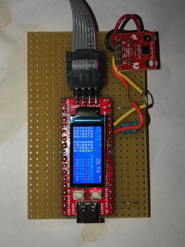

Here is the board it is just the Nano, the HTU21D and (2) external 4k7 pullup resistors on the SDA and SCL pins of I2C bus.  The HTU21D board has its own internal pullup resistors that are disabled.
Everything is 3.3V on this board and sensor.  It is using IC20 but the code is written to allow either IC20 or IC21 to be used it's not hard coded to IC20 peripheral.  The LCD library is the GDV32F103 SDK that comes with platformio.
I spilled some coffee so the paper has stains on it in case you were wondering.  Stripped some of the insulation on the SDA (yellow) and SCL (orange)  wires so I could use a logic analyzer to play around with PulseView and how it interprets I2C procotol.  The I2C communications protocol I got by reading the HTU21D datasheet.   Also the temperature and humidity formulas to convert from raw numbers to useful values.

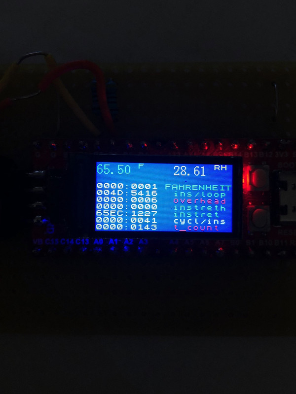

Here's a closeup of display
Temperature  (C or F)  and relative humidity RH
a count of # of times BOOT was pressed and the banner FAHRENHEIT or CELSIUS
number of machine instructions executed in this loop measured at start/end
Overhead in machine instructions of measurement function itself:  6 instructions.  It gets this by calling the instruction count twice in a row and substracting the two values: it is just 6 machine instructions. It consists of reading the 2, 32-bit registers and returning the result as a 64 bit number.
High- and low 32-bits of "instructions retired count" instreth/instret this is a running count of machine instructions executed since the last hardware reset
"cycl/ins"  shows the value 'instruction clock ticks divided by instructions executed', i.e. a value around 65 which relfects it is spending most of the time in sleep mode
t_count is the number of timer alarms one fires about every 3.1 seconds and it takes a reading displays and computes everything and goes back to sleep.
