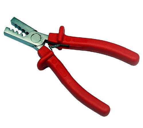

Yup. Here's what the crimper looks like, the metal is pretty thin, so the tool doesn't need to be huge: http://g03.a.alicdn.com/kf/HTB1gypqIVXXXXbCXFXXq6xXFXXXi/Crimping-Pliers-for-Cable-Links-Crimping-of-Wire-End-Ferrules-Crimping-Tool-New.jpg
When they're crimped they look like this: http://www.epanorama.net/newepa/wp-content/uploads/2014/02/crimpresults.jpg
