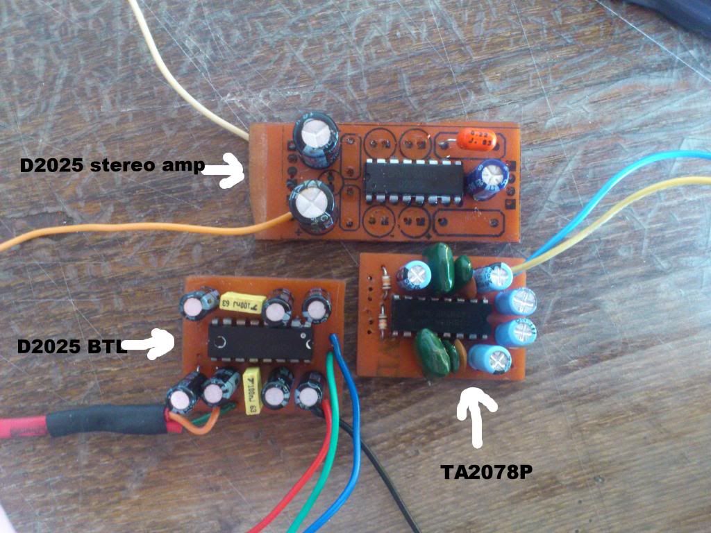

At the end of the day i had three boards and all of them failed, both of the D2025 amps gave out a loud oscillating noise and started heating alot, as the TA2078P gave out audio but it was very crappy and loud. :-BROKE
The method i use for making my PCBs is toner transfer method, although my toner transfer skills aren't the best i can still do pretty well ( not always ) and i always check my PCB with a multimeter to make sure there are no shorts.
Here's the photos. ( big apologies for all the flux and all the crap, i also reused some parts from the other D2025 board )
Please excuse the horrible soldering, i'm still using crappy solder and a plug-in soldering iron ( I've already ordered a new soldering station )
What do you think was bad in my circuit boards ? ( not including the horrible soldering of course  :palm: )
I want to make sure where's the problem before another one fails.
I'll post PCB layouts soon.
Thanks in advance.

I would increase polygon pour clearances to reduce any risk of solder bridges.

It seems you have shorted pins to the ground(is it) plane, I would start by setting the expansion/isolation between the tracks and the plane to something like 20 or 30 mils, and make oval pads for the DIP's, so you have bigger pad in front and back of the pin and there is a smaller chance that you will short anything.

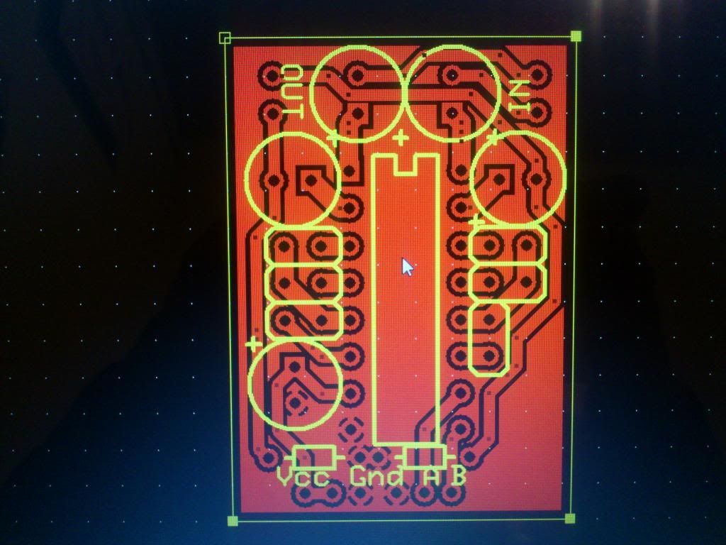

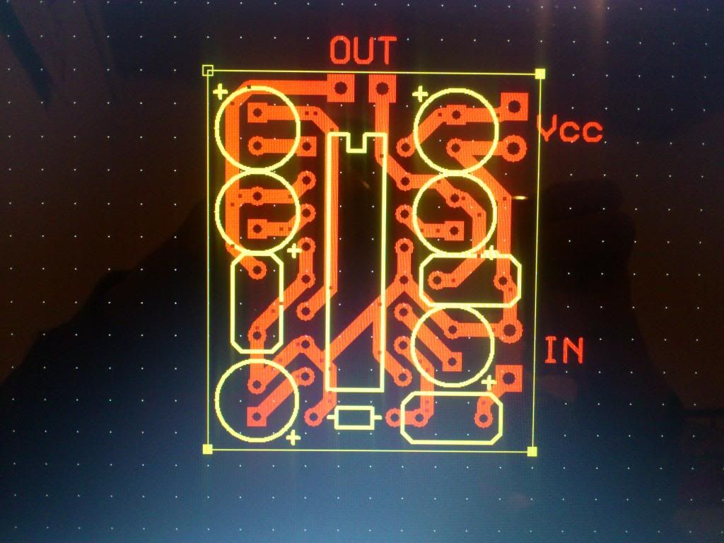

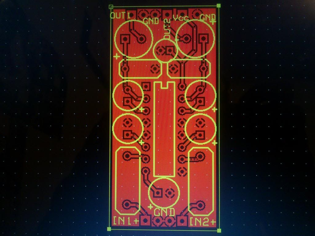

I've tested the connections before powering them up and there didn't seem to be any shorts.
Here's the layouts.
D2025 BTL :
D2025 stereo :
TA2078P :
Btw, what do you guys think of my layouts, are they any good ? ( I'm a beginner at this kinda stuff )

Offline lapm
  • Posts: 564
Re: Having complete failures with my homemade circuit boards.
« Reply #4 on: April 01, 2014, 07:08:25 pm »
I would pay attention to clearances. Seems you have some issues of them being quite narrow... Other then that i see nothing too bad...

Offline tautech
  • Posts: 29432
« Reply #5 on: April 01, 2014, 07:29:07 pm »
Clearances, plane and between tracks need increasing. IC pads, change to oval. Increase annular ring size on pads where tracks pass through. And the big one for signals...remove all un-connected copper planes.
Study some PCB's to get some basic rules for your applications.
« Reply #10 on: April 01, 2014, 11:55:02 pm »
What are you using to power them?
The TA2078 has ~5mA quiescent current, but in practice will require ~50mA with signal. The D2025 has a quiescent current of 50mA, but again will draw 10x that or more with signal.
The symptoms you describe - distortion in the 'equaliser', and audible oscillation/motorboating in the amp - are what you'd expect when running from a supply without sufficient current capacity.
BTW, your D2025 looks like a knockoff version of the TEA2025, which is known for stability problems / oscillation due to poor layout & suppy regulation. You might want to look up datasheets & app notes for that...
For OP on this- Sparkfun has a fairly decent set of design rules that are really easy to implement for starting out into PCB making. Agree with lapm here, traces need to be wider and you need more clearance. Also make sure your part spacing is ok, some if it looks tight in EAGLE (but it looks fine on the board). Oh, and make sure your V+ and GND planes/connectors are fairly well isolated. I know from experience getting these too close is a pain in the butt, straight shorts across :(
That will definitely help in soldering at least, which would help a little there. For DIY boards they are pretty good! - I tried toner transfer and suck at it... iTead Studios is so much easier...

« Reply #16 on: April 02, 2014, 10:45:43 pm »
I don't draw schematics myself, i use the ones provided with the PDF, you can find all of them there.
No, you need to give us your schematics for the circuits as built.
There are several discrepancies between the datasheet schematics, your board patterns with overlays, and your photographs. For example on the overlay of your BTL board pattern/overlay you've marked a component of some type between pins 7 & 10.
That's not on any datasheet schematic - is it a mistake, something that you added, something that you left out ... what?
It's impossible for us to tell, because the only other clue you've given is photos of half-disassembled boards  :palm:

« Reply #18 on: April 03, 2014, 12:05:56 am »
i've checked he's good. 7-10 resistor is just extension which he didnt put.
Well, that's my point - it's probably OK, but (a) it looks like a resistor there without reason (which he hasn't given), and if that's the case then (b) his circuit isn't just "the ones provided with the PDF" like he said. On the other hand, maybe it was never installed - but since at least one of the boards has been half-gutted, we can't tell anything for sure...
maybe the problem...
1) components values similar to DS?
2) components broken?
3) chip broken?
4) short or open tracks?
Then there's also the small matter of being unaware of the necessary stability recommendations, due to the shitty datasheet for the knockoff D2025 (and from general knowledge of similar amp chips). For a start, the grounding of the single channel BTL board is poor - as far as possible it should be star-wired with hefty tracks back to a single ground point, and ideally pins 4,5,12,&13 would be connected by a single pour. Conversely, on the stereo board, the ground pour should be pulled back well away from both the input and output pins.
But I'm still betting he's trying to run it off a 9v battery or similar...

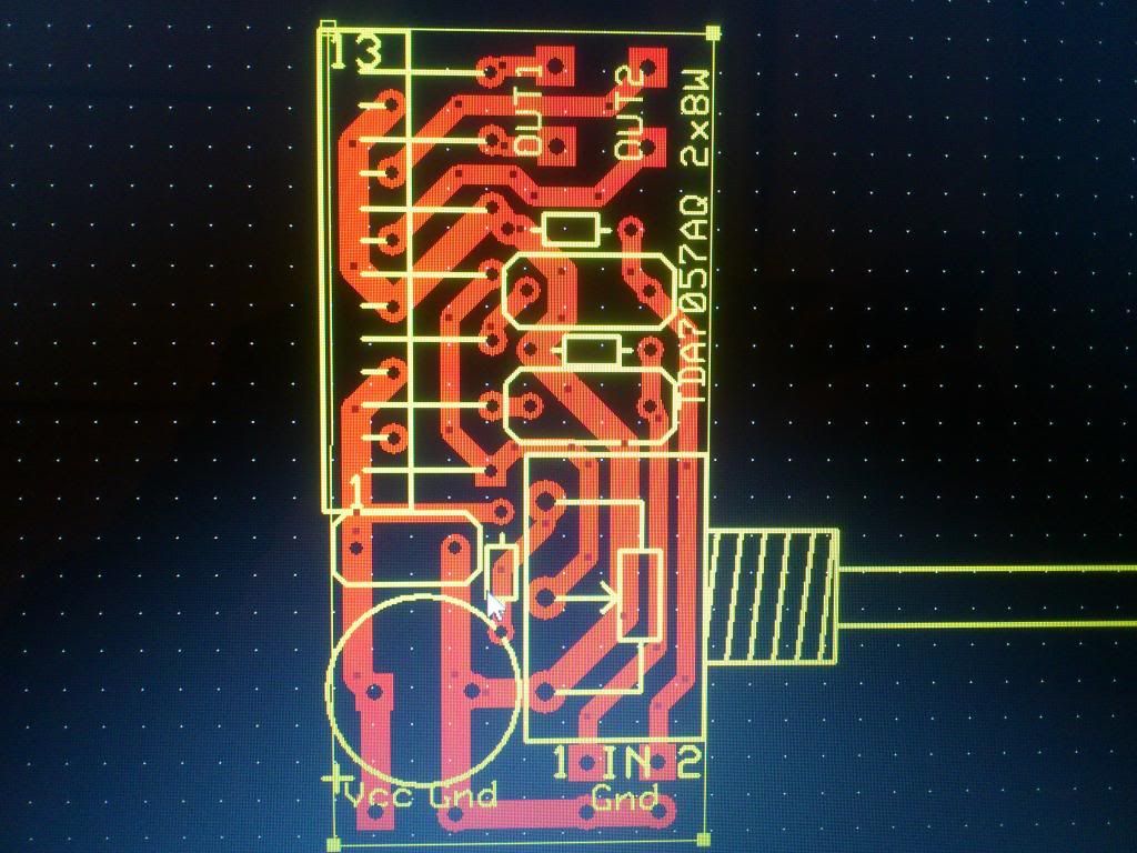

Here's one i just routed out, it's a TDA7057AQ.
 ( don't expect to see anything amazing nor safe )
 ( PDF http://www.dectel.ru/components/ms/pdf/TDA7057AQ_4.pdf )
I did a small test and it seems like i can do traces 0.20 mm and up without much problems, 0.15 mm is where tracks get distorted and blurry.

Tac Eht Xilef
  • Guest
« Reply #20 on: April 03, 2014, 11:06:00 pm »
 :palm:
I wish you luck.
