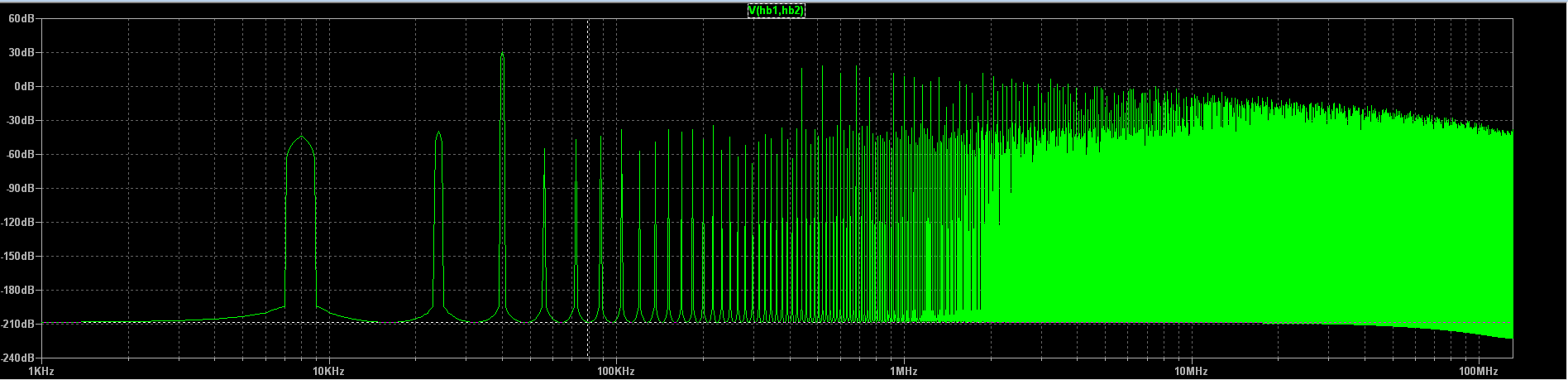

I'm generating a sine wave using selective harmonic elimination PWM, which switches at some multiple of the required frequency (depending on how many harmonics you need eliminated). It's then passed through a LC filter to get rid of the rest, and into an output transformer.
The C2000 is needed due to its HRPWM capability. I've not found an alternate part that can do its job (unless I roll the implementation myself in a FPGA). HRPWM seems to just be regular PWM with a tapped delay line, but the fine edge positioning is fairly important.
I sort of need the isolation (one side of the output has to be at protective ground due to the transducer design), but I can work around that by measuring before the output transformer.
Just the fundamental needs to be measured. The harmonics from the full-bridge are attenuated sufficiently with the LC filter that they're barely visible in the time domain on the voltage waveform (don't have a FFT at hand).
The transducer is driven at its resonant frequency, and is pretty much a series LCR circuit in parallel with a small shunt capacitance (couple of nf) at that frequency, so the current waveform should be pretty harmonic-free.
Eventually this will run in a multi-transducer setup, and I'm not sure how much pickup there will be from the other transducers. But that's solvable in software.
Simulations give me an about 1-degree phase shift baseline plus some unknown contribution from the component variances. I actually didn't expect 1% C0Gs to be this cheap, so that pushes phase error due to component tolerance well within error bounds (and I can fiddle a bit to match the phase response of both voltage and current).

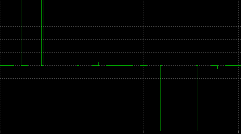

SHE-PWM works by calculating optimal switching angles to eliminate harmonics up to some defined limit. For example, the waveform https://i.kane.cx/RmKAlS eliminates all harmonics up to the 11th: https://i.kane.cx/DAdCTi . This can then be used via a full-bridge to have a high-efficiency, clean single-tone amplifier.
*After* the full-bridge, it gets filtered down to a sine wave.
The following users thanked this post: ogden
Seems like SHE-PWM needs my further attention, thanx :) Agreed - *if* you use "switching" amplifier, then DDS is no use. You need "1-bit DAC" with PWM or PDM(DSD) modulation.
Offline aandrew
  • Posts: 277
Re: Maintaining phase accuracy for kHz power measurements
« Reply #20 on: January 25, 2020, 02:18:44 am »
SHEPWM looks an awful lot like Don Lancaster's "Magic Sinewaves" from the 80s.
Offline KaneTWTopic starter
  • Posts: 811
« Reply #21 on: January 25, 2020, 08:55:14 am »
Looks similar at first glance, but the methodology is completely different. I think the magic sinewaves paper is a special case of SHE-PWM. Haven't read it closely enough to make sure, though.
