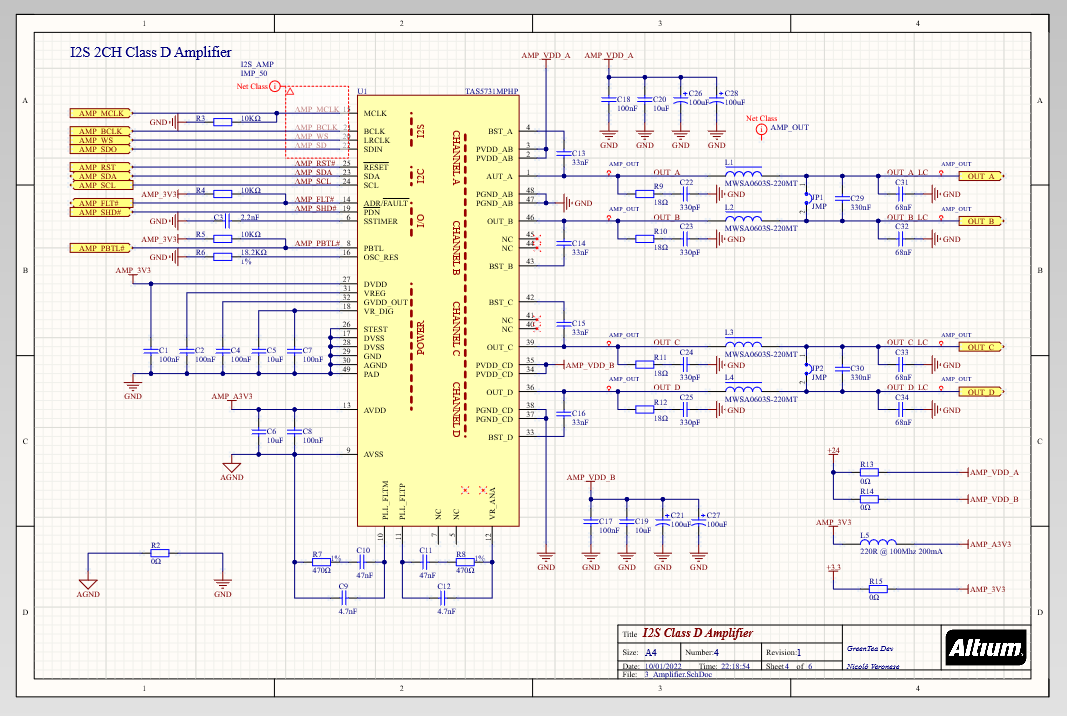

I've desiged an audio board a year ago, but until recently due to chip shortage I was not able to assemble it |O.
 I've finally received all the parts but it is not working as intended.
I've assebled one but the digital Amplifier IC have a flag about a bad MCLK, BCLK, LRCLK clock.  :horse:
That said with a logic analyzer cature everything seems fine, so I've asked a friend to take a capture with a scope:
(Yes the photos are what they are... he is a SW guy like me and borrowed the scope at work during launch break)
MCLK:
BCLK:
LRCLK:
These clocks are generated by a PCM9211, it have a 24.576Mhz OSC and with internal dividers it generate the various clocks.
The quartz clock seems fine to me, but the MCLK is really noisy.  :--
On the board I have impedance matched traces set at 50Ohm, it is a 4 layer board with GND planes in the middle.
The amplifier IC and the PCM9211 (Digital MUX and ADC) are only 2cm apart. so no long traces that might introduce a lot of delay.
Any idea on why this is happening? Any suggestion on what I could try to solve this? :-//

Can you show us the layout?
It's hard to tell what's going on, since the ringing shown on the scope could easily be due to scope probe ground lead placement, but assuming that the signal is really as shown here are some comments:
* 2cm is quite short, and I wouldn't expect a lot of ringing -- but depending on the actual trace length and edge rate I suppose it's possible.
* There's nothing wrong with 50 Ohm trace impedance, but it's unlikely that you have either 50 Ohm driver Z or 50 Ohm input Z so you still need to take steps to get a good clock signal.  We commonly put a series resistor at the driver output to help match the trace Z, slow down the edge, and absorb reflections from the virtually unterminated end of the trace (a typical input pin Z is a very high R and small C to ground).  There are other ways to get good signal shape, but this method usually works well.  The series resistor method gives a full swing at the output.
I have series resistors, I've put 33ohm in series since I already had that value in the BOM.
How can I calculate a more valid value?
I'll attach the layout, left chip is the amplifier (TAS5731M) and the right one is the PCM9211 (Dac and Input Mux). The schematics are basically the EVM ones. Initially I've thought that the problom was my crystal beeing bad; I've forgot to put a series resitor on OSC_IN so it might had components. But the scope capture seems clean to me. (It is a cheap one from LCSC)
To probe I've soldered a debug connector for my friend, there is some flying wires for it. but they are also short and are connected after the 33Ohm series resistors.
The scope was connected to one of those pins at a time, the one at the sides are GNDs (the connector has been soldered down to the PCB to give some stifness and to provide ground reference)
I'm including a simplified schematic since the original one is divided into multiple pages.
MCKO is an auxiliary clock out of the PCM9211 that I've configured with a divider of 2.

The amplifier section:
https://e2e.ti.com/cfs-file/__key/communityserver-discussions-components-files/6/pastedimage1641852424770v1.png
The PCM9211 section is mostly the same of the EVM board (I have no coax, and no optical inputs I only use th MPIOs and the ADC):
https://www.ti.com/lit/ug/sbau174/sbau174.pdf?ts=1642776354790
The difference are the 33Ohm resistors between the TAS5731m and the PCM9211 main output port.

Probin has been done on the soldered on additional connector. It have both GNDs and clock signals.
That hot-glued additional connector with all the wires?  That's going to add major reflections.  The scope probe signal will look lousy, and the unterminated stubs (wires and connector pins) will cause major reflections that will show up as ringing at the clock input to the device being driven.
The 33 Ohm series resistor is probably about right.  The problem is perhaps the layout and definitely the wired connector.  Did you have your clock problem before you added the connector?
By the way, I'm not criticizing the hot-glued connector, I've done that when necessary and mine looked just as ugly.  But mine was for slow signals.  You can't treat critical clocks like that.

The way I would probe that circuit (after removing the wires on the clock signals) is to find a good ground connection near the end of the trace.  It looks like you may have to scrape off a bit of solder mask.  Find a place that's close to a feed-through so you have a short connection to the inner ground plane.  I usually scatter grounded pads around the board (with holes for a soldered header pin) so I have available probe-ground points.  Connect the probe ground to that ground.  Then probe the clock input pin.  You will probably see ringing or a step if you probe at the series resistor, but the signal at the pin should be fairly clean -- this is the way an unterminated transmission line works.
There are tutorials available that show ways to connect your scope ground, and you may want to review them.  The alligator-clip ground is usually OK, but there are ground-probe adaptors that work much better.  I've lost my adaptors, but I do just as well by winding a short length of solid bare hookup wire around the probe ground sleeve.

Hello: Digital scopes especially made in China often have poor transient response.
Your long Wide spaced wires and connector create an LC circuit that is ringing.
Just make Zo probe: Place 1/8 or1/4 W axial resistor 450 Ohms  DIRECT to IC pins, attach RG198/U coax to other resistor end and IC ground.
Other side of coax to 50 Ohm scope. If scope is 1 meg input use inline 50 Ohm term.
Makes a 10X Zo probe.
The scope configuration should be visible in the pictures."
