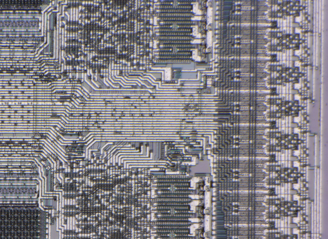

The MOSTEK MK37092 is a NMOS-Mask-ROM with 8kB of memory. The naming of the memory chips is explained in the datasheet except for the three numbers 092. As we will see later it looks like 092 is the name of the project, more precisely the data that is written into the ROM.
The datasheet shows us the internal setup of the memory.
It looks like the contacts in the package were arranged to perfectly fit to such a memory die.
It seems like half of the die was cut and the lower half was broken to get the die out of the wafer. That was a common procedure.
The die is 5,3mm x 4,8mm.
There are some mask markings on the die. The name of the ROM and the mask revisions can be found in an area which isn´t coated by the passivation layer. The metal looks brighter in this area.
Mask 1 forms the active area. Mask 2X includes some special doping which is necessary to "program" the information into the memory array. We will see that later. The numbers 092 are integrated with this mask so 092 is probably the number of the project. If there is this special doping under the gate of a transistor the threshold voltage is modified. We can´t be sure whether 2X is one mask or there are two masks named 2 and X. One for normal operation (2) and one for the data (X). In the upper picture 2 and X are in two separated squares.
Mask 5 forms the polysilicon. Mask 8 forms the metal layer. Mask 7 seems to generate the vias. I´m not sure about mask 6 perhaps that´s another via, one to contact the polysilicon and one to contact the active area.
There are a lot of test structures on the die. These strings contain small polysilicon stripes connected with the metal layer. I assume that´s for testing the interconnection resistance. I further assume the two long structures left and right of the die and the different spacing is for identifying local process imperfections.
Some transistors with different W/L-factors.
That looks like small parts of the memory area.
On the left side you can measure a stripe of the polysilicon and a stripe of the active area.
On the right side you can contact a normal transistor with a polysilicon gate and a metal gate transistor.
Some more transistors... ...but here there are no contact slots in the passivation layer...  ???
Here we see the structure of the memory area without the metal layer. I will explain how it works later. In the three areas the width of grid structure is different.
The ROM was designed in 1980. The test structures show the resolution of the manufacturing process. Metal layer is a little coarser than the other structures.

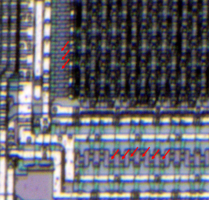

The memory consists of four blocks (red), each containing 256x64 memory cells. The inner blocks have two, the outer four additional rows that do not contribute to the memory size. However, these are not just dummy structures, which have to ensure a functional core. They partly serve the function of neighboring memory lines.
Most of the address lines arrive from the right. On the right side there are the 12 input buffers too (yellow). The address lines A0, A1, A10 and A11 control a first multiplex column (blue). This column generates 16 control signals for each memory block. Address line A9 doubles the control signals in a second column, so in each memory block 32 lines can be selected (white). In each memory block there are always two lines active.
To select a column in a first step the address lines A2, A3, A5, A6, A7, A8 and A12 in the middle of the die are converted into 128 control signals (black). The address line A4 controls two small output stages at the left end of the memory area. The two output signals of this circuit are connected to the two double lines, which in turn realize the column selection (pink). The address line A4 thus doubles the 128 control signals and only one of the 256 columns of the memory is activated.
At the left output of each memory block, the 64 lines are combined to two outputs (orange). This grouping is possible because only two of the 64 lines are active simultaneously. A mixing of the information cannot occur if you have done the interconnections right.
The output signals of the four memory blocks are fed to two output stages each (light green). The signals pass through another circuit (dark green) which contains the drivers for the output stages.
Here you can see two buffer stages for the address lines. The differential outputs are connected with the first stage of the line selection. The input signals of the corresponding bondpads arrive from above and contact the buffers on the right side. Vertically, four common control lines run through all buffer stages.
The differential signals of the address lines A0, A1, A10 and A11 are connected to eight vertical lines which pass through eight active areas at each of the four memory blocks (red). In these active areas there are two rows of polysilicon gate electrodes. The gate electrodes are placed and contacted in such a way that, depending on the address applied, only one of the 16 outputs in each memory block becomes active. Considering the whole memory, there are four control signals active.
To the left follows the changeover switch, which ensures that 32 line pairs can be selected with the 16 control signals (green). The alternating contacts in the two vertical running control lines are clearly visible. Strictly speaking, this is not a changeover switch. The active areas contain two switches which are supplied by the two vertical lines. By switching the two supply lines, one ensures that just every second active area can switch through the desired signal.
Behind the block with the changeover switches there is another circuit. Probably there are supporting circuit parts, like pull-up or pull-down structures.
The interruption between the inner and the outer memory block is caused by the interconnection circuit at the left side of the memory block. The control on the right side has been mirrored for better signal routing.
After removing the metal layer it becomes more obvious how the line selection circuit is working. Even without a complete analysis it´s clear that there is always one inactive line between the two active lines.
In the right area you can see how the control signals are generated out of the differential address lines. It´s like a NOR circuit. The output is active when none of the transistors is active.
Column selection is performed with the other differential address lines running horizontally in the middle of the die. Similar to the row selection, the lines contact vertically arranged polysilicon strips. Half of the total 14 address lines are located above the wider Vss line in the middle, the other half is located below it. Depending on the contacting of the polysilicon strips and the structure of the active area below only one of the 128 control lines is active.
Between the address lines and the memory areas there are two lines each, which can drive the columns. Depending on the status of the address line 4, one of the two lines becomes active and thus one of 256 columns can be selected with the 128 control lines. In the lower and the upper memory blocks always the same column is active.
A closer look does not reveal the function of the column selection right away. Although there are some differences in the structure and contacts, the majority of the structure appears quite uniform.
After removing the metal layer it becomes clearer. At the lower edge of the picture small part of the column selection circuit is shown. There are small vertical polysilicon strips which are connected partly at the upper partly at the lower end with one of the address lines. The active transistors connect the columns to Vss until the address of the column is selected, thus disabling all transistors. Above the address lines is a pull-up structure.
The two rows of column selection circuits are basically the same. The lower area of the upper row and the upper area of the lower row are just extended a little so the necessary interconnections could be made.

The structures in the memory area do not reveal anything about the programming. The metal layer is connected to the active area at regular intervals. Two polysilicon lines of the column selection run between each of the vias.
The functionality becomes clearer as soon as the metal layer is removed. The memory is based on a diagonal grid of the active area. The polysilicon lines run above this grid. In the lower picture they are marked with straight stripes. In fact, they run in a curved pattern as you can seen in the test structures. The polysilicon strips form transistors in the diagonal connections between the crossing points. In the crossing points, the metal layer contacts the active region.
There are always two rows active (green) with one inactive row in between. Actually at the lower end of the memory area there are three lines active. I have ignored this here for better understanding. Each memory line needs two adjacent lines to do it´s job properly. This explains a lot of the dummy lines. They do not directly contribute to the usable memory. Parallel to the two active rows, one of the columns is active (green). The active polysilicon line can activate two of the diagonal transistors at each memory cell in the column. An active transistor causes the potential of the active row to be pulled to the potential of the neighboring inactive rows (bottom row). The desired information is introduced into the memory area by adding an additional doping. If one changes the doping in the diagonal transistors (blue) they never become conductive. The selected row is not affected and delivers a high level to the output (upper row).
After removing the polysilicon there are just the outlines of the active areas left. The doping that represents the programming is not visible. Even in a sharper image it would not stand out. However apparently there are special chemicals that can be used to make different dopants visible.
At the left end of the column selection you can see the buffer stages that realize the switching of the two column driver lines for the upper and the lower memory area.
Left of the memory area the rows are interconnected in a circuit with two columns. The circuit outputs two differential output signals from each of the four memory blocks. Since only two rows are active in each memory block the circuit does not require any additional control. The rows simply need to be alternately connected to one of the outputs.
Left of the interconnection circuit there is a circuit section that most likely takes the output signal of the memory, does some signal conditioning and switching (OE) and drives the output stage. Each output has a large lowside and a large highside transistor placed directly at the bondpad.
The bondwire leading to the bottom of the ceramic package is connected to the substrate, to a frame structure and to a circuit. Perhaps the circuit generates a negative voltage that is supplied to the substrate. A negative substrate gives you better transistor performance. We have seen such circuits on the die of the NEC µPD7220 (https://www.richis-lab.de/GraKa02.htm)
In the upper left corner of the die there is a preparation for an additional bondpad. Just the metal layer is missing. Probably you can use the die in a different configuration as well.
We can take a closer look at the input protection. The bondpad is connected to a resistor strip. The reddish frame overlaps the end of the resistor strip. The frame carries the presumably negative substrate potential. The overlapping area most likely forms a diode that limits negative input voltages.
The seemingly unnecessarily long and wide metal line from the bondpad to the resistor strip forms a transistor with the structures underneath. The resistor strip runs parallel to an active area. In the event of an overvoltage the gate-source voltage of the transistor is high enough to establish a conductive channel between the resistor and the active area under the metal electrode. That´s the protection path for overvoltages.

The КM537РУ1 (KM537RU1) is an SRAM with 1kBit of memory. In addition to the ceramic housing, a variant in a plastic housing was also available with the designation КP537РУ1 (KR537RU1).
The manufacturer cannot be identified, which is often the case with semiconductors from the Soviet Union. Widespread types were usually produced by several manufacturers. The datecode shows that the component dates back to 1984.
In addition to the КM537РУ1 (KM537RU1) and the КP537РУ1 (KR537RU1), the Russian datasheet also lists the К537РУ1 (K537RU1) and КИ537РУ1 (KI537RU1) variants. These are merely different pin arrangements. The symbol in the Russian datasheet (left) shows the pin assignment of types KM537RU1 and KR537RU1 in brackets. Next to it is the pin assignment of the K537RU1 and KI537RU1 variants.
In the datasheet collection of the "Kombinat Mikroelektronik Erfurt", issue 1/86, there is a German datasheet for the KM537RU1 and the KR537RU1. A different pinning is shown there (right). The chip enable input and the read/write input are reversed. As will be shown later, the pinning in the Russian datasheet is incorrect.
The table describing the states and behavior of the SRAM also contains an error in the Russian datasheet, but it is easy to spot. The collum CE, which activates the module, must contain a 0 in the first line. It is interesting to note that the memory outputs the inverted input signal while writing data.
The datasheet contains a block diagram with no surprises.
The dimensions of the die are 3,9mm x 3,0mm. According to the datasheet, 7.200 transistors are integrated. This image is available in higher resolution: https://www.richis-lab.de/images/RAM/06x04XL.jpg (45MB)
There are no structures on the die that give an indication of the manufacturer.
At the right edge there are a few auxiliary structures showing how well the masks are aligned with each other.
At the top edge is a test structure that appears to contain three transistors.
There are buffer stages located directly at the input bondpads (black). The buffer for the CE signal is relatively large because this signal is used in many places in the circuit. All buffer stages are activated with the CE signal. The DI signal is also controlled by the R/W signal (light blue). There is a driver at the output (white). Left of the driver is a flip-flop evaluating the differential signal output of the memory. Another part of the circuit links the output driver with the CE signal. This part of the circuit also appears to generate a certain delay so that the output only becomes active when a valid signal is present.
Most of the area of the die is taken up by the memory area (green). The column selection is located at the bottom edge. This is where the address lines A0 to A4 are evaluated (yellow) and linked with the CE signal (brown). Finally, a driver activates the wordline. The line selection is located to the left of the memory area. The evaluation of address lines A5 to A9 defines which line is to be selected (yellow). This is followed by a circuit that forwards the input signal to the respective line or routes the signal present in the memory upwards (purple). There are pull-up structures between this circuit and the memory area (red).
The input buffers for the address lines A0 to A4 (upper picture) are significantly larger than the buffers for the address lines A5 to A9 (lower picture). This can be explained by the fact that the column selection contains more gate area and therefore more power is required for charging the gates. The CE signal activates the buffers, which output the status of the address line differentially.
At first glance, the memory area appears confusing, but you will eventually recognize the repeating structures of the individual memory cells.
These are the familiar SRAM cells with six transistors. The wordline activates the transistors N3 and N4, whereupon the status of the transistors P1/N1/P2/N2 can be read or overwritten via the differential bitline.
For the sake of simplicity, the MOSFET symbols commonly used in LTSpice were used here. In fact, the body potential is not hard-wired to the source potential, which is relevant for transistors N3 and N4.
You always try to make the SRAM cells as small as possible. Since the area required by a cell is multiplied by the memory depth, every saving has a major effect. However, the structure of the cells is often no longer visible at first glance.
Compared to the schematic, the circuit is rotated by 90°. GND lines run above and below the memory cell in the metal layer. The supply potential is transmitted to the right of the memory cell through the silicon. Between the GND lines, the metal layer carries the differential bitline across the memory area. The wordline potential runs in the polysilicon layer from the bottom to the top (yellow).
The transistors N3 and N4, which activate all the memory cells in a column, are formed directly under the line that transmits the wordline potential. Inside the memory cell there are two polysilicon areas (green/cyan) which serve to distribute the potentials and represent the four transistors required for the memory cell (P1/P2/N1/N2).
On one side of the large GND contacts, elongated stripes can be seen under the polysilicon. It appears that the active areas and thus the transistor properties have been modified. Particularly in the two memory cells on the left, similar stripes can be seen parallel to the supply potential. Without this control, transistor P1 would be much wider than transistor P2 and the circuit would be correspondingly asymmetrical.
The five complementary signals of the address bus are evaluated in the lower area of the column selection (yellow). Under each column of the memory area there is a stack of smaller highside transistors and a stack of larger lowside transistors. Except for the transistors of address line A0, two neighboring columns always share the lowside transistors. The alternating contacting of the gate electrodes with the inverted or non-inverted potential of the address lines ensures that only one column is active at one time.
The output signal of the address decoder is linked to the inverted CE potential (brown). It also passes through two inverters. The need for these two inverters is not immediately apparent. Perhaps they are used to adjust the timing of the signals. Finally, larger drivers (dark blue) apply the respective control signal to the associated wordline.
The address decoder in the row selection is constructed in the same way as the address decoder in the column selection. Here, however, the lowside transistors are slightly smaller. This is followed by two inverters that provide a differential output signal (yellow).
In the active row, four transistors become conductive (purple). These transistors switch the differential bitline signals to two collector lines which, depending on the R/W signal, carry the value from the memory to the output or supply the input signal. In relation to the potentials at the bondpads, the output signal is inverted compared to the input signal. This corresponds to the behavior of the module.
A double transistor is integrated directly in front of the memory block, which apparently serves as a pull-up structure. The pull-up structure is only active when the CE signal is present.

The Texas Instruments TMS27C240 is an EPROM with a memory depth of 512kB. The suffix 12 stands for a maximum access time of 120ns. There were also two other bins with maximum access times of 100ns and 150ns.
The block diagram in the datasheet shows the architecture of the memory. The TMS27C240 has 18 address inputs and a 16-bit wide data bus.
The die is very large: 6,6mm x 6,4mm. The memory area is divided into several segments. This image is available in higher resolution: https://www.richis-lab.de/images/ROM/08x03XL.jpg (54MB)
The internal designation appears to be T27C240A. The A could stand for a first revision. The design obviously dates back to 1992.
Various masks are shown in the top left-hand corner of the screen.
The memory cells themselves are too small to be resolved.
https://www.richis-lab.de/ROM08.htm
 :-/O
If the cells are too small to be seen, then what is the chess-table like area, in the lower left corner?  At first I thought each dot is a 1 bit cell.  Isn't that so?
Offline NoopyTopic starter
  • Posts: 2240
    • Richis-Lab
Re: Memory - die pictures
« Reply #22 on: May 19, 2024, 06:19:14 am »
There are the memory cells but I'm not sure whether each dot is a cell. Could be one or more dots building a cell.
...you could count all the dots...  ;)
Offline RoGeorge
  • Posts: 7971
« Reply #23 on: May 19, 2024, 07:13:18 am »
Yes, I wanted to ask about the size of the pics, to make an estimate.
Now I've zoomed in, and noticed the vertical lines, visible in both the detailed picture, and in the full die pic.
There are 32 white dots and 32 black between the vertical line and the border.  And there are 8 bands like that per 1 square, 32 bands along the width of the whole chip.
32 bands x 64 dots = 2048 dots on the entire width of the chip.  The dots have the same density horisontal and vertical, and the total area is square, so 2048 * 2048 = 4Mbit total, if it were to be 1 bit per dot (either black or white dot).
The EPROM specs are 512kB, which means ( 512 * 8 ) kbit = 4096 kbit = 4Mbit.
It's one bit for each dot, so I guess each is probably a MOS transistor, is it?  :D
  • Posts: 2240
    • Richis-Lab
« Reply #24 on: May 19, 2024, 07:39:12 am »
Well that makes sense!
So one dot is probably one cell.  :-+
