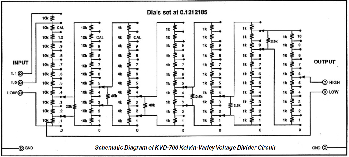

I wouldn't bother with the whole temp control issue. Years ago I wrote an article on building a voltage standard-
http://www.conradhoffman.com/mini_metro_lab.html It's a bit long of tooth, but the concepts still apply today.
Though you can start off with a close tolerance part, IMO it's better to start off with a very stable part, age it a bit, then just measure it on somebodies recently calibrated 6 1/2 digit meter.

« Reply #19 on: January 05, 2013, 03:16:14 am »
I saw your article some time ago and it got me interested in kelvin varley dividers.
After some more research on the web i started searching for a 11 positions 2 deck switch .
At first it took some time before i understand ed that "normal" rotary switches have a index of 30 degrees (didn't know this ...) and because of that i wasted a few hours.

I will make a seven decade kelvin varley divider . just because ... you can .
I still have to do some research about the resistor values that i will use , i also could just use the values of kvd-700:
I also read that the resistors need some burn in time so i should put them in parallel and connect them to my lab power supply and let it run for one or two weeks. After that i need to use the Wheatstone bridge method to select resistors that are closest together.
I will most likley buy a calibrated voltage reference from voltagestandard or geller labs because they are calibrated and can be sent back to be re-calibrated for a few dollar .
I searched a bit on the internet but i didn't find any diy kelvin varley builds so it probably will be hard.

The trick with KVDs is finding good enough resistors to build the top few dividers. That's why you rarely see them with more than 6 or 7 decades. I think the Fluke 720 put adjustments on the resistors, knowing they'd never be good enough without them. I used regular 1% metal films that I selected, but the limitation was soldering them in. Every time you do a solder joint they have a tendency to move a few PPM. Once I got a chain of resistors that were correct, they were fairly stable.
It's worth trying to find some old Julie Research application notes. They made their resistors by winding wire on a multi section plastic bobbin, first one way, then the other, to cancel out inductance. That doesn't work very well because the coupling is bad but's better than nothing. Their real trick was using a very stable wire like Rediohm 800 or similar (can't be soldered, has to be welded) and doing the windings loose.  Tight windings stress the wire and change with temperature. Loose windings are way better. I've made lots of precision resistors, but only for low values. It's much harder to make high values with very long lengths of very fine wire!
On the voltage source, and standard resistors for that matter, the modern thinking is not to worry about adjusting anything to a specific value. It just causes stability problems and wrecks the history. Just make every fixed and get a calibration. Every time you have it calibrated, you add to the history. History is what gives us confidence!
