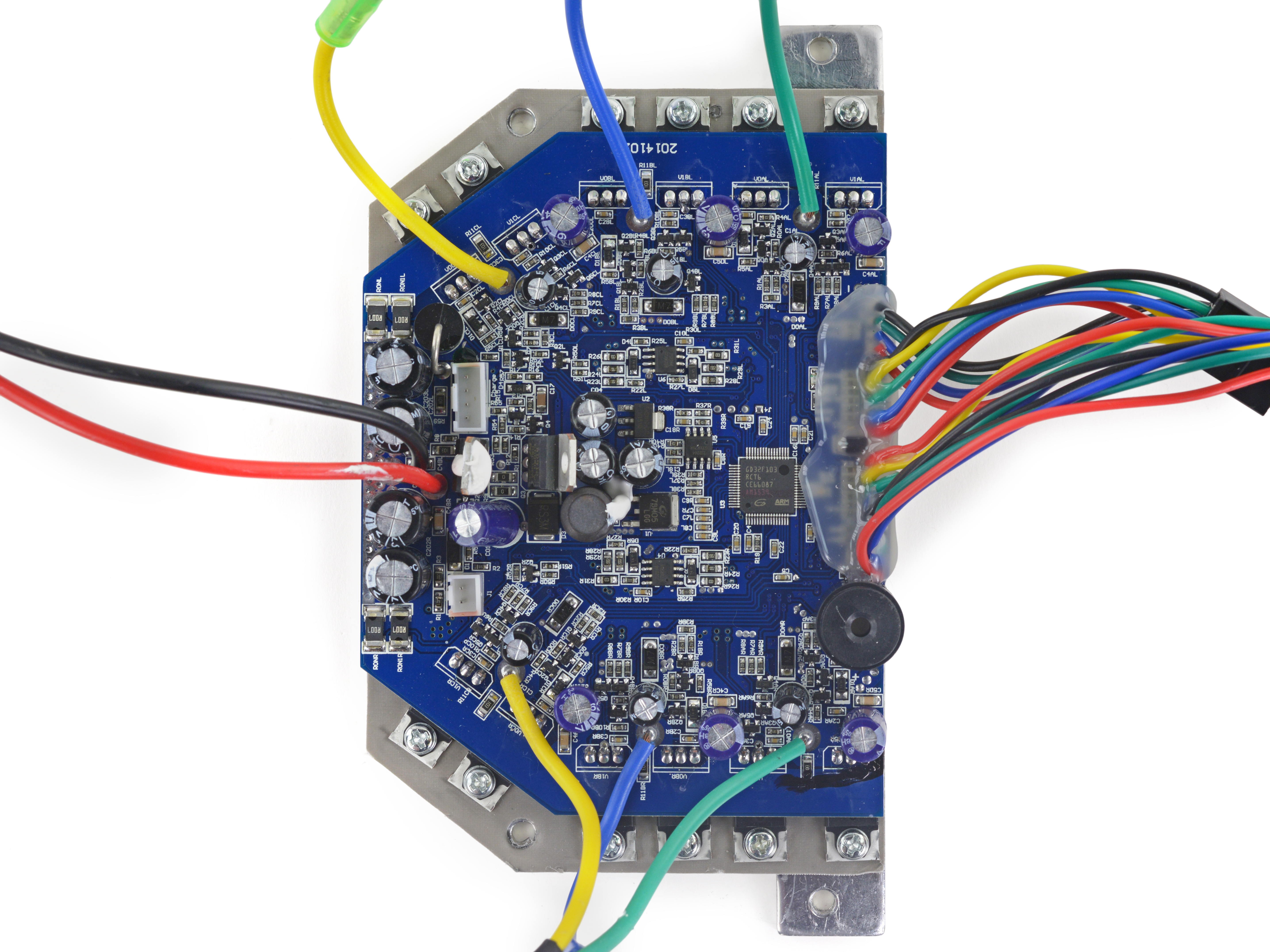

For the cheap Chinese hoverboard PCB, take a look at
https://d3nevzfk7ii3be.cloudfront.net/igi/G1ulQv3mmIFBAUcv
The current sense resistors are below the elcap bank on the left side. Measuring DC link current, after bulk capacitance. Not perfectly optimal (the Kelvin sensing is done wrong as well), but probably does the job well enough despite the flaws.
Yes, if you go back in time enough, you'll find more and more cheap designs without current sense. And they are notorious for blowing up sometimes. Or being more expensive, BOM-wise, than they need to be. But the Chinese have learned, as well.
Because, duh, without current limiting, you need to dimension everything for the stall current. And with high-efficiency motors, stall current is many times more than the desired running current. Which again is something a bit more than (like 2x) the rated nominal current.
By the way, current sense doesn't necessarily need a resistor. Integrated gate drivers (for example, in TI's DRV series I have used) which sense Vds during on time to implement a current-limit based on Rds(on) exist and are very handy. You can't see that on the layout, it works with zero extra components!
Yes, if your particular motor has a stall current of 140A at the full voltage differential (which may be twice the DC bus voltage, if you reverse the motor while running!), then no need to go for 1000A rated MOSFETs. Do proper thermal calculations for 140A, and you'll likely end up with a FET with a front page Id rating of around 300-500A. (By the way, choosing a FET with a bigger front page current rating than your actual current has nothing to do with "safety margins". The front page number is just a wrong number for the job. Use the right numbers and calculate correctly - THEN add safety margin. The better your calculation, the less safety margin you need. Often just 20-30% is enough!)
But since you never ever want to run a motor at its stall current - after all, the iron is likely saturated and it's not providing torque for the current - why spend to create a controller capable of supplying 140A, when you can do, for example, 30-40A much cheaper, while still creating the same actual torque, and protect the motor at the same time. I'm baffled at your massive brute force strategy.
