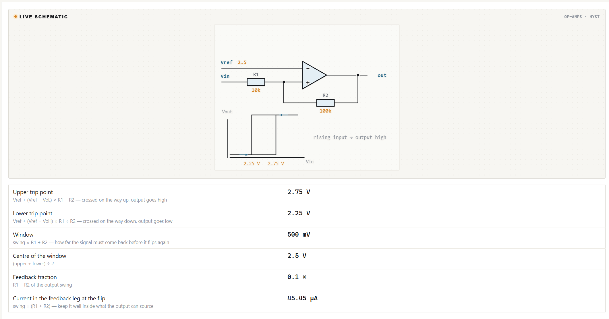

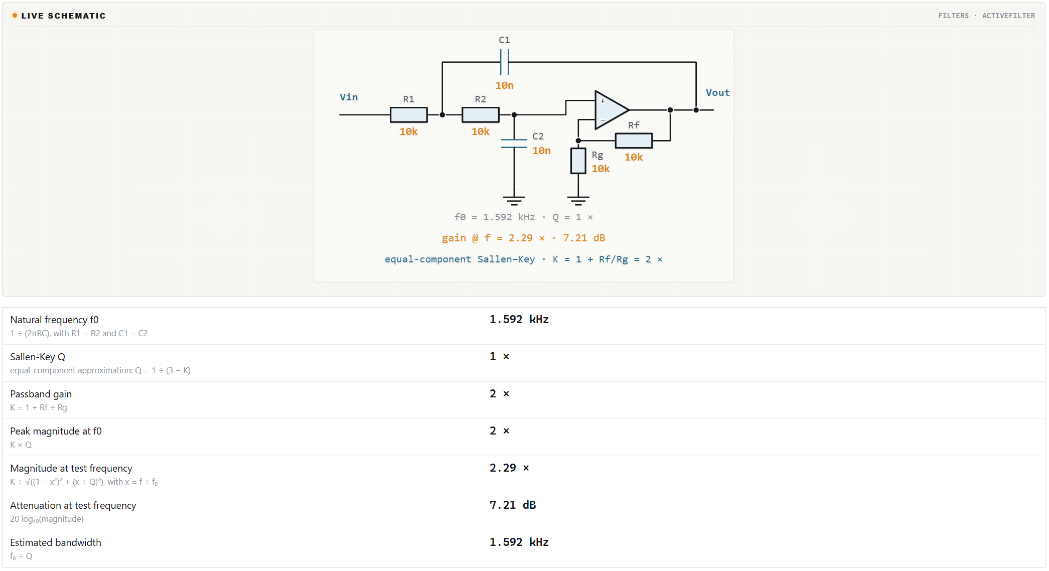

Each one draws the circuit it is describing, and the drawing follows what you type. Change the topology on the synchronous converter page and the schematic rearranges.
Every result says how it was worked out. Under each number is the expression that produced it, and it follows your choices rather than being a fixed caption. The time-constant row reads R × C on an RC filter and L ÷ R on an RL one. The synchronous page assigns hard-switching loss to the high side in a buck and the low side in a boost. Ohm's law names the pair you actually entered and says nothing under the two you typed. 316 of 339 result rows carry one; the rest are values you entered, lookups, verdicts in prose, or the same number in another unit.

Some of the drawings plot behaviour rather than topology — the comparator draws its own hysteresis loop with the two trip points on it:
