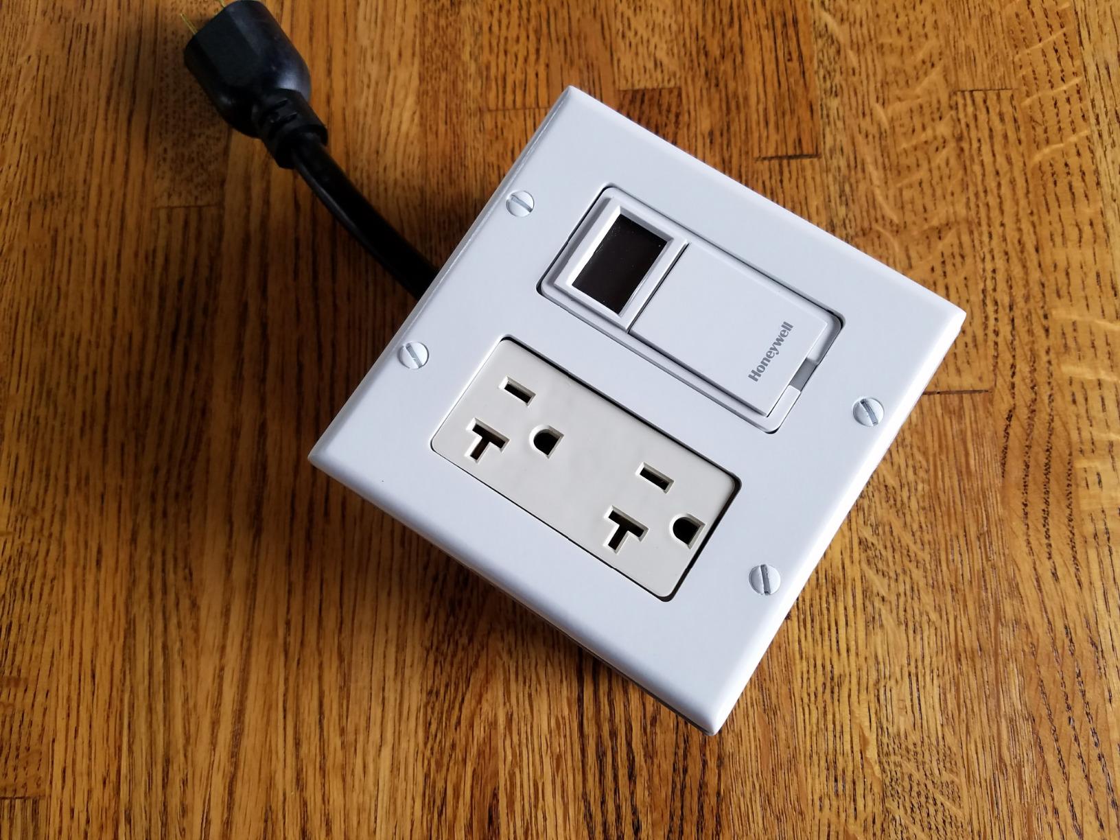

I'd put this and a wall socket in an out door electrical box.
https://www.amazon.com/Honeywell-RPLS730B1000-7-Day-Programmable-Switch/dp/B004SOZHXY
Get an appliance replacement cord.
And make this: https://m.media-amazon.com/images/I/71QzvlwE9PL.jpg
