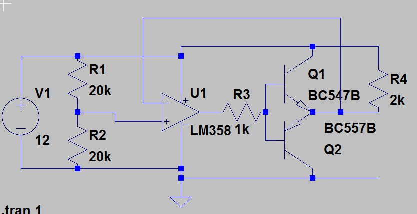

Is that a valid way to create artificial ground from single 12V supply? Or am I forgetting something obvious?
I need to power a few opamps in a simple device powered by a wall-wart. Signals will partially be DC, so no capacitive coupling. I need the virtual ground to be able to both sink and source a few tens of miliamps (actually, to maintain the virtual ground in the middle between GND and +12V). Technically the vrtual ground will be 6V above wall-wart DC potential, but wall-warts are isolated (at least  hope so...) so it should not onterfere with oscilloscope for example.

you dont need the extra transistors for a few milliamps.
opamp in unity gain woll work. they can handle 10 to 15 mA without problems if you use something like a TS921 they can do 50 to 80 mA

Made a similar thread while ago here -> Question on op-amp current capability for making V-Ground circuit
It just works using jelly bean LM358 without transistors, and also I used the quad LM324 parallel for beefier current, there is a link in there about using multiple op-amps as well.

What are the 1n4148 for?

http://www.ti.com/product/tle2426-q1
If you dont mind the non-jellybean part, its a 1 and done solution.  Good for 20mA, 40V input, stable over the whole current range with 1uF on the output.
I'm sure they are there to provide a discharge path for the caps into +5V when the circuit is powered down.
Sure, but with room for improvement.
I would simply use an audio opamp (TDA2030) configured as a follower.
Yep, thats correct and also quoting ciccio's post regarding those diodes.
The diode will discharge the capacitor versus the supply source (9V) at switching off, preventing a damage to the op-amp input when switching off (without it  the input may momentarily be at an higher voltage than the supply pin). An 1N4148 will be OK.
Sometimes a diode from this junction to V+ will help at start-up

Or one could use a TI TLE2426 rail splitter. Rated to +/- 20 mA.
