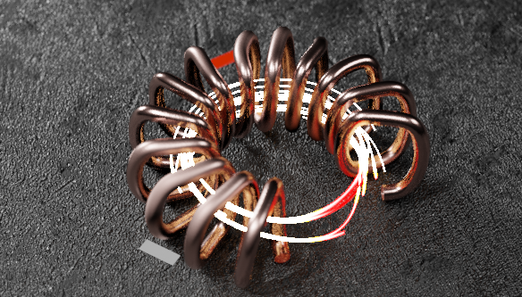

Hi, I would like to share my project "ElectroMag Nodes", it is a first attempt at making a basic electromagnetic solver in Blender using geometry nodes.
With Electromag Nodes allows to take advantage of Blender's fast and procedural workflow to create complex shapes and geometries. You will be able design inductors, coils and magnetics and visualise their magnetic fields and calculate their inductance. You will also be able study electrostatics, visualise electrics fields of objects, calculate potentials, surface charge density and capacitance. These set of nodes will be useful especially for students to better understand electromagnetics, which can be a difficult topic to study and learn. It will also be useful for electrical engineers who design circuit boards, and components.
This initial version of ElectroMag Nodes only supports electrostatics and magnetostatics, it is by no means yet a replacement to existing professional tool. The magnetostatics solvers solve Biot-Savart law for line currents, and the electrostatics solvers calculate the electric field and voltage assuming surface charge distribution only.

It looks spectacular, but are the results valid?
For example If I look at the two toroidal inductors in the induction heater, I find it hard to imagine the magnetic field in the toroids stop in the part there is no wire around it.
As it is a "first attempt", I imagine there are just no calculations about the magnetic permeability of the core materials (yet?) in the simulations?

So I have done comparisons with FastHenry and FEMM for inductances, which would indicate that the magnetic fields are correct. You can see my comparison in this guide video https://youtu.be/aZRNXmWNqj8?t=322
someone on Twitter also commented on the fact that the magnetic field in the toroids seem to be non-existent in area where there are no windings. This is mainly due to the visualisation settings I had at the time, I just happened to make the fields that are week more transparent such that they become invisible. There is definitely a magnetic field in the area where there are no turns, here is another illustration of the toroid https://pbs.twimg.com/media/F2DNsf1b0AEO23j?format=png
