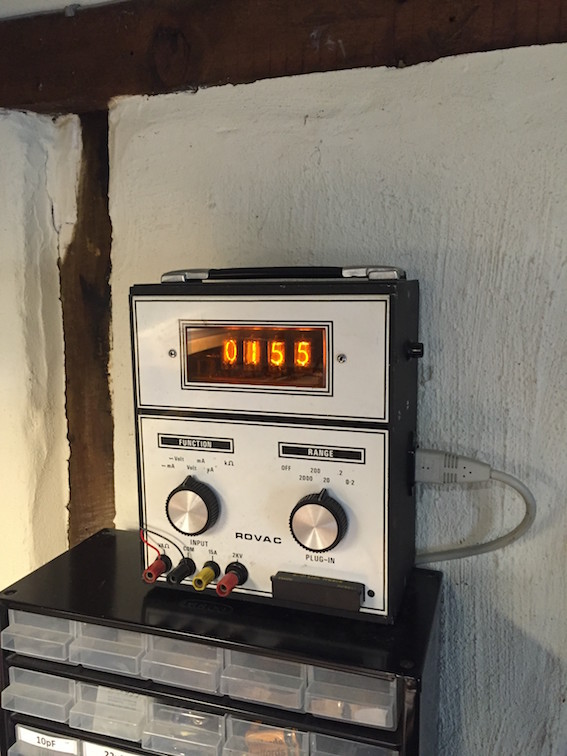

I did something similar, see this thread: https://www.eevblog.com/forum/projects/a-digital-analog-digital-nixie-clock/
Still keeping good time!

Very nice. What happens when you switch the time to the 2000 range? ^-^
Offline ynfo
  • Posts: 20
Re: 1970's Nixie Tube panel meter to clock
« Reply #10 on: February 03, 2017, 09:26:23 am »
Just tried it a moment ago:
Range    Display
20         09.18
200       009.2
2000     0010.
