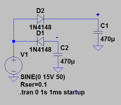

I have the following schematic on breadboard:
Where V1 is 230/12V 3VA transformer, that outputs 15VAC RMS no load.
C1/C2 are vishay 470uF 50V caps.
D1/D2 are just jellybean diodes
The issue I'm having is that the voltage is not equal on the caps, for the positive cap (C1) I measure about 20V no load and with 240ohm load I measure about 14V, and for the negative cap (C2) I'm measuring about 7.50V no load and with 240ohm load I measure about 6V~.
Why is it so?

Swap the diodes.
Does the problem move?
Yes -> bad diode.
No  -> bad cap.

Fixed! Bad diodes.
thanks!

The extremely high unlimited inrush current blew up the little low power diodes. Why not use rectifier diodes made to do what you are doing? 1N4001.

I'm using 1N4007 anyways, I might have shorted out something that killed the diodes, but it fixed now anyways.
