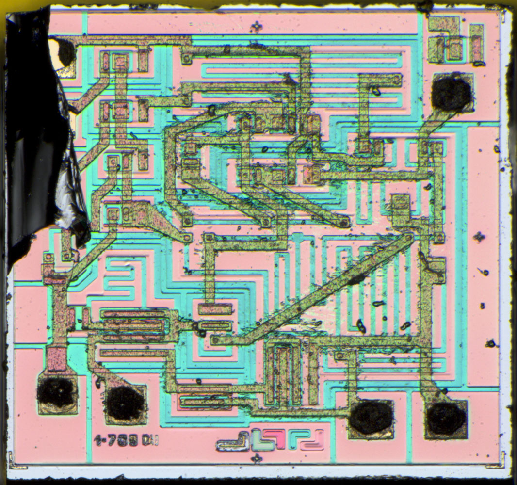

Mikroelektronika Botevgrad 1УO709 - 1UO709, another 709-opamp.
Unfortunately the die was damaged a little.
Nevertheless we can clearly see that it is very similar to the LM709.
https://www.richis-lab.de/Opamp21.htm

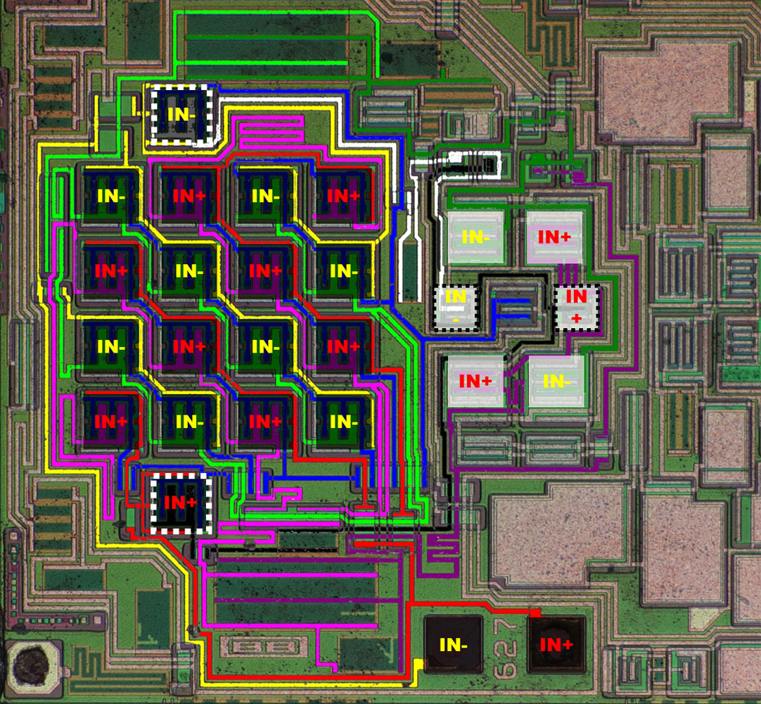

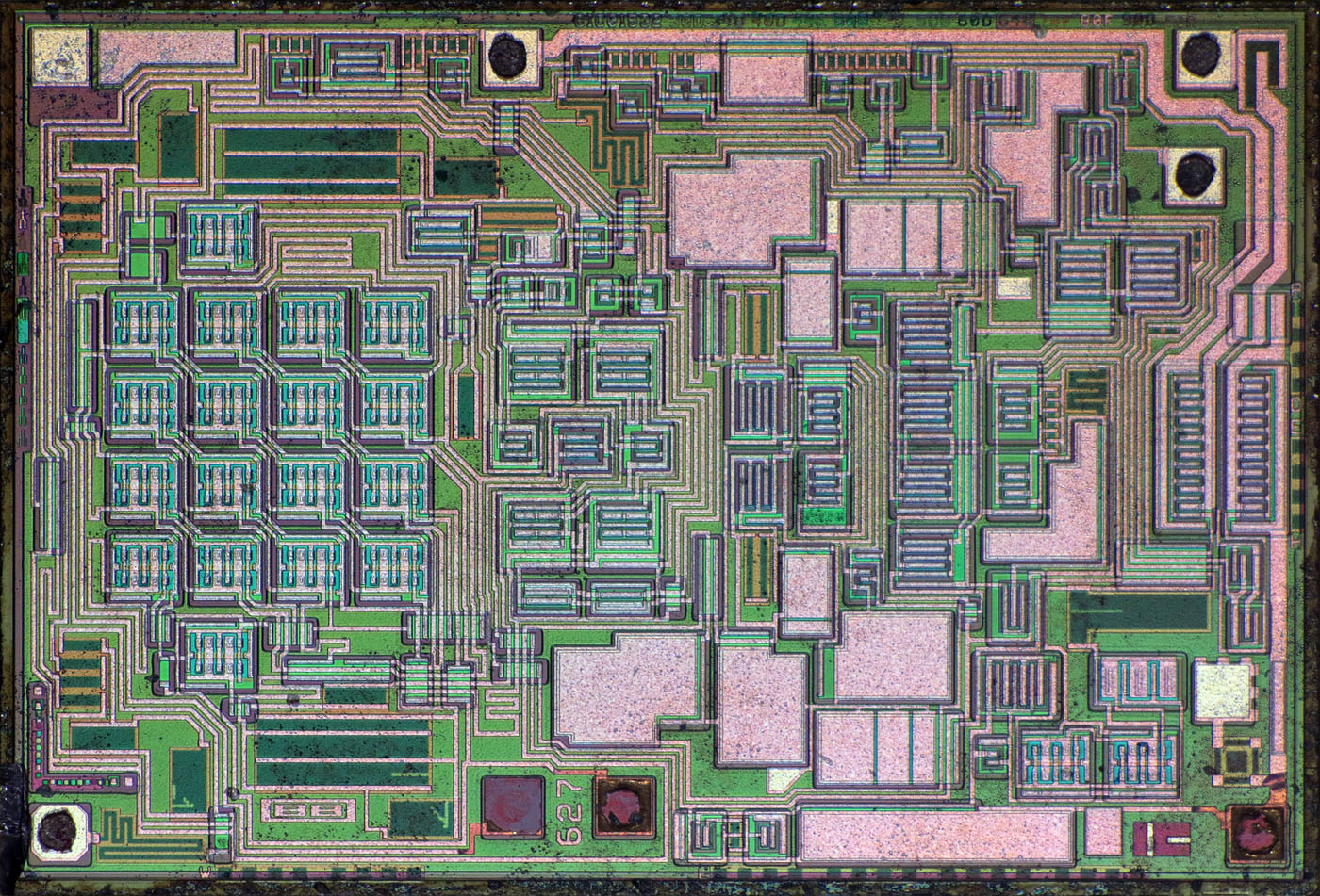

Let´s take a closer look into a OPA627!  8)
The die is quite big (2,9mm x 2,0mm).
The most interesting part is the input stage. There is a matrix of 2x8 transistors forming the two input transistors. Burr-Brown tried to match the metal traces and the silicon traces as good as possible. In the upper left corner there are two green underpasses which are "very" long and wide just to match the underpasses in the lower right corner.
Around the input transistors there are the tuned resistors for input-offset tuning and the current mirror emitter resistors which travel quite a long way to get to the left edge of the die. I assume they wanted to bring some distance between the transistors and the edge of the die and then decided to fill the empty room with the current mirror resistors.
On the right side there are four transistors generating the two cascode transistors of the input stage. The current sink is placed in the center for most equal temperatures.
Above and below the input transistor matrix there are two more input-J-FETs which are connected to two more transistors in the cascode stage.
The circuit is a bit different to the schematic in the datasheet. I dont´really understand what is the purpose of the path Q17/Q18-Q6/Q7...  :-// @magic: any ideas?  ;)
More pictures here:
https://www.richis-lab.de/Opamp22.htm
Could that be transconductance reduction of the input stage?  It is not in the form that I usually see and it is almost always left off of published schematics.
That's possible.  :-+ ...an interesting way of transconductance reduction. Probably a very clever way for the OPA627.  :-//

If the schematic is to be believed, these are P channel JFETs like in TL071 so you have drawn them upside down. The sources should be "up", the drains should be "down".
Then it looks like Q17,Q18 are simply source followers and Q6,Q7 diodes shift the voltage one Vbe up and drive bases of Q2~Q5. Input stage current is about 8x the current through Q6,Q7 and Q17,Q18, which is set by that current source at the positive rail.
Q8 and Q1 plus something between them (let me guess: a string of diodes or resistor) bootstrap the drains of all those JFETs.
BTW, zeptobars has a higher resolution image.
https://zeptobars.com/en/read/BB-TI-OPA627-opamp-genuine-fake

Thanks!  :) You are right, the JFETs were rotated. And the numbers were also confusing. I changed that:
Is it correct to call J1-J8/Q2-Q3 a cascode?
I didn´t check the parts between Q8 and Q1 but that should be some kind ob voltage drop.  :-+
That´s an interesting input stage! But why did they double the inputs? Why J17/J18 and Q6/Q7?
I know zeptobars had already pictures but I had to take a look into this one because the owner wanted to know whether it´s genuine.  :-/O

Not sure. Q6 seems to have ⅛ emitter area of Q2+Q3 and J17 is ⅛ of J1~J8 and the resistors are probably in 8:1 ratio too. These two current paths operate almost identically. The only difference I see so far is that Q6 and J17 current is affected only by Early effect in the current source, but Q2+Q3 and J1~J8 current is affected also by Early effect in Q2+Q3.
Is this difference between J17 and J1~J8 operating current significant? Maybe for THD, or maybe not. Maybe this configuration only plays some role in preventing phase reversal. Maybe they didn't want to do a thermally balanced layout for Q6. Maybe it avoids needing to laser trim R7. Maybe simulation would show something.
BTW, if we connect Q6 emitter to Q2+Q3, we get a configuration analogous to inverted LM101A.

Thanks for your interpretation!
A mysterious input stage...  :-/O
Yes, I was looking at it completely wrong.  Q2 through Q7 are the cascode transistors for J1 through J8 and J9 through J16.
J17 and J18 control the base voltage of the cascodes so that they follow the input JFETs making Vds is constant.  The base connection between Q6 and Q8 receives a constant current from the positive supply which creates a constant voltage across R7 and R8.  Q6 and Q7 are connected as diodes so that their Vbe compensates the Vbe of the cascode transistors.
A cascode configuration is common with super-beta input stages because the Vce breakdown voltage is very low, only like 3 to 5 volts.  Sometimes it is used to increase the differential input voltage range by preventing breakdown of base-emitter junction of the input transistors.  I do not know why it would be used with JFETs unless modulation with changing drain voltage was a significant error term, which it could be.  Or maybe these JFETs have a limited maximum Vds?
The following users thanked this post: PartialDischarge, Noopy
Online NoopyTopic starter
  • Posts: 1938
    • Richis-Lab
Re: Opamps - Die pictures
« Reply #96 on: November 10, 2020, 05:20:55 pm »
That is convincing, thanks!  :-+

I wonder what advantages this topology would have in a discrete design, with JFET (or bipolar) followers driving common-base bipolars to make a differential input stage.  Noise will be higher.
Incidentally, some people object to calling it a cascode and consider it a cascade (?) when it is the emitter or source of the input transistor driving the emitter or source of a cascode transistor and the transconductance is controlled by the emitter and source resistances plus any added resistance as in this case.
If you squint a little, then it is a differential pair made up of complementary transistors and in this case, completely different types of transistors.  I have run across this complementary differential pair before in high frequency and high frequency high voltage circuits.
