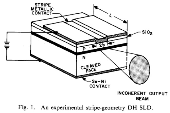

LASER is supposed to produce coherent light.
Fig.1 reads "incoherent output beam".
Offline NoopyTopic starter
  • Posts: 2400
    • Richis-Lab
Re: Optoelectronics - die pictures
« Reply #46 on: October 28, 2022, 05:16:04 pm »
The output light is incoherent but the initial source can be coherent. It is transformed in the phosphor.
Offline RoGeorge
  • Posts: 8470
« Reply #47 on: October 28, 2022, 05:36:26 pm »
From this image I understand the beam is not coherent, and it looks like that's the beam before entering into the phosphorus.  So the SLD (Super Luminiscent Diode) LED is not a L.A.S.E.R. device.  Isn't that so?
« Last Edit: October 28, 2022, 05:47:42 pm by RoGeorge »

You are right, a SLD gives incoherent light.
But in every datasheet of these Kyocera LaserLights you just find the word laser. There is sometimes the acronym SLD but that doesn't mean Superluminescent Diode but Soraa Laser Diode Inc., a company that was bought by Kyocera (and again "Laser").
I somehow wanted to believe they use Superluminescent Diodes but it looks like that are Laser diodes. There is no hint that they use SLD.  :-//
The coherence length of most lasers is very small, so the light is no longer coherent where it gets used.  Special steps have to be taken to get a useful coherence length, like special construction and temperature control.  For instance you cannot make an interferometer from any common laser source.
Laser diodes routinely have a coherence length of millimeters.
