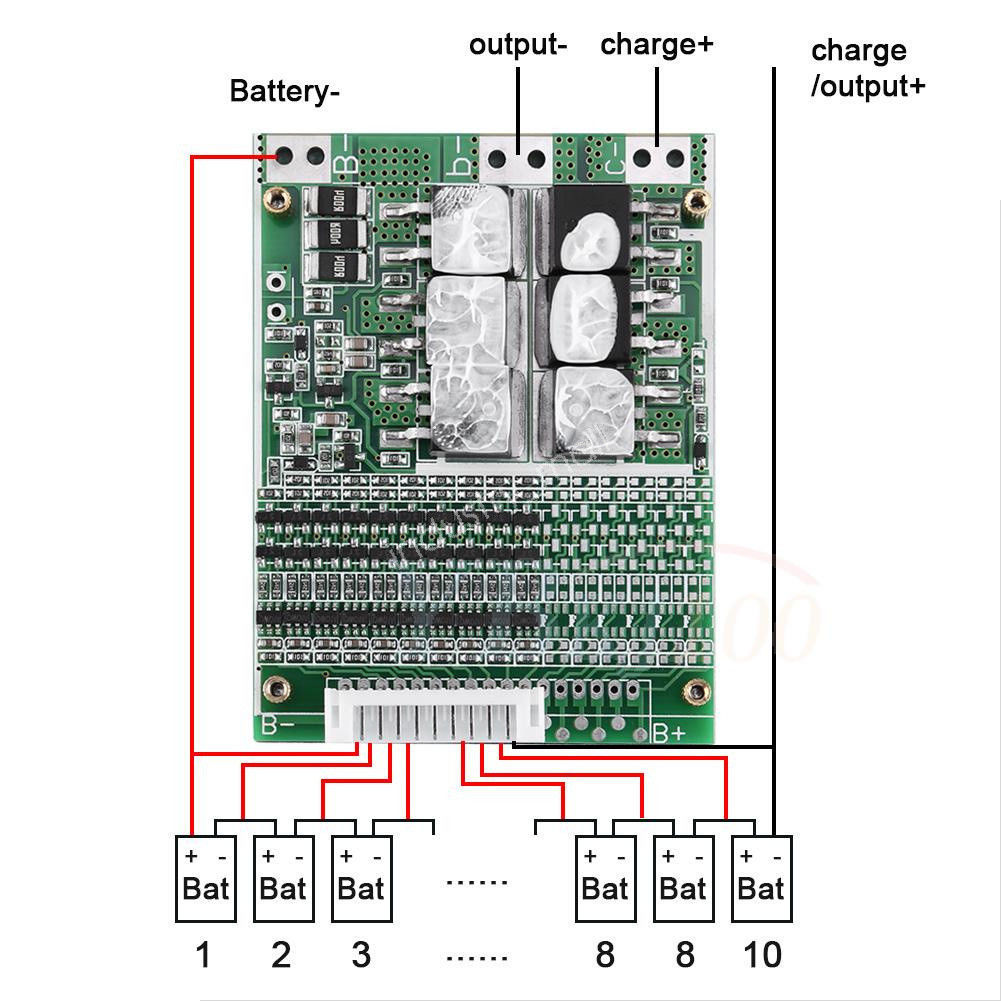

Ok, instead of rev eng I will remove completely that BMS and go with these cheap cheap chinesium toys
BMS, I hope 20A cont./30A peak are enough:
eBay auction: #263901952562

I think I will connect the BMS like this:
cristal clear, thank God there are just + and - in a battery...
How many time they put a - instead of a +? :horse:  |O
EDIT: This makes more sense:
« Last Edit: October 09, 2018, 11:59:06 am by zucca »

Well I just bought a cheap ass 10S Li Ion chinesium BMS as stated before. How can I test it if it is crap or not?
There is no way to test that reliably, easily. Really useful testing takes a lot of time and resources.
OTOH, quick, basic testing gives you a initial go/no-go quickly. For this,
Any other suggestions?
I suggest using in actual environment, in the bike, and carrying a multimeter with you to do some verifications. Especially look at the signals when charging. You can always set the charger CV setpoint to slightly higher than normal, during controlled testing, to see if the BMS can turn the charger off on HVC event. Then, bring the CV setting back so now you have a layer of safety - if the BMS fails, the charger still limits the voltage like it would in a non-BMS system. The only way the BMS can now fuck this up is by stuck-on balancer causing a massive imbalance.
The effect of LVC, you can verify while driving the pack empty. At some point, it just suddenly stops. If it's getting sluggish instead, take your multimeter and verify the cells are still in balance, even on the bottom. With modern high-quality cells, capacity matching is good enough that cells tend to be fairly well in balance on both top and bottom. And if the cells are in balance on bottom, the risk of low-voltage damaging them by driving is small, even if the cell-level LVC fails to work - it will get so sluggish that you just stop. So better watch the balance when near empty, that will give you the warning sign of which cells to watch more closely.
But at some point, it's just OK to follow the cargo cult and not worry too much. If the cells are of proper quality, the risks are fairly small.
The Chinese BMS design is probably not any worse, and is likely to be much better than a typical over-engineered Western amazingly novel super BMS.
