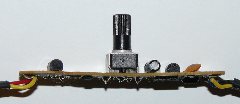

There's a thread on SPCR about this, with a link to this Maxim app note:
http://www.maxim-ic.com/app-notes/index.mvp/id/3149
Plus pictures of the Manoxia opened up:
http://www.silentpcreview.com/forums/viewtopic.php?t=52555
Looks like it's really cheaply made.  Soldering is terrible.

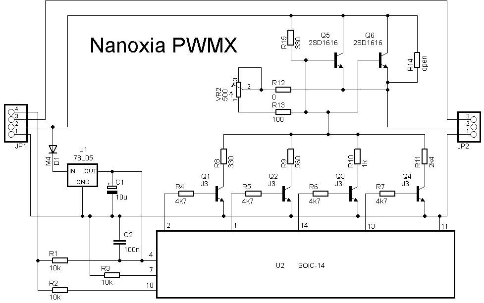

I think it is rather poor design. The microcontroller controls a crude 4 bit DAC, so no more than 16 speeds - maybe less. The transistors may not share current equally (no emitter resistors). Linear operation is inefficient and will drop about 1 volt at max speed.

As soon it arrives , I will verify the schematic.

« Reply #81 on: November 09, 2010, 06:12:59 am »

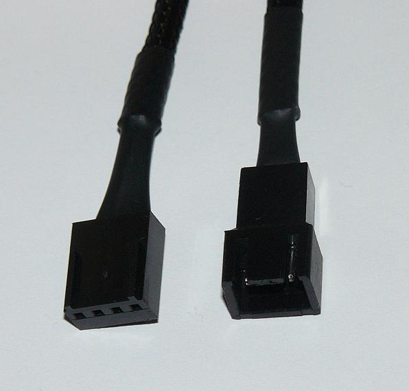

Build quality is typical for a low cost product.
PCB is thin and slightly warped. It does not appear to be FR4.
Wave soldered (not reflow), flux residue on board.
Some flux on top side too. Pot is smooth and tight.
Connectors are keyed. Heat shrink, but no strain relief.
« Last Edit: November 18, 2010, 04:31:26 pm by oPossum »

Q1 to Q4 are NPN as shown in the schematic. They may be S9013 or MMS9013. There is no standard for marking SOT-23 package components.
Q5 and Q6 carry current to the fan. I estimate they will be warm at 100 mA, hot at 200 mA and dead at 400 mA (continuous @ 6V to fan).
« Last Edit: November 10, 2010, 07:09:27 am by oPossum »

The fan will draw less current at lower voltage, so it may be OK as-is. Try it and see what happens. If it blows up then mod it.
A CFP (Sziklai) output using a PNP transistor (Q6) in a TO-220 package should be good for 2A or more with a small heat sink.
Modified schematic...
« Last Edit: November 18, 2010, 04:31:51 pm by oPossum »

In the primary design Q5+Q6 works in parallel .
In the last  the Q5 drivers the larger Q6.  ;)

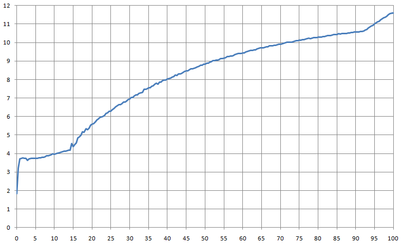

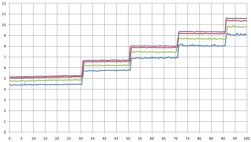

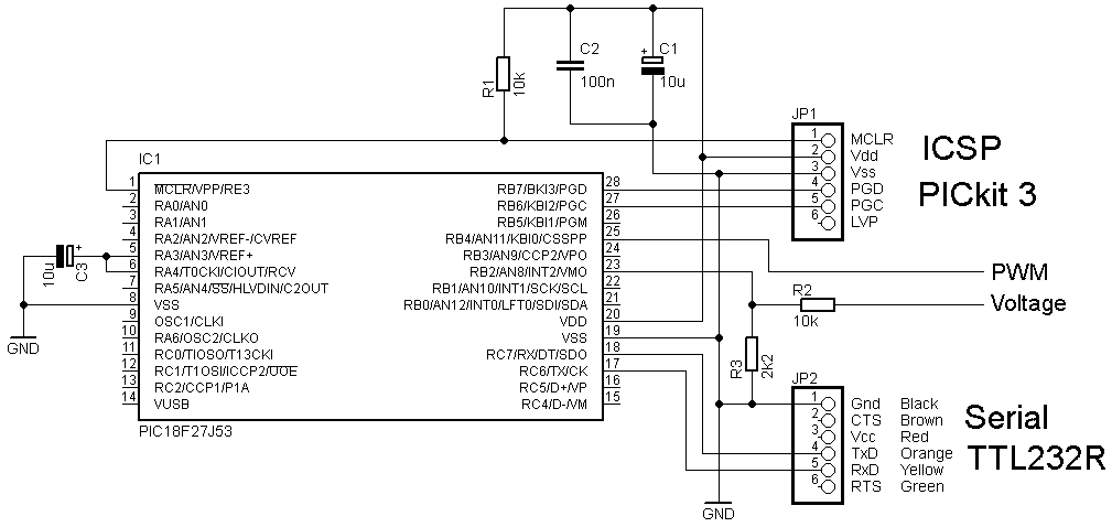

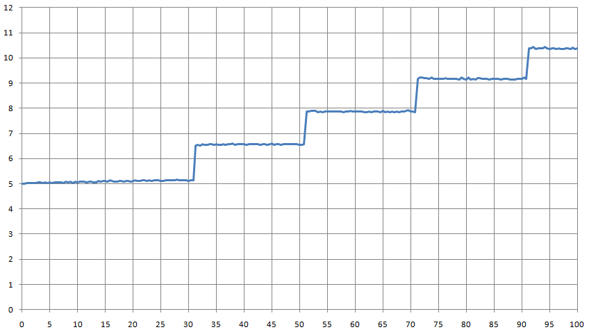

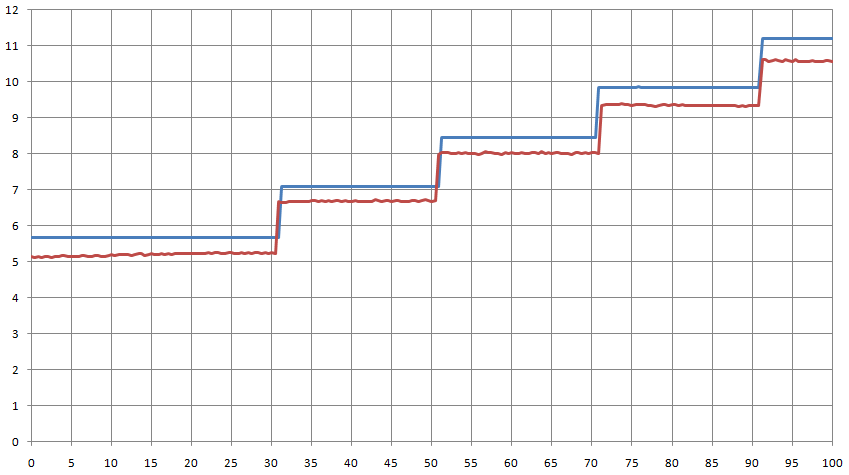

I built a circuit to characterize PWM to voltage converters.
Schematic
Source code, schematic, and captured data

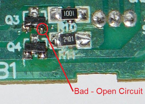

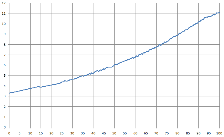

The first test showed that the Nanoxia PWMX was not working correctly. The problem was bad solder on the emitter of Q3.
Plot showing Voltage (left axis) vs. PWM % (bottom axis).
After fix. Pot set to max fan speed (full CW).
Pot set to middle of rotation.
Pot set to min fan speed (full CCW).
Pot set to middle voltage.
Comparison. Max (violet), middle rotation (red), middle voltage (green), min (blue).
Comparison of output with no fan (blue) and fan that draws 220 mA @ 12 volts (red).
Noise in the plots is due to fan commutation. There is no noise with no fan connected.
« Last Edit: November 18, 2010, 04:34:25 pm by oPossum »

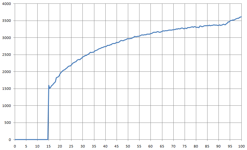

Tests at 20, 25 and 30 kHz. It measures both the on and off duration of the pulse. Very good.
« Last Edit: November 18, 2010, 04:35:08 pm by oPossum »

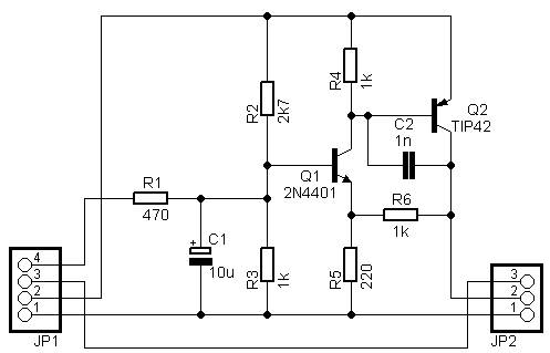

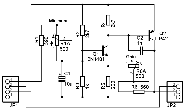

I built this on a breadboard...
Tested with 220 mA fan. Results...
Note: Max current with Q2 2N4403 or similar is ~300 mA. Use larger Darlington PNP like TIP125 for more current.
Use R5 if fan must run below 20% PWM.
« Last Edit: November 18, 2010, 04:37:28 pm by oPossum »

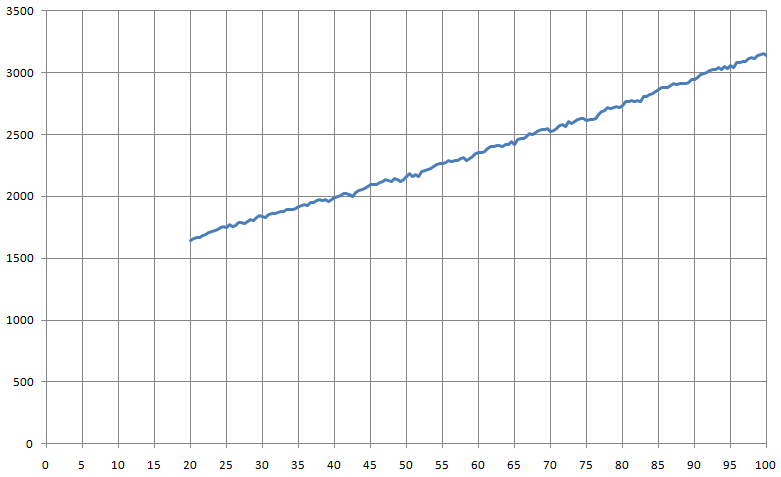

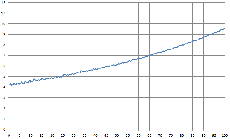

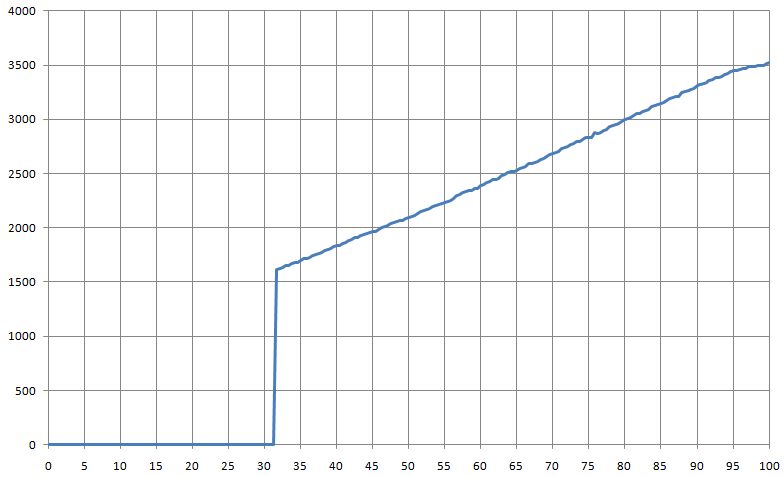

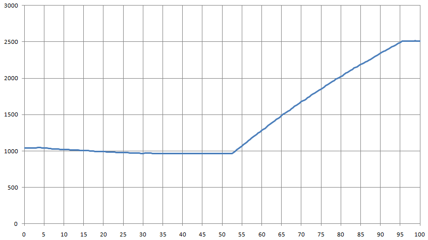

Fan runs at 25%, but tach does not work until 32%
Increase R1 to move start of curve up (so fan will run at lower PWM %). Decrease R6 to move entire curve down (so max speed is reduced).

« Reply #95 on: November 18, 2010, 09:28:25 pm »
PWM % vs RPM for genuine Intel 4 wire fan supplied with boxed Pentium 4 LGA775

Adjustable version.
