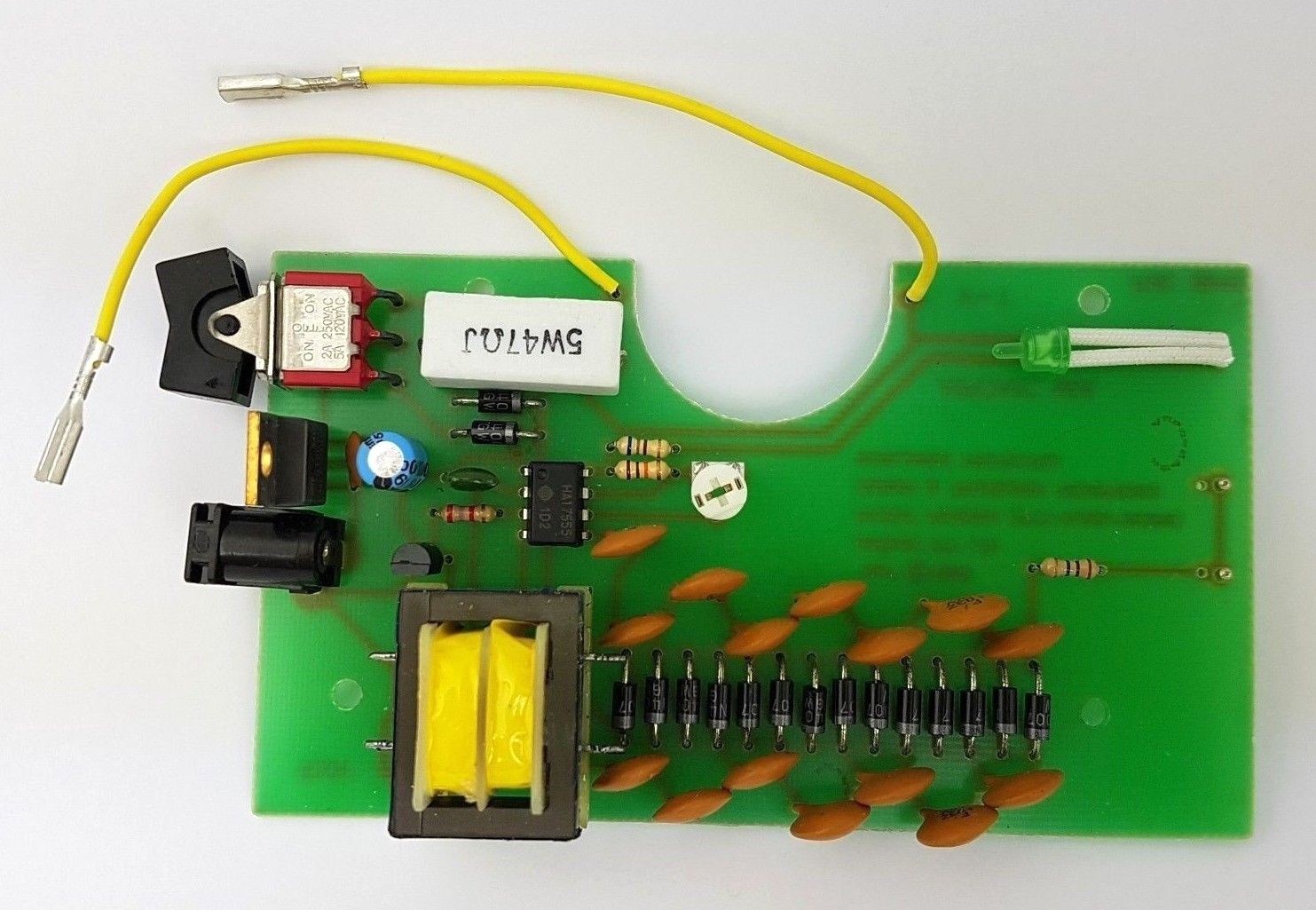

  • Posts: 7375
Re: PCB for Crockcroft-Walton Multiplier available?
« Reply #2 on: March 03, 2019, 12:39:30 pm »
Random find I came across some time ago might do what you need with a bit of a mod. eBay auction: #273740937131 or chase up ionizers might get you what you want.
