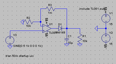

Hi everyone,
I'm just trying to set a bare bone peak detector.
I've tried multiple circuits, but can't get it to work as expected.
The last one I tried is the one presented in the picture.  You will see the circuit on the first picture, then the expected result.
I don't come close to what's on the pic. For instance, the output doesn't follow whatsoever, simply dead, nada.  I changed, tested the diode numerous times, I tried with a TL072 and a TL074.  No luck whatsoever.
If possible, could someone give it a try, even with a u741, just to see if that works and if it does, I'd greatly appreciate if you could post screenshots from the oscilloscope and even of the breadboard, so that I "see" where I goofed.
Thanks for your help.
PS : The results shown on the pic are based on a +/-15 V supply and a 5Vpp input signal.  I just want to use that peak detector for signals roughly from 1Hz to 150-200KHz.  If you have better solution(s) than the one presented here, by all means, feel free to suggest.
Thank you for your help.

LTSpice says it works. Moreover, I've used such a circuit many times and it works. Albo, you should use low offset fast comparator for that to achieve best results.
Either circuit labs simulator sucks or you set it up wrong.

TL074 is way too slow to do peak detection on a 200kHz signal. Whenever the peaks occur in your signal, the output has to slew all the way from saturation at the negative rail to the peak value of the signal, and then charge the capacitor. It's a much more demanding application than simply amplifying a 200kHz signal linearly.
The critical parameter to look for when considering an op-amp for this type of circuit is the slew rate. The figure you'll most often see quoted for a device is its bandwidth, or more specifically, the gain-bandwidth product. Often, though these figures are rather optimistic, and only really apply for very low level signals. The rate of change of the output voltage depends not just on the frequency of the signal but also its amplitude, and here you're working with a very high amplitude signal: 15V (the magnitude of the negative supply voltage) plus the peak voltage of the signal. That's the range over which the output of the op-amp has to swing.
At the opposite end of your range, if you want the circuit to work down to a few Hz, then you'll need a large capacitor. This isn't necessarily a major problem, but it will mean that your op-amp will take many cycles to charge it up... you won't be measuring instantaneous peaks, more like a long-term average of the positive extent of your signal.
First thing to do IMHO is find why your circuit isn't working at all. Set it to a nice low frequency - a few hundred Hz will do - and check it's working as expected. Post your actual measurements on each pin of the op-amp if it's still misbehaving. Then, ramp up the frequency and observe the output of the op-amp, you'll soon see the problem with using it at higher speeds.
You don't need the pull-down on the -ve input of the op-amp, by the way - it's in parallel with the resistor you already have across the output capacitor.

The 10 uF capacitor is to large to charge in on time by the 081.
Try someting in the 1 to 10 nF range.
Put a diode between the - input of the opamp and the output of the output with the kathode connected to the output.
This wil solve som of the slew rate problems.

You can get rid of RL.  The cap will drain in a quarter of a second the way it is set up now.

Please don't tell me that you actually have a 0 ohm resistor in there...

You were right, the TL07x wasn't up for the task.  I have to conclude that the given circuit was simply for study and explain the concept.  Not taking in account the slew rate to start with, was a bad start.  Knowing that the slew rate was important, I took for granted that the circuit was already tested with physical components, but obviously, this is not the case.

Yes, I got rid of RL which was in parallel with the capacitor.  As for the feedback resistor, like the simulation picture was stating, it was there to play with and potentialy adjust the gain.
Anyhow, with the TL07x I tried, regardless of the gain, that wasn't doing any good, simply because that type of opamp is not suited for this kind of job.

To make a long story short, I've been successful at having a working circuit.
So the first thing that was changed is the opamp, naturally.  Perhaps I went to an extreme, nevertheless, it works and this is what is important.  I'm using now an EL2244C having a modest 200 to 325 V/us slew rate.  So changing the opamp, changing the supply from +/-15V to +-5V and limiting the input to roughly 2.5-3Vpp, I'm now able to have a fairly precise peak reading above 200KHz.  In fact, I've tested it up to 6MHz and had a reading within 3% of the expected value.
There is no more RL, there is no feedback resistor, so I have a follower equivalent, the capacitor is a 10nF and finaly, I have a 500k resistor in serie with a 1M pot connected between the inverting input and the ground.
BTW, with the TL07x, I had a 50% reading error at 10KHz, so for that purpose, this opamp is simply useless.
