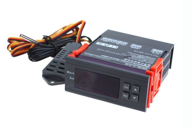

Hi to all,
I recently bought a small humidity digital controller WH8040 , to detect the humidity in the air and start an air extractor faster if it's too wet.
the output of th controller is a small 12v relay, and it goes to a bigger relay 220v 10A, which them switch the 160w ac motor to the high speed.
the problem is that when then relay gets on, the motor seems to drop the ac power supply, so that the digital controller gets off and switches off the relay, then start on and again some 10-20 times then after only the high speed is started.
there is no problem when the relay goes from on to off to the low speed again.
is there any way to solve this problem in a simple way ?
thanks.

If i read this correctly , the controller turns off ... when the motor relay turns on ... Correct ?
I'd say it's the psu in the humidiy controller that is lousy.
1: Try to feed the motor (230v relay) from another outlet than the controller psu.
     Or at least use a separate set of wires.
2: Put a beefy cap inside the controller psu on the low voltage side
/Bingo

1/ quite not possible, the air extractor is far from any outlet, there is only one long wire 1.6mm2 that goes to it and that powers the controller and the motor.
2/ the filter cap inside is a 1000uF 25v, there is a 220v to 12v transformer, and a 7805 regulator (smd version) - I soldered a second 1000uF in parallel and the problem is the same.

It seems unlikely that the motor could drop the voltage enough to affect the controller, even if the motor had a heavy start up current surge. I think it is more likely you have some interference that is upsetting the controller electronics.
You may need to include some kind of noise filtering, like perhaps putting ferrite beads on appropriate wires.
