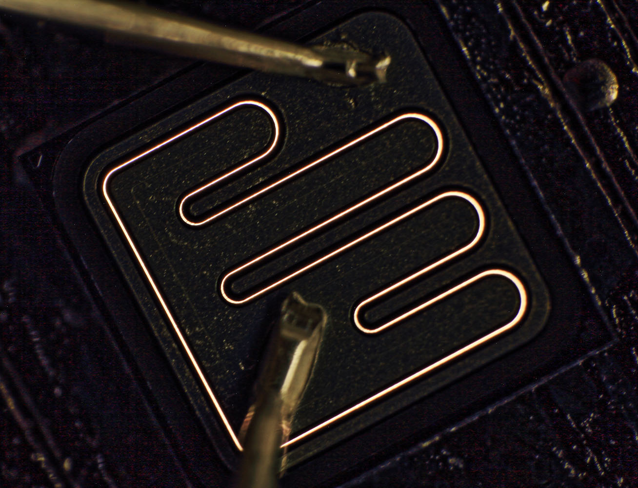

Hi all,
I did some pictures of a Sanken-Transistor (2SC2922):
https://www.richis-lab.de/2SC2922.htm
It seems that the transistor consists of a lot of small transistors connected in parallel:
But how does this work? Paralleling bipolar transistors (without resistors at the emitters) leads to more current for the hottest transistor and so to failure of this transistor. You know what I mean.
Can anyone explain why the engineers were able to connect these transistors in parallel? Or is there a misunderstanding on my side?
Greeting,
Richard

Since the transistors are on the same die they are largely the same. However hotspots will develop and there is a distinct difference between transistors made for switching and audio applications. The former have a very small DC SOA.

My guess is they rely on 1) good match between smaller bjts because they are on the same die 2) thermal coupling between bjts.

rf power transistors have been made this way for years,a lot of times they dont totaly fail just several elements,ie transistors on the die,leading to reduced output.

I don't know about this one, but some have had small emitter resistors included on the die.  But as far as I know most depend primarily on the similarity of all of these transistors that are very close on the same die.

This transistor has been described as a Ring Emitter Transistor:
https://www.diyaudio.com/forums/solid-state/53508-skinny-sanken-2sa1216-epitaxials.html
Sanken's 2SA1216, and its counterpart , the 2SC2922, are ring-emitter transistors.
They also used to be called multi-emitter devices.
Sanken also produces the 2SA1215 and 2SC2921, 150 watt versions.
Nowadays the planar epitaxial technique is solely connected to Sanken.
Sanken produces a great number of other planar epitaxial devices in MT200, e.g. the 2SA1494/2SC3858.
Toshiba produced ring-emitter devices for a relative short period: the 2SA1095 and 2SC2565.
Simply put, a ring-emitter device consists of a great number of transistors on 1 die.
Which translates in a large SOA with an unusual curving, and a very high bandwidth.
The 1216/2922 have a 40 MHz bandwidth, the 1215/2921 do 50 MHZ.
Toshiba's 150 watt 2SA1095/2SC2565 devices even higher at 60 MHz.
High bandwidth translates in high speed, in return this requires less feedback correction.
Less feedback is favorable for low TIM distortion.
Ring-emitter's have a high Hfe, which reduces the current capability of the driver devices, and consequently less current gain from the front end of the amplifier.
Fujitsu described their Ring Emitter Transistors as "constructed with mulitple emitters connected through diffused ballast resistors which provide uniform current density".
There may be diffused ballast resistors there that are not visible.

Consider a finite die on an ideal heatsink.  Consider the sub-transistors to be perfectly matched, evenly distributed over the surface, and operating at some load power.
The key insight is this: the transistors in the center are surrounded by other transistors, while those at the edge are open to one side.
Silicon has finite thermal conductivity, so there will be a difference in temperature rise over the die, with a hot spot in the middle.
This is still missing one more bit of info, actually I think -- the transistors cannot run right up to the edge of the die, there must be some buffer space there for dicing and guard rings.  This makes a ring of silicon around the edge which is not dissipating power, but is thermally conductive, thus lowering the temperature around the edge.
This could be mitigated by placing cells slightly more densely around the periphery, or with extra emitter resistance of course.  Preferably with PTC, though I doubt there's anything readily available (i.e., doped or poly-Si, or aluminum metallization, and that's about it..) that has quite a strong enough tempco to compensate Vbe.
The initial or low-power hot spotting in this scenario is very modest, but it is exponentiated by the tempco of the device, so there will always be some point where the exponent goes critical and one transistor (preferentially, one near the center) will hog it all and fail.
What matters, of course, is whether that critical point is even on the SOA.  Ideally it's not.  Most audio power BJTs have it towards the edge, not quite off the plot but leaving enough area that it's still plenty useful.  Old MOSFETs did (thanks to a poor power density), previous generation MOSFETs largely didn't (high power density, relatively high exponent -- hence the distinction between switching and linear FETs), and current generation (SJ) FETs again seem to (which is pretty amazing given their yet higher power density; I'm not sure what it is that drives this, but in any case, I guess it gives them a low exponent).
And since the driving force is temp drop across the die -- simply running at low power helps.  Fullpak types are largely good for rated power without 2nd breakdown effects, simply because they're limited to a paltry 30W or so; whereas their metal-tab versions may suffer from it as usual.  A SOT-23 part is very unlikely to have such problems, its die is tiny (under 1mm?) and can only dissipate a fraction of a watt.

The 2SC2922 is a a ring or perforated emitter transistor.  This is not quite the same thing as multiple smaller ballasted transistors in parallel which is common for RF transistors and integrated power transistors.
The special emitter structure prevents current crowding so bandwidth and current gain are improved at high currents.  The safe operating area is also improved and they have a reduced or sometimes no secondary breakdown region.  These characteristics can be used to identify them if the manufacturer does not otherwise say.  Apparently they also have very low base and emitter resistances making them low noise and low saturation.  What is not to like?
They are very popular for audio output stages but also work well in switching applications and high performance linear regulators.  On Semiconductor makes a lot of them.  I think the old Zetex Super E-Line transistors were constructed this way which is why TO-92 sized parts can be found which can switch several amps.
The following users thanked this post: exe, Noopy
