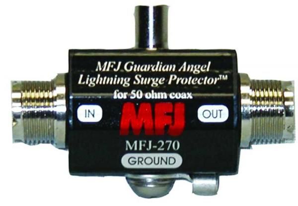

Remember if you live in an area with lightning storms, be sure to use a proper lightning arrester connected to a good earth ground.
AND detach the antenna connection to your radio when not in active use, or during a storm.

And remember to use a lightning arrester where the antenna lead comes into your house.
Connected to a good ground-rod under the arrester.
Or at least always disconnect the external antenna connection 3 feet (1m) away whenever you aren't actively using it.  You could seriously fry your electronics or even burn down your house.  That seems infinitely more important to me.

Yes I will use an isolation switch, as for a lightning arrestor,  I'm not sure its necessary.  Having said that I did have a cb radio wiped out bang, whilst transmitting during a lightning storm.  Bad on my part really.
