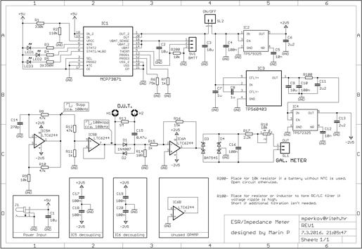

Project was finished long ago, but I was quite busy with college. This semester is lot easier so I will present project now.
Additional informations about project can be found here:
https://www.eevblog.com/forum/beginners/yet-another-esr-meter-project/msg468077/#msg468077
https://www.eevblog.com/forum/eda/pcb-layout-comments-and-suggestions/msg502195/#msg502195
Most of informations can be found in linked topics so I will try to be short.
Schematic:
VPCC resistors are calculated for 5V threshold, because my power adapter can maintain 5V at full load. Some adjustments may be necessary depending of external power source.
Charge current: 1A
Charge termination current around 13mA
Some of used components:

Measurements:

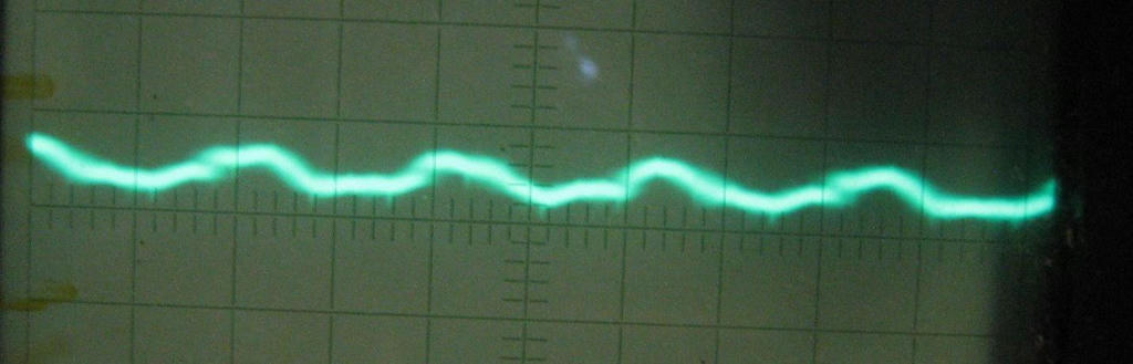

Supply ripple 5mV/DIV, 5us/DIV
Positive
Negative

Offline dannyf
  • Posts: 8221
Re: Analog ESR/Z meter- finished
« Reply #1 on: March 07, 2016, 11:23:09 pm »
Some quick suggestions, based on a project I did that looks quite similar to yours but worked quite differently.
Your output is subject to the diodes non linearity, which can be an issue when high ear shows up. You can solve that but putting the diodes in the feedback loop.
The whole design can be made single rail, siify the design.
You may pick an ohm meter with the right center resistance marking - your meter has reciprocal reading, like most ohm meters.
The oscillator can be made to much like a sin oscillator by adding a capacitor.
For insensitive meters ( over 1ma full scale), a buffer, like emitter follower can be used.
Like yous, my meter is also designed around  a dual opamp: one opamp functions like an oscillator, almost identical to yours.
My second stage is a non-inverting amp, with the dut from the inverting end to ground, and the diodes plus the meter in the feedback loop.
It has excellent range and calibrates very nicely to theoretical levels, as any non linearity is handled by the opamp.
Very compact. As a matter of fact, I build one for a friend Manhattan style on a ne5532.

Offline RiverTownTopic starter
  • Posts: 69
  • Country: hr
« Reply #3 on: March 08, 2016, 10:55:19 am »
Yes, I'm aware that diode nonlinearity has negative influence on measuring high esr. But it helps with measuring low esr values, as is seen from LTspice plot in other topic, and that is more important for me.
Battery voltage was too low for the circuit so I had a choice to use single supply rail and boost converter + one regulator, of voltage inverter and two regulators. At the end I decided to go with option no.2.
Thanks for the tip about adding capacitor to get sine alike signal, that is good advice.
Yes, dropping transformer approach idea was good thing. But thanks for the tips regarding supply of switching transformers, and windings. This can be helpful on some other project.
Offline dannyf
  • Posts: 8221
« Reply #4 on: March 08, 2016, 12:12:55 pm »
"But it helps with measuring low esr values, as is seen from LTspice plot in other topic, and that is more important for me."
I will take a look at that thread but it seems counter intuitive in that a precision rectifier provides the same performance in low ESR cases and better performance at high ESR.
Also, if you want to focus on low res, use a lower value resistor in serial with the dut (10ohm now) - that resistor dictates the center value of your ESR reading. Or you have to recalibrate the meter.
  • Posts: 69
  • Country: hr
« Reply #5 on: March 09, 2016, 05:54:48 pm »
I meant to say that nonlinearity of diodes changes scale deflection vs esr from linear to exponential, which in this case increases resolution on smaller esr values.
Meter is manually calibrated with bunch of 1 ohm 1% resistors. Two of them in parallel to form 0.5 ohm resistor, and then every other in series. That allowed me to draw a scale with 0.5ohm resolution. Not ideal but works for me.
