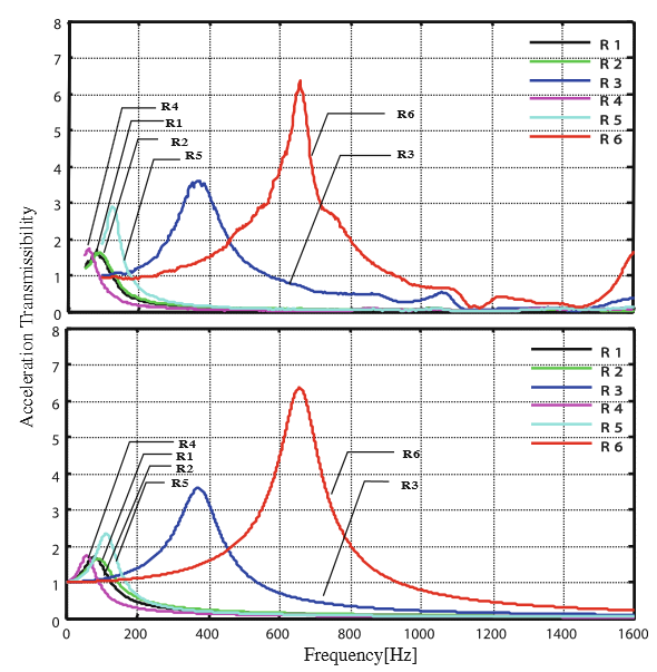

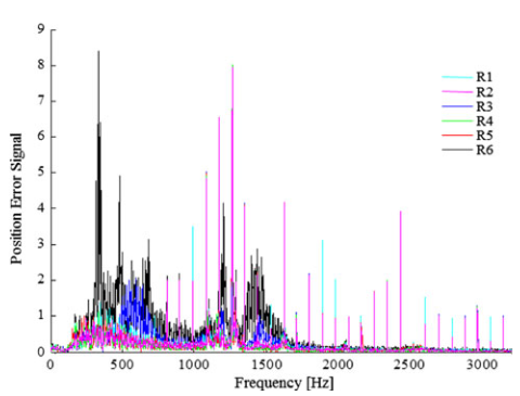

Park, (2012) focuses on dampening solutions for 2.5" (laptop HDD's) with regard to shock and vibration tolerance.  Many papers seemed to focus on one or the other, but Park relates the two.   Park includes a chart of transmissibility using various rubber-based decoupling solutions.  Park also includes a chart relating frequency to the position error signal, which relates read/write errors to amplitude and frequency.  As with the other papers, there was no discussion about which frequencies/factors were most problematic to overall long-term hard drive life.  However, as this was a scientific paper, it was intended to be used more as a reference for people designing relevant devices, so the relevant parameters would vary greatly.  As much as I would like to assume that the PES and long-term failure rate are related, I cannot necessarily support that assumption with this data.  Also, all the data in Park was for 2.5" drives, so I suspect the frequency charts will probably be significantly different for 3.5" drives.
Again, for my purposes, the external forces can be understood and mitigated through isolation.  That leaves issues originating from the drive itself.  The primary sources for these seem to be sinusoidal vibration (platter balance), vibrations from the mechanical head movement, and any resonance issues.
I had a hard time finding information about overall long-term drive reliability.  I found several sources that reference "ideal mounting" of hard drives as being large stationary objects, such as granite slabs (Kelly, (2016)) or ~20kg metal blocks (Suwa (1999). However, I was unable to find why that is used as a standard.  I saw reports referencing it going back into the 90's that I couldn't find live sources of.   Would the conclusions learned from such old technology even still be relevant?
My main concern is that although it reduces measurable vibration, does that necessarily mean the drives will be more reliable?  Could it be that the energy is dissipated into the disk/actuator/head/etc itself, causing stress or strain that eventually reduces lifespan, instead of being safely emitted elsewhere?  I suppose this is where my lack of knowledge of the subject comes in.  Any input would be greatly appreciated!

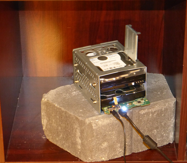

(TL;DR: It worked for recovering data off a failed drive, and (IMO) will likely greatly increase HDD longevity in general.)
No L-brackets were practical for this application (for a few reasons).  I bought a few basic drive expansion trays to try, but none of them were practical for this application.  Ultimately, I took the modular HDD bracket out of an old computer case.  This particular bracket allowed me to drill holes and mount the drives to the brick, AND (crucially) let me mount/unmount drives in the bay while the mount is still attached to the brick.  The brick is a standard landscaping brick, and weighs just over 20lb (~9kg) by itself.  The research papers suggest heavier bricks, but those are a lot less practical.  I made a guess that 20lb would be enough into the diminishing returns area of the spectrum that it would be fine, especially considering that the heaviest standalone commercial enclosure I saw (a 5-bay NAS) was only about 7 lbs total with drives installed.
FYI, I added the old IDE drive in the top slot just for dampening mass- this should reduce the amplitude of vibrations from the top bracket.
Though my goal is to increase drive longevity, data recovery seems like a great way to test the setup.  One of my recently-failed external drives, with a rubber-mounted HDD, had irreplaceable data on it.  That drive would sometimes mount for a few seconds, but would quickly fail and disappear.  This happened independent of factors such as OS.   The research papers claim that vibration eventually leads to off-track read/write errors due to wear and tear of the drive (they lose the ability to properly locate the r/w head).  With that in mind, I hypothesized that solidly adding that mass to that failing drive would allow it to function.  A failure would not necessarily mean anything, though.
I mounted that drive as shown above and it has performed flawlessly after about 100GB transferred.  All the irreplaceable data was recoverable (yay!).  I will continue to transfer the rest of the drive contents to see how it holds up, which will take about 2-3 days).  If that works well, I will try to find some "torture tests" to run on the drive to see how well it handles it.  If anyone has any suggests, please let me know.
Adding the mass seems to help a lot, and would likely add a great deal (logarithmic increase?) to the lifespan to any HDD.  It could be a cheap and accessible tool for data recovery of failed drives (of the most common failure mode)- instead of riskier and more intensive head/platter swaps.
It is also cheap- only a few dollars.  I used a standard drill (not a hammer drill) with a 5/32x4-1/2 carbide masonry bit and 3/16 x 1/4  masonry screws (both Tapcon "red").
I have a few more failed and failing drives- including SMART failures, and drives that just won't mount.  With one SMART failed drive (which was in a dual-bay enclosure), I plan to mount it to the brick, then do a full scan of the drive surface.  I suspect that the drive will not add any more remapped sectors, and that many of the previous remapped sectors will be returned to normal status.  That would strongly support the idea that the vibration from the dual-bay enclosure was the cause of the SMART errors, and the drive itself is actually fine.  If anyone is interested, I can post those results once I test them.
PS: I am aware of the tape mod, but decided not to do it to reduce handling the drive.

Harsh and nasty concrete block on a wooden shelf... :scared:
Anyway, that's a great experiment and a damn impressive result.
After you are done with recovery, it would be nice to try it again in the same setup with and without the brick a few times to see if it really is the brick causing it. Not some random fluke, or the particular USB adapter, PSU, whatever.
And by the way, you could reduce the time to half a day by connecting it to a native SATA port. On my machine, I have a connected SATA cable and SATA power cable hidden behind one of the 5.25" bay panels, I just remove the panel and hotplug a disk when I need it.
