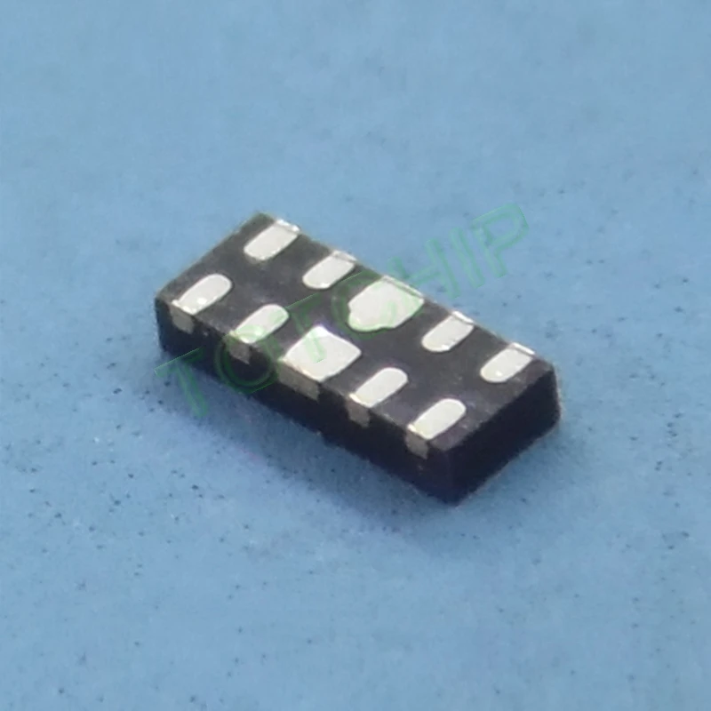

Hello everyone,
I'm looking for a part number and name/type of package.
Thanks,
Rob

Hey Rob, If you take photos of the part under different angles and lighting, we can see sharper text. Also, if you tell us what the device is, it will be easier to classify it in the component ecosystem.

package is looking like DFN-2510-10
mostly used in esd protection diodes (?)(not sure)
Is it positioned close to the I/O of the pcb ? For example HDMI or HDMI,
DisplayPort, eSATA and LVDS or usb

Hello electronx.
Yes, it's located near the component input/output.
I don't have the pcb on my desk to take a better picture but this info is enough to replace this component.

Vrwm should be above maximum operating voltage
please pay attention to the operating voltage of the relevant input output unit.
also don't forget to evaluate the emc factors.
i found something like this for h series but i'm not sure if it's the same manufacturer
regards
