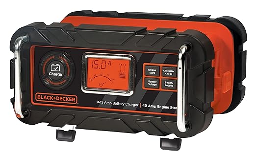

reviving an old thread; maybe for a new purpose.
I recently had a dead car battery and wanted to see if I could charge it to save the cost of yet another replacement (just had it replaced 2 years ago, maybe 3 at the most).  I can't believe my batt is bad already.  car is vw passat (2003) 6-cyl.
so, for now, I bought a battery charger from a local auto parts store.  this one:
http://www.amazon.com/gp/product/B00KNMKRU8
and it does seem to work, at least at first trial.  I'll have to see if the batt is not able to KEEP a charge, as I condition it, but a half day's charge on it seemed to allow the car to start when I tried it.
what I'm wondering is: how much 'magic' is there in boxes like this?  I've read quite a few user reports of these boxes failing over time and while it might be the usual lytic caps that die, I have not opened the box yet so I don't know if there are other bad designs issues inside or not.
I'm curious if I can build my own that does all that this one does.  for extra features, I'd like some wireless notifications to be sent in to my house so that, when it changes state, I can know about it.  similarly, since I need to leave this connected to my car overnight and I can't lock my car inside, I would also like to have some kind of alarm on the unit so that I can be notified if the connection breaks, for any reason.  and while I'm at it, might as well build in all kinds of safety features, so that nothing bad happens.
anyone have any ideas on where to start?  I might open the unit later on and see if its worth adding things to the box as it is, or maybe I should start over from scratch.
I know there are constant current modes and constant voltage.  I don't THINK that charging lead acid is as hard/complicated as, say, li-poly.  and since I never want to have a discharge feature, the charger should be somewhat simple to design and build.
so, curious what people think about the idea.  either modify an existing platform and add some safety stuff and wireless notifications - or start from scratch.
the idea of unattended chargers connected to my car scares me a little and I really don't trust china, these days, to make power based electronics with safety in mind...
